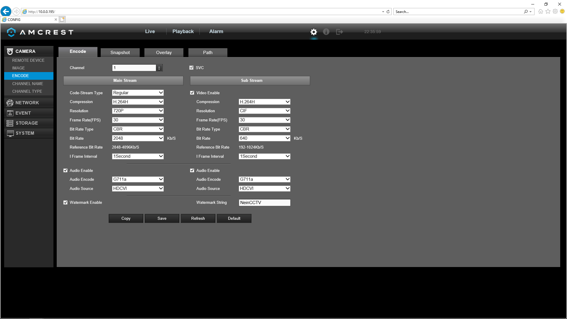

Thanks again - this is very helpful! - I could not tell from the specs that there was any difference in audio capabilities between the 7108 and 7208 so I'm glad I double checked.Revo2Maxx wrote: ↑Sun Apr 23, 2023 8:35 pm So to answer your PS. I am sorry I was wrong. The DVR is not only Audio over Coax but is also PTZ over coax as well. I have a 720P PTZ Dahua camera CVI that I connected and sure enough I was able to enable audio from the camera.
However the issue is finding a Camera that will work with your DVR that offers Audio over Coax to start with. Newer camera all over the place older ones not so much. I am sure there are some out there..
About Stats between the DVR's the 7108 is a 8mp and the 5m08 is a 5mp and the cost between the 2 is more then plenty for most people to buy the 5mp one. Had it been offered when I got the 7108 I would have bought the 5m16 over the 7108.. Also while I am happy enough with the 7108 had I known and data offered when I bought it as it is now I would have bought the 5116 over the 7108 because of the FPS is only thing different really and I dont' have any 8mp Analog cameras and thought the 15 was related to the ones I had already that was only 5mp and lower.. So yeah besides that I have my 8m16-H5 to take up the slack..
This is nice because I can replace a couple of my current cameras with audio capable ones. I am thinking I will pickup a separate 4 channel that will suit the specific needs of viewing cars being pulled in and out of the shop. Those may not even end up with audio. But I digress....

Ok sorry, First What I was talking about is the ability to find a Camera that would work with your current DVR.. Like I said the one that I connected to my OLDER like your 7208 however is my 7204. So with it same Model type as yours then yes it would work with Audio Over Coax. So what I meant was OLDER camera (Even if bought NEW) that would work with our 72xx models. However if you look at your camera even if it is a 5mp it might have the ability to work as a 720p however in most cases it would be only able to go down to 1080P. Like most of my 5mp they will only go down to 1080P. So yes newer cameras todays tech that would offer Mic or Audio in/out that is Analog will work with the newer higher MP DVR's

About the camera, Looks like a great camera. The semi good news is that it should work with your DVR however there is 1 slight issue. Setting the camera to CVBS aka 960h. This will work or should work on your DVR however on one of my 2mp cameras that has Audio UTC it only works in 2mp mode. If I connect to the 960h output the Audio don't work because in a sense the camera is no longer in HD mode so the audio don't work. Now please note I am not perfect and I am human and I make Mistakes and happy to call out my own mistakes when I find like when I thought our 72xx DVR was not UTC audio.. In the case of the Amcrest camera the Audio might still work even once setup for CVBS to work with the 720P DVR.. But really you will be much happier with a newer DVR no less then the AMDV8Mxx-H5 However for the money AMDV5Mxx is AI and while only work up 5mp cameras. So 5108, 5116 or 7108 if you will one day want to upgrade to a 8mp camera and want AI. From what I see I would be happy with the AMDV5Mxx AI DVR if I was buying today..
Re: How do I get audio?
So now I remember why I wasn't to thrilled about my 7204. It is said to work with CVBS and or 960h and I just tried to connect one of my Amcrest 960h cameras to it and nothing ever comes to life. I know the camera still works because I can connect to my 8M16-H5 DVR and it works just fine.. So I tried a few other cameras that didn't work. While they were not Amcrest it might be different with Amcrest CVBS cameras. So keep that in mind buying a 5mp camera like the one you listed above, It might not work on your current DVR
