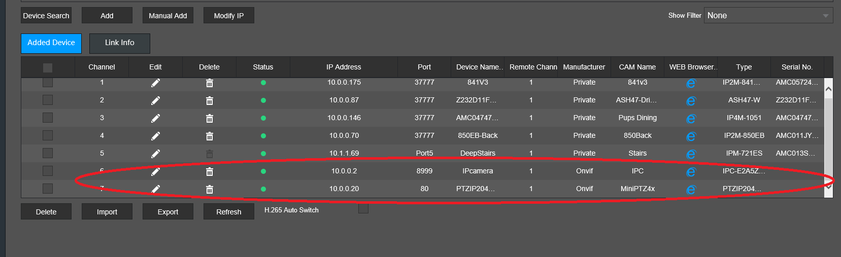

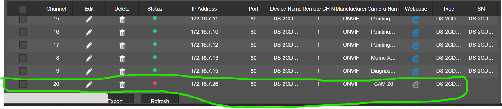

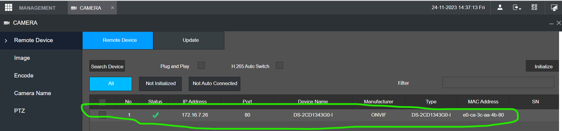

Today I need to add more Hikvision cameras to the NVR. I followed the same step I did months ago, to my surprise, I can't get the new hackvision cameras added to the amcrest NVR for recording. Now here is my exact problem: In the Amcrest NVR, I am able to search for the camera as seeing in screenshot 1. I am able to add the camera as seeing in screeshot 2. Once the camera is added. I look on the screen attached to the NVR, screeshot 3 shows the details, at this stage all i did when I firs added the 19 cameras, is to put the NVR password to allow access to the camera for recording. This time I am using the same password as usual and nothing happening. I ahave confirm that the password is working well.

I would Trash can that one on 20 and try to add it back again. At times I found for my systems anyway that if I try to add a camera and I get stuck on the Status staying red, if I happen to remove that and do another search or Manual add back the camera I get the camera to come up as expected.
Also with Hikvision as I am sure you already know seeing you have more then a few, The camera needs to be setup with ONVIF turned on and in some cases and some FW will require a ONVIF User to be added. Not always but in some cases. Knowing that you have others already added only thing that I can think of is that the ONVIF user is needed in the FW that your camera is running. I have some that require and some that done in my setup. So something to look at. If that is the issue the camera will look like it is being added however seeing the system isn't active with a good ONVIF user it will never go Green. Something to look over.
