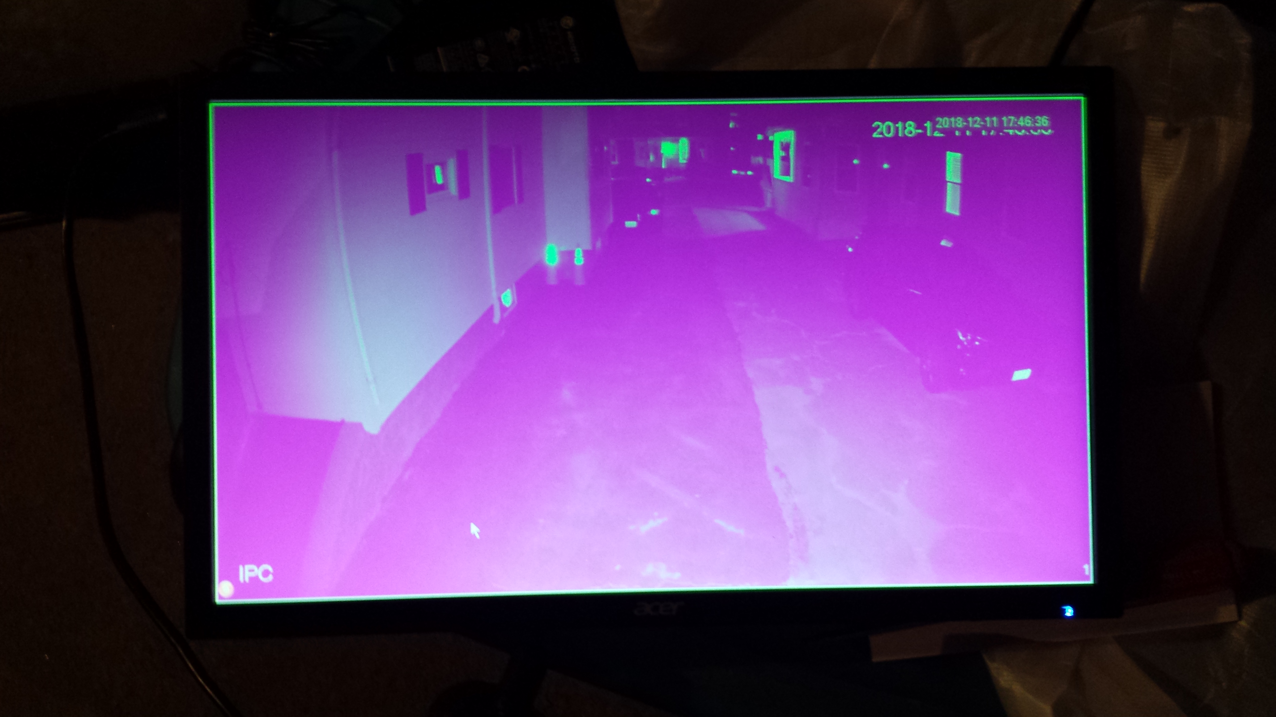

Hi, new here. I just bought a 4 channel 2MP POE system and am still installing it. So far I'me very impressed with the image quality, day and night. My system, maybe them all, has HDMI and VGA out puts and I just bought a new HD monitor to use with it but it has DVI and VGA inputs only so I also bought a HDMI to DVI adapter cable. I use a similar setup on my home computer. Strangely the Amcrest system, mine at least doesn't appear to work properly with this configuration, the image is tinted and washed.

I confirmed that it worked with VGA, at least the coloring not the resolution though. I tested the monitor on another computer with two different cable and it worked fine while the Amcrest DVR with two different adapters yielded the same result.

I then tried my computer monitor which has VGA, DVI and HDMI inputs. It failed to detect any signal at all with the adapter cable(s) but HDMI to HDMI worked perfectly.

Are there any known issues with the HDMI ports on the DVRs, do I have a bad one or is there a firmware upgrade available before I have to start shopping and returning monitors?

Right, that would be the logical choice. However, I'd still like to know why the DVI adapter works for most HDMI devices I've seen except this one and also is it exclusive to my unit or all of them.
In the interim I've connected it with the VGA port and reset the resolution to 1920x1080. The image is adequate.

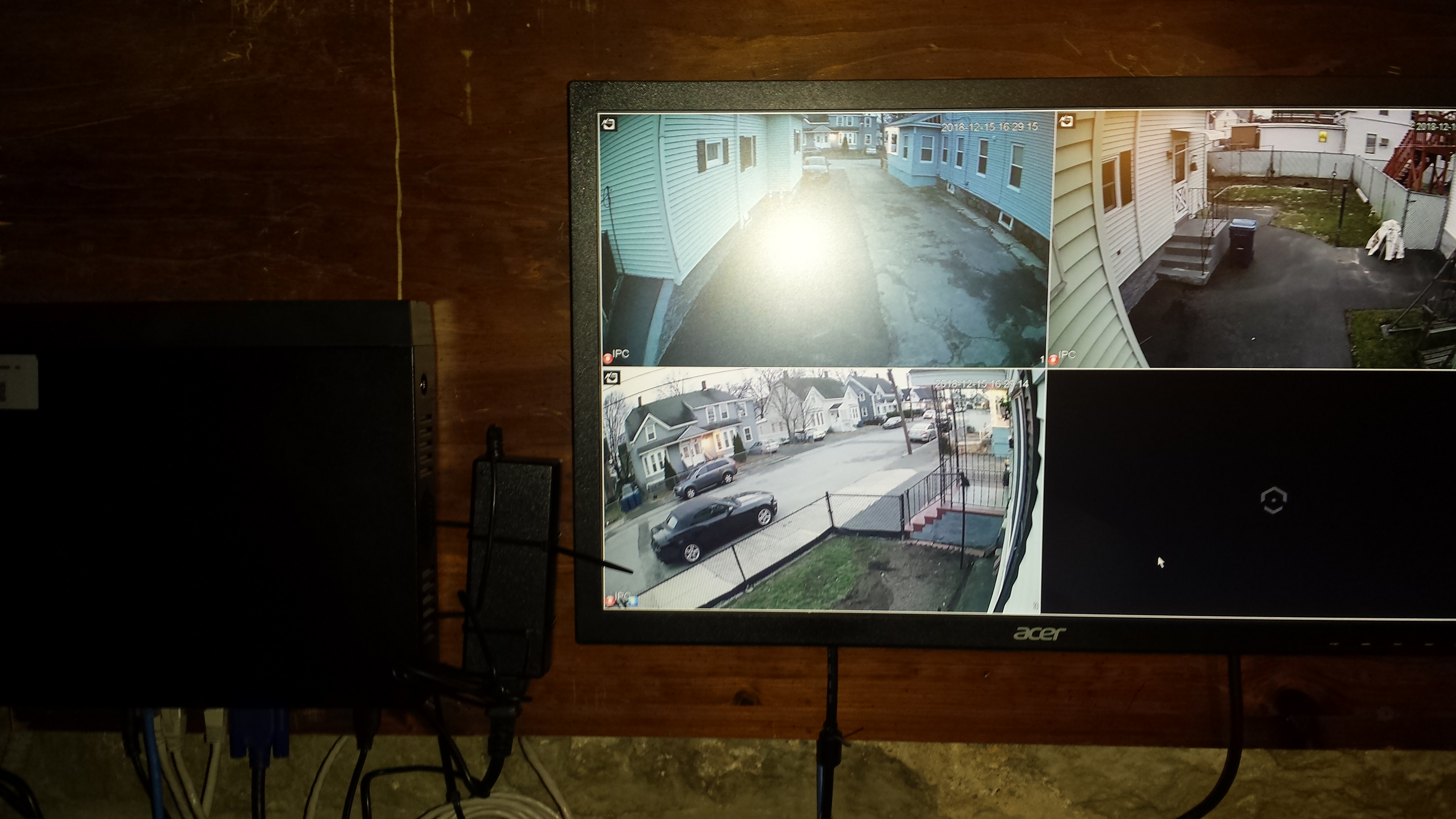

I tweaked the monitor a little and tried to get a better angle. The view is a lot better than the picture shows. It will be easier when the mount I ordered for it arrives. There is a tech assigned to my issue now and once he gets the info from me he needs we can start addressing the DVI issue. Can't understand why it shouldn't work.

The video traffic on DVI and HDMI is the same, there should be no issues. You will likely find that the monitor itself is using the wrong colour space. It should have a setting in the DVI port setup to select between YUV mode (or component, or Video) and RGB mode (or PC). Try them both, one will work.
You may even have the same options on the HDMI output setup of the NVR although this is less likely.

The issue as I previously stated is now moot but for clarity the problem lies with the NVR output, whatever it is. The monitors work issue free using HDMI to DVI adapters on other devices but consistently failed on the Amcrest. Thank you though for the continued interest.
