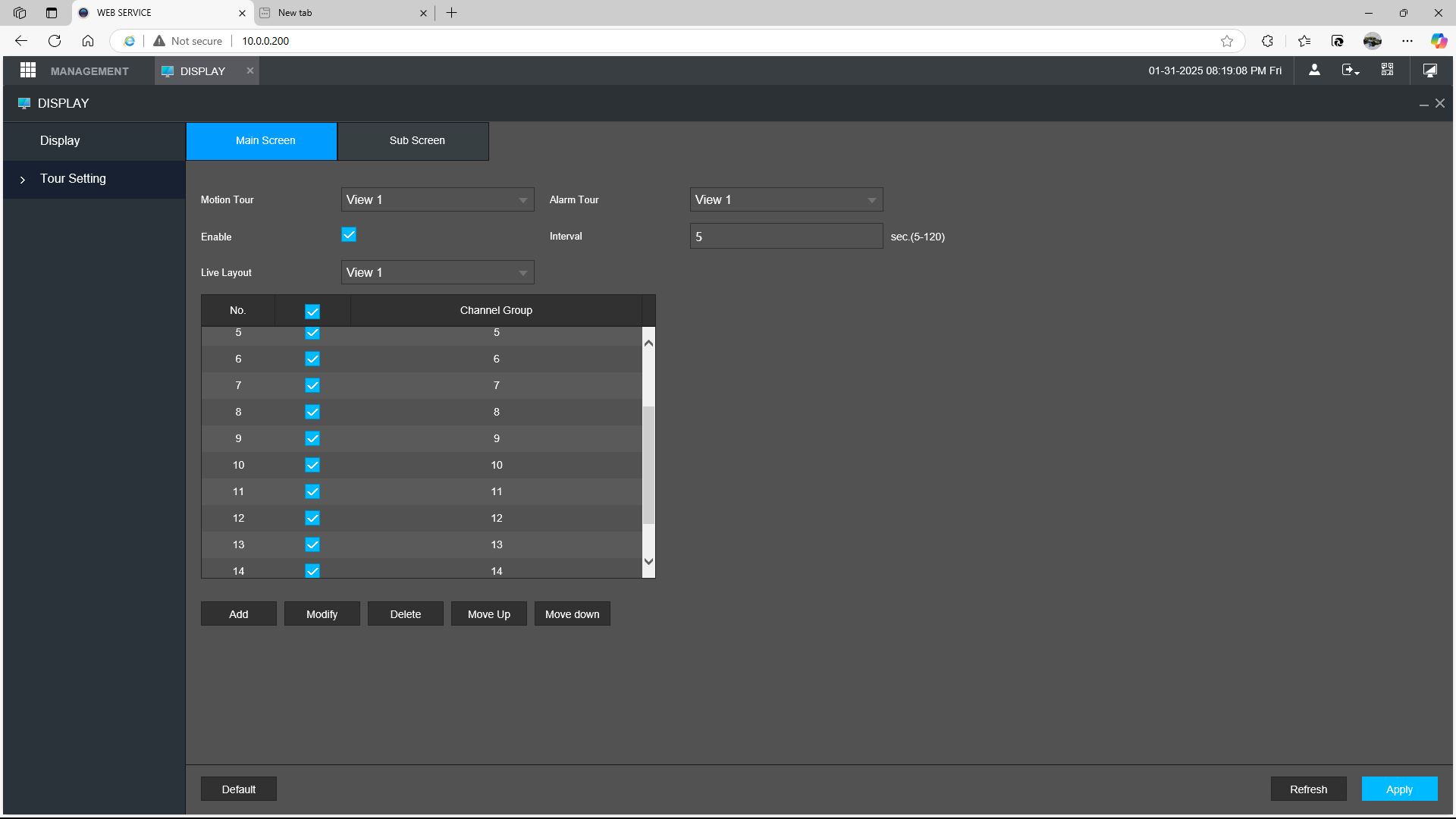

Re: Having trouble getting rid of multicam in tour AMDV5M8
Ok so if you want the DVR to cycle each channel even after a reboot I would have to look into that.. I know I do everything I can not to scan all my channels because I don't like the idea of something happening in between the time it takes to go from 1 camera to the next and back to the camera that might have an event..
So anyway I revisited the tour and I am not sure how you are doing it. I just setup mine to tour all my channels on my 16ch NVR. While i have not changed my NVR back from locking out 9-16 when it wasn't logged in and sure enough after a did a reboot after setting up my NVR to tour the NVR started to tour again after reboot and when it made it to channel 9-16 they just toured with a black screen and lock but recorder did in fact tour after a reboot.. Did you do a manual tour or did you enable the tour in the tour menu?
So I am clear, When my system rebooted it loaded with 9ch grid view to start with, then after a couple of seconds started the tour.. I was thinking at first maybe it needed to be logged in to tour but no started with it even after a reboot..

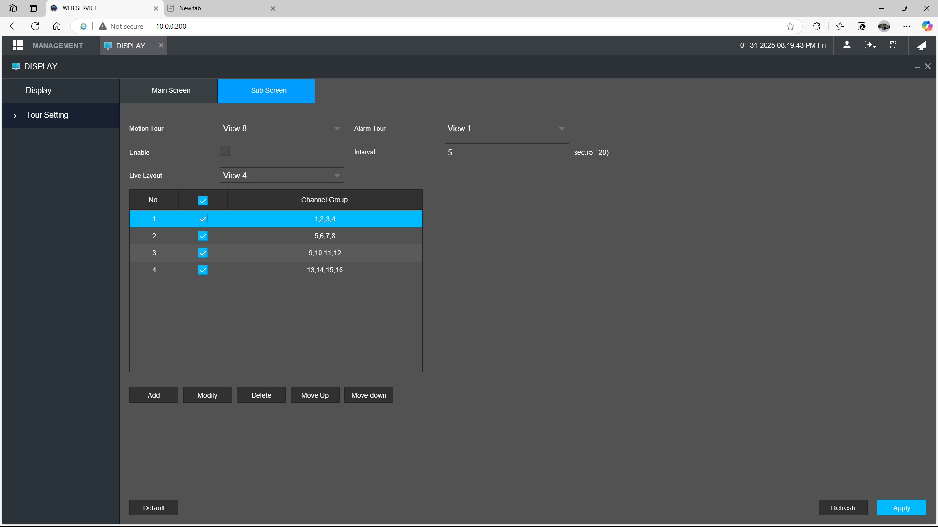

Now in my pictures below you can see that tour was enabled for main screen. I also have Sub screne tour that I can setup that I didn't remove any of the info and can do 2 different tours on my device if I wanted... If your machine has both main and sub make sure you setup for the right tour group.
