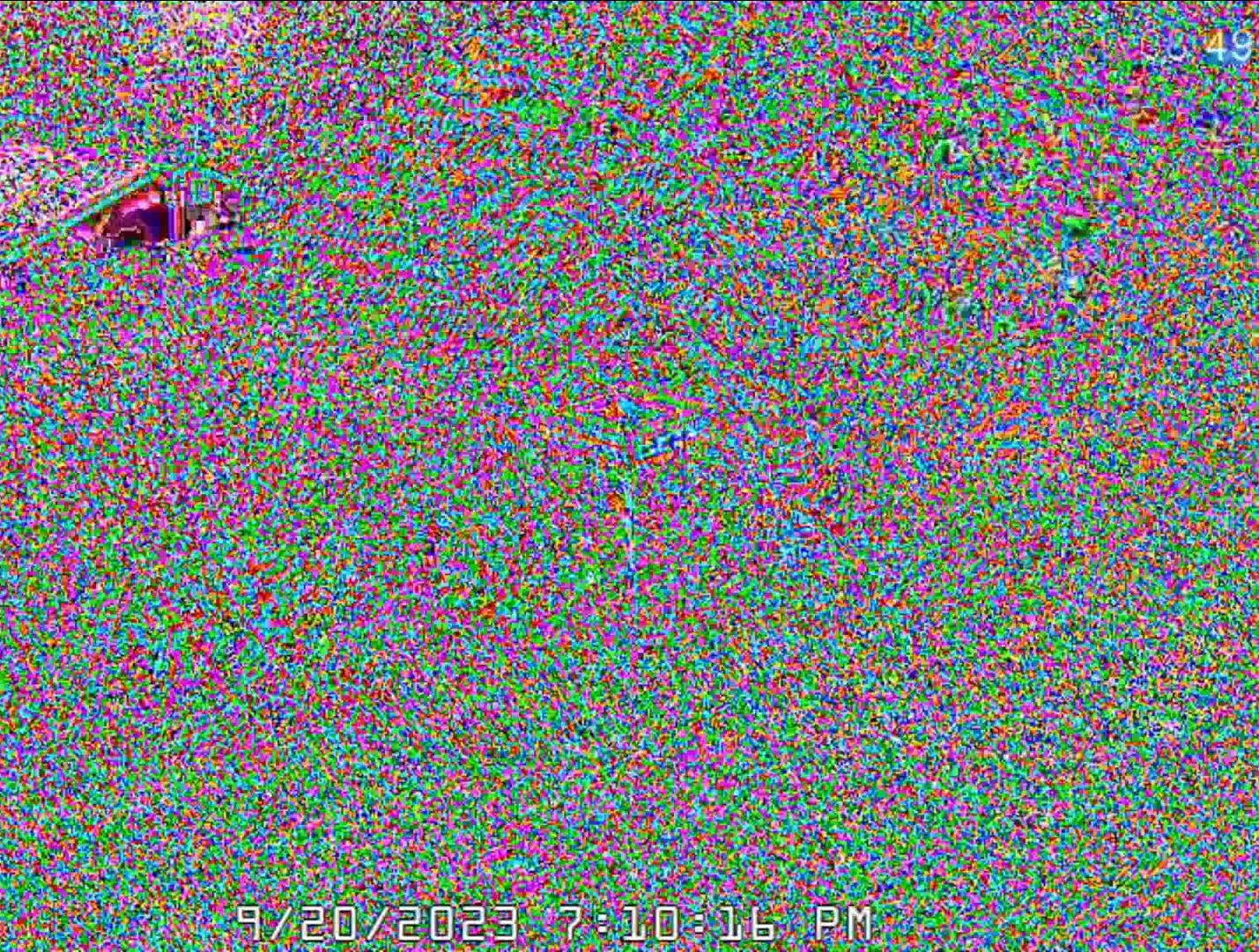

However from what it sounds like is an issue that I have had with a few h.265 cameras that seems to not always, however at some point in time the screen will go green and in some cases you can make out the scape and in others it is just pure green. I change to h.264h if the camera offers that and if it don't then I change to h.264 and the issue is gone. The Picture below is from a OEM Hikvision that came setup from factory with H.265 enabled for main and h.264 for the sub channel. It only took a day or 2 before one of the motion events or might have been a live view even that I took the screenshot. In this picture you can kind of make out the roof line of a house about 90 feet from them camera. This was a mix like the old TV at night that would go off air and the static. However the ones I get from Amcrest or Dahua is pure green smooth and some can make out and others can't make anything out in the picture.
This screen shot was taken from my App in Blue Iris. You can kind of make out the Birdfeeder in the center of the picture that is mounted on a pole However I have had other cameras with an event show part or all of the event in green and sometimes only part of it like it was having an issue with CPU demand on the camera.

Compression artifacts.

I'm still leaning toward a Layer 1 issue impeding the Layer 2 data transmission quality required for the H265 format -- especially given the glaring clue that switching to H264 eliminates the problem.
Additional information would help minimize the guessing. Here are a few things to consider and to possibly investigate further.
- Are any of the proprietary 'Smart Codec' or '+' suffixes being used for the H265 encoding? Are both Main and Sub streams the same encoding format?
- Are appropriate bit rates for H265 implemented in the affected camera's configurations for their area of interest and do the camera and NVR configurations match each other?
- Are you connecting and powering directly via the various NVRs or using external POE and/or switches..., or a combination of both?
- What are the physical distances to the problem devices? Could they be right on the edge of their powering requirements and or the limitations of the powering sources -- and have you calculated that on a case by case basis with reference to the published POE specs for the given power source?
- If using external switches, are the ports set to a fixed rate, or auto-detect?
- How do they perform at night with either type of encoding?
Speaking in strictly practical terms and breaking it down to sheer basics, H265 is the problem with your images/streams. Why that is requires investigating most, if not all, of the above in each individual case where the problem exists. Bear in mind that not all areas of interest will respond to H265 the same even when using the same model of camera with the same exact settings, though the discrepencies would not likely appear as severely as illustrated in you screenshot.
So my take is a physical issue causing a data problem or a configuration issue that is taking H265 tolerances for its optimum performance well beyond its limits -- or the processing power and resolution capabilities of the system(s) involved aren't quite as capable as believed and are simply
being exceeded. All of the above can be methodically approached for the respective affect(s) each may have on the individual H265 related issues.
