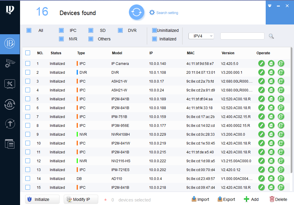

So for others and the IP here is a picture of some of my devices on this part of the network and there are a few that don't load in this list for some odd reason anyway I slice it So for finding the IP for them I use ARP in dos once added to my router table then I can add to my NVR or DVR aka HVR
