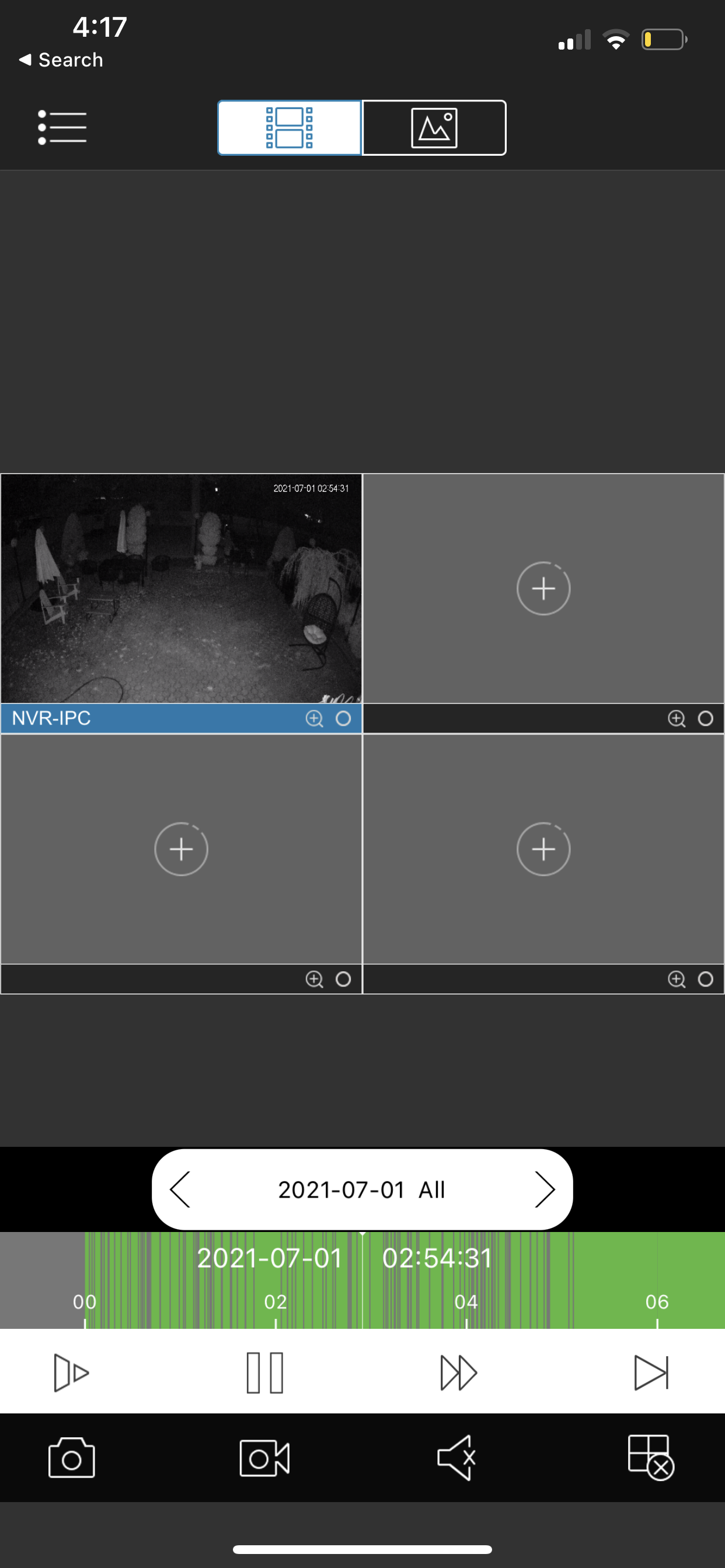

Hi all,
I have an NVR connected to a wireless router, with four cameras (3x ASH42, and 1x AD110 doorbell) connected via 2.4Ghz.
The recording has intermittent gaps. See attached screenshot.

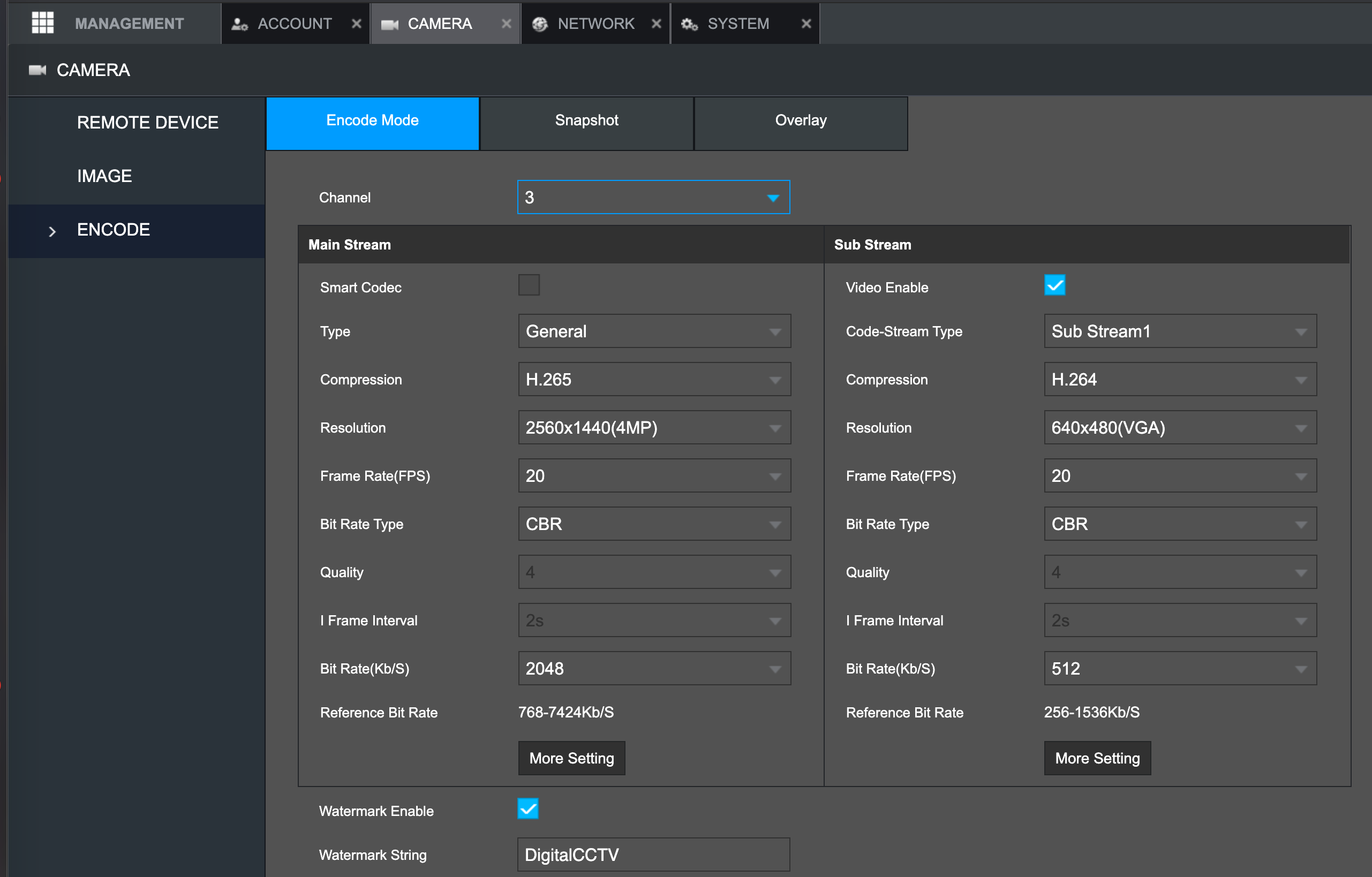

Encoding settings are factory-default (also attaching screenshot of these).

Is this an inherent issue of connecting these devices via WiFi? If so, is there a way around this (adjusting encoding parameters or maybe improving buffering)? I am REALLY dreading taking this all down and shipping it all back :(
Edit: All devices are on latest FW, including the NVR. The routers I tried are Synology RT2600ac and a TP-Link AC1750

There may be some 2.4 Ghz interference occuring before about 5 am.
To help analyze what it might be, you could use android apps like WiFi Analyzer and Net Analyzer.
