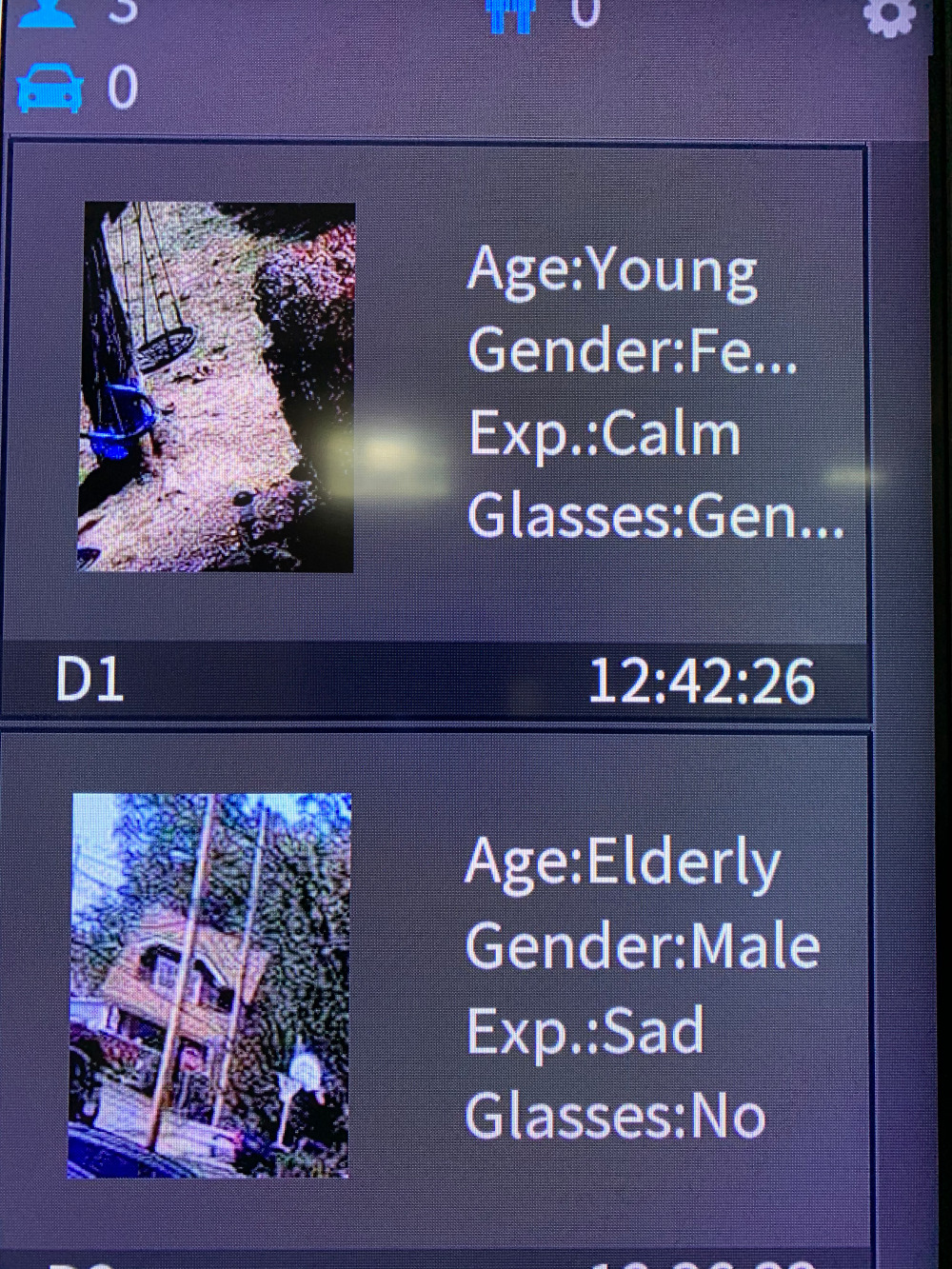

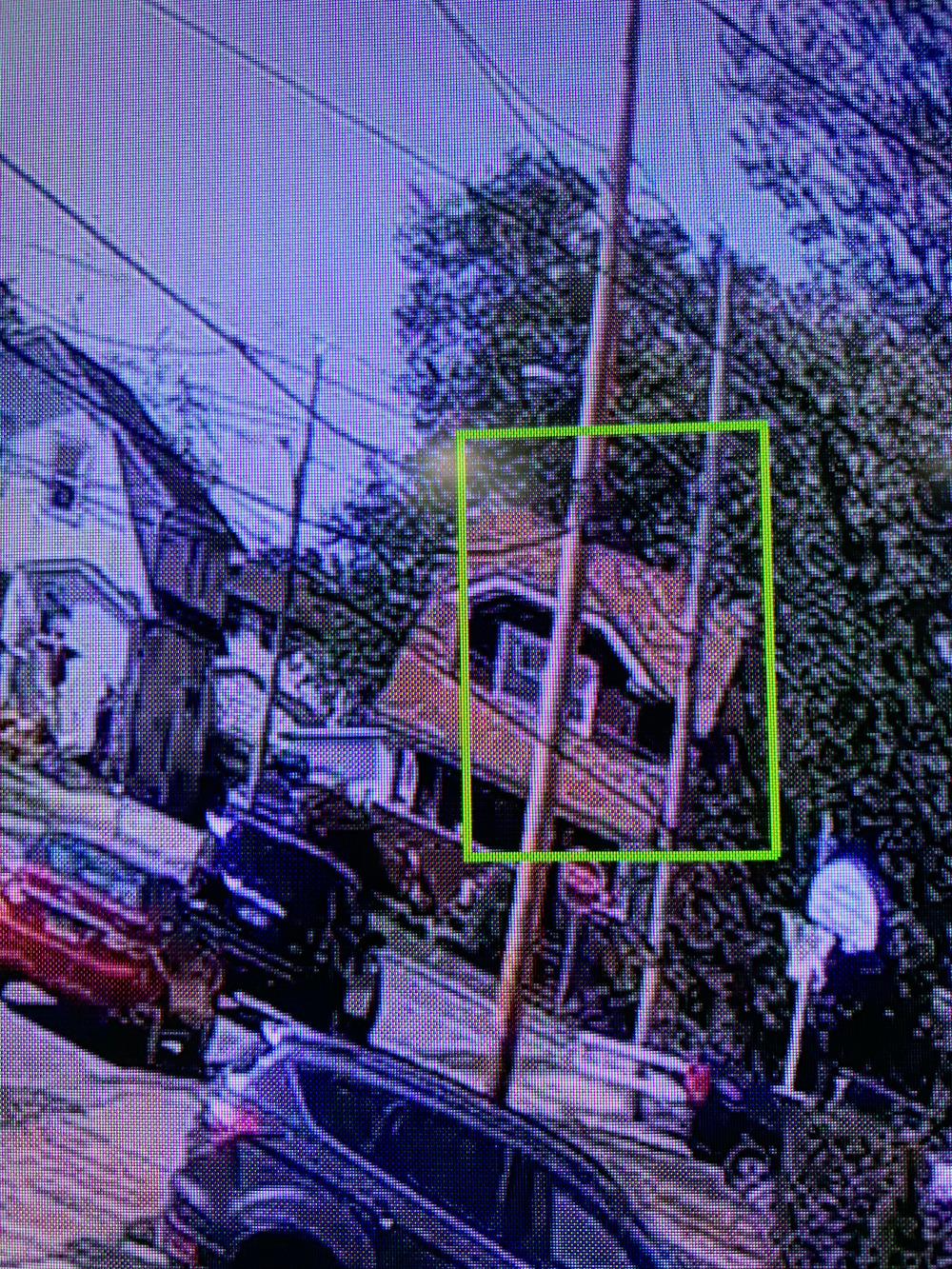

So after playing with face detection for a few weeks it is pretty much unusable as it becomes filled with "face detections" of a house in the distance... I have tried every possible combination of min/max size to eliminate the issue and even with an max size smaller than what it is detecting... it is still detecting the house on one camera, and a tree with a swing on another... Anyone had similar issues that they were able to resolve? It would be ideal if I could mask off those areas for face detection but there doesn't seem to be any ability to do that.

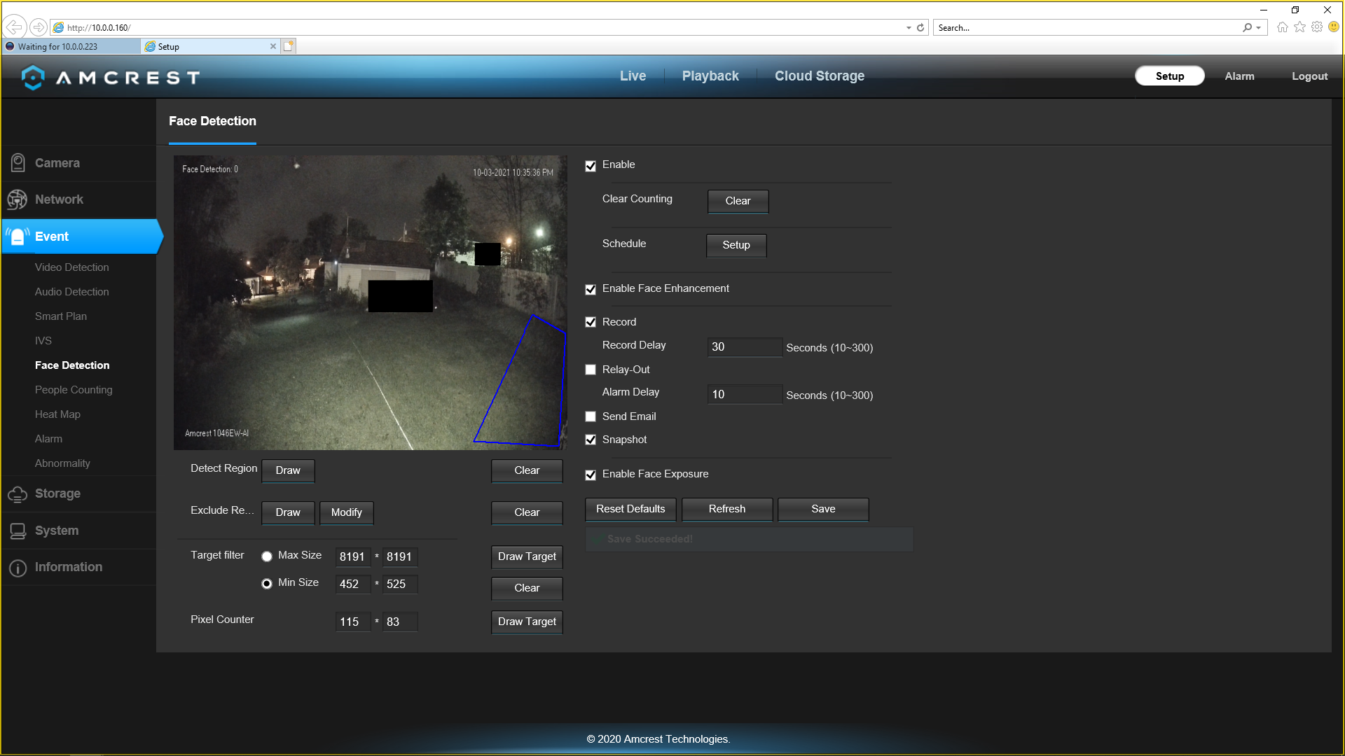

So was doing some looking around about setting up 1046EW-AI, it does have Face Detection and also has IVS.. I own this camera myself buying after I wrote my first post here and found out that I too had the same issue when I setup for Face Detection before finding some areas for configuration..jack7 wrote: ↑Sun Sep 27, 2020 9:42 pm The Amcrest AI camera, IP4M-1046EW-AI, does not have face detection capability. No IVS rule available. Face detection is not mentioned in it's user manual and technical specifications.
@bryeartem, I suppose you could set up privacy masking in your camera that could do the same thing as the face detection blocked areas you propose. But then you would not see the privacy areas in your image.
Please note When you want to setup Face Detection you will want to setup in the camera, If your using your Camera on your NVR POE port, (Also now own the 4216E-AI NVR) you can get to your cameras Configuration page from the WebUI for the NVR. I Prefer IE and both the camera and NVR still work in the IE format until it is no longer able to be used that is what I will use..
Either way, Even in Chrome, click on the Management in the Top left of the Window, Then click on the Camera, Then in lower box of your installed cameras, scroll down till you get to your camera that is on your NVR's POE port, click the e that is showing on the right side of the widow area for the camera, then it will bring up a camera IP and port number for your camera (Port not always the same) Your log in will come online put in the user and pass, then in the camera, click on Setup, Then on the left click on Event, then Face Detection, then the box will come up with your camera view, you will want to click on the Detect and Exclude Region and in there you will be able to Draw in areas for where you want and don't want it to detect!
Also please note that in the area your showing @bryeartem might be outside of the DORI for the camera.. I don't have that data in front of me right this min but I think it is only 20 or 30 feet and I know that mine works best at upto 40 feet but is outside of the data for working the best... I would also Enable Face Exposure and Face Enhancement and or try it both with it on and off to see what is best for your needs...
One with Yellow box is for the area to Detect faces and the ones with the blue box is to show how it might look to setup an exclude area..
