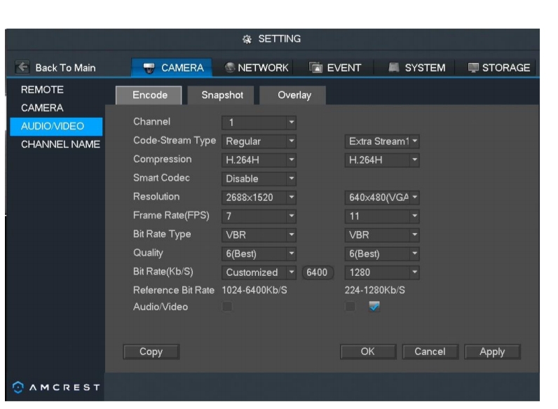

I found this in a manual.
Perhaps someone can tell me witch settings I need to change on each camera to get the bitestream down. This is just a sample in the manual.
- 20191217_205730.jpg (150.53 KiB) Viewed 1937 times

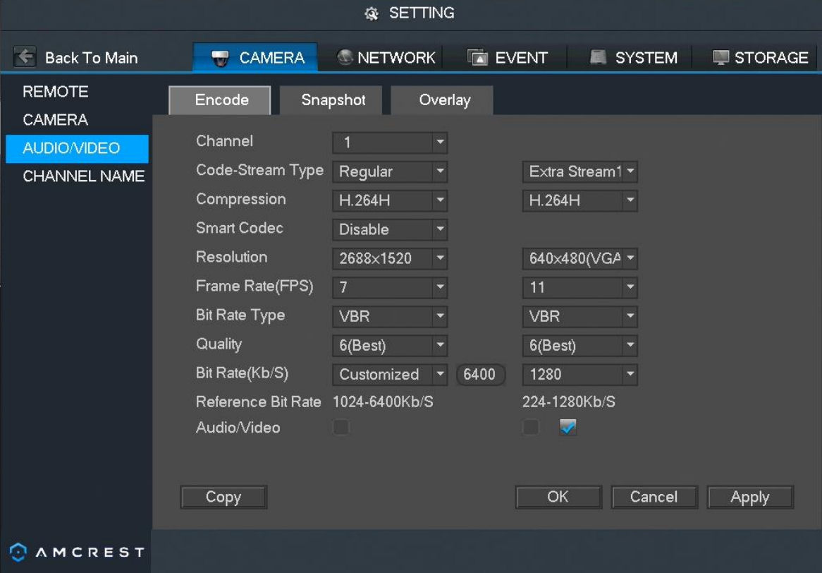

Then for how to get to your area of encoding...
bring up the menu, then Settings, camera Video/Audio is where you can find the settings...

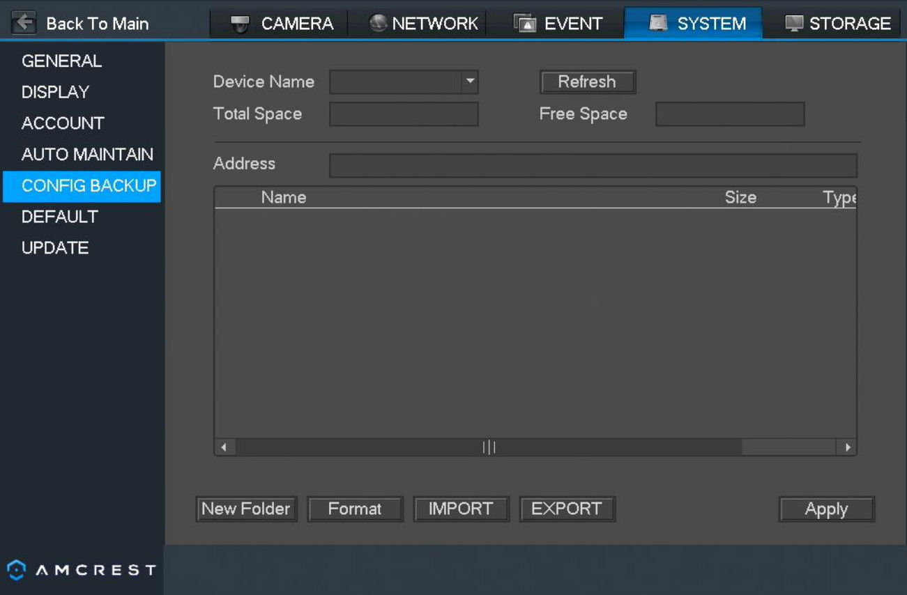

Please note this isn't 100% of what the Problem is. I would say if you have a Thumb Drive I would save your settings you have now before you make changes incase you want to go back as it is now... To get there you would bring up menu, settings, system, Configuration Backup..
Provided 2 pictures of what the menus in question would look like...
The encoding area The Backup area

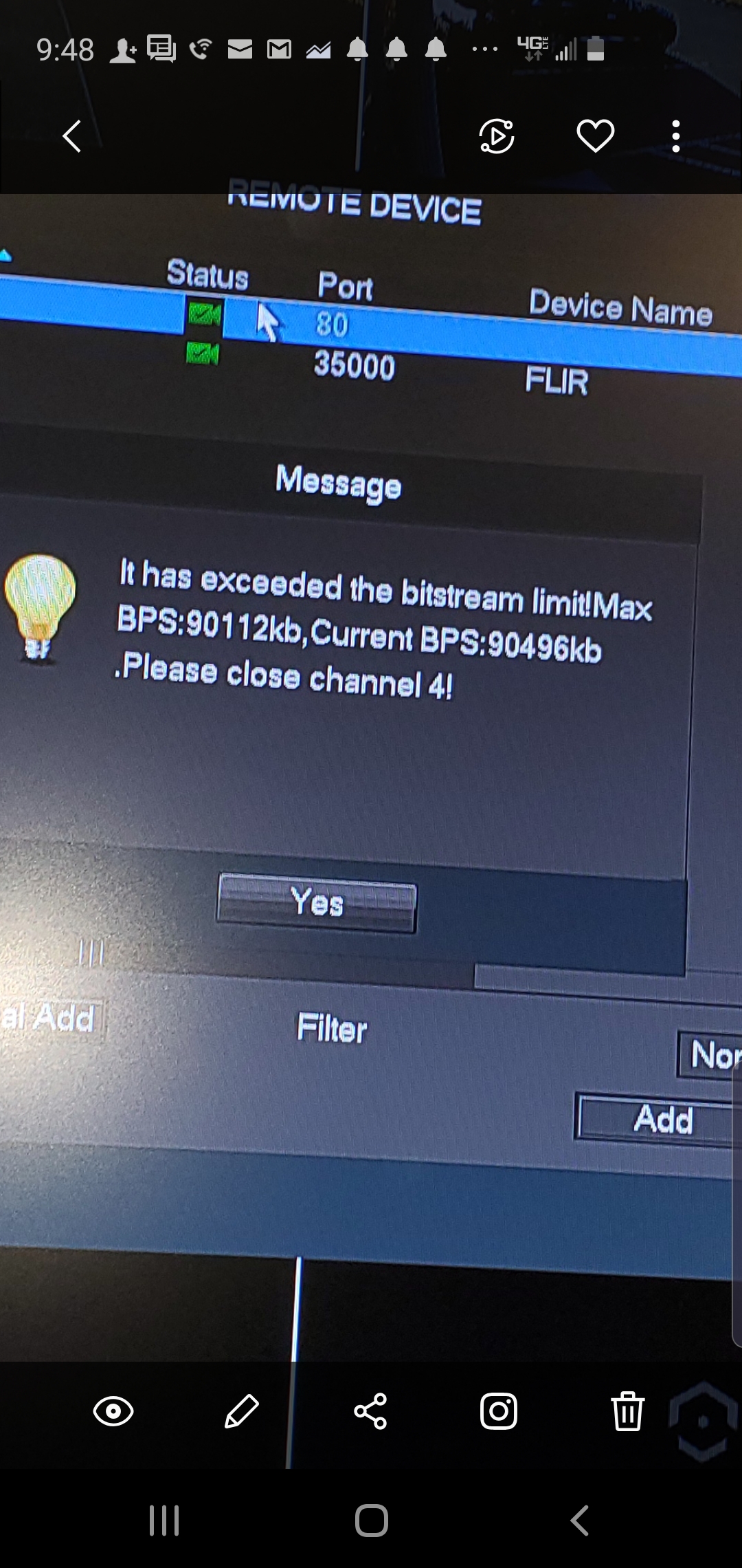

Re: Exceeding bitestream
Thanks, I think I am just over a little.
This is what pops up.
- Screenshot_20191217-214841_Gallery.jpg (1.14 MiB) Viewed 1932 times

Sadly I am not sure. I would maybe contact Amcrest over Email or maybe even call them and see if they could assist you with this. I am going to guess that you might be able to trim down the Quality if say you have them all set to 6(best) I am not sure what you are running your cameras at. But seems like a 16ch NVR should be able to run more then 8 cameras. However looking at the Pictures I provided. THey have them set at 7fps so I don't know where yours are set...

Your NVR has a record rate of 80Mbps. See
https://drive.google.com/open?id=1mci1X ... HFfUaW3bJR
Don't know why it currently says it's 90. Maybe 80 is a conservative number.
One simple thing to change is 4K camera setting H.264 compression to H.265 to reduce bit rate, and see what happens. Doubt you can do that on FLIR.
If that doesn't do it, you will need to explore other 4K cam and FLIR cam settings to further reduce bit rate, and retain video streams that are acceptable.
