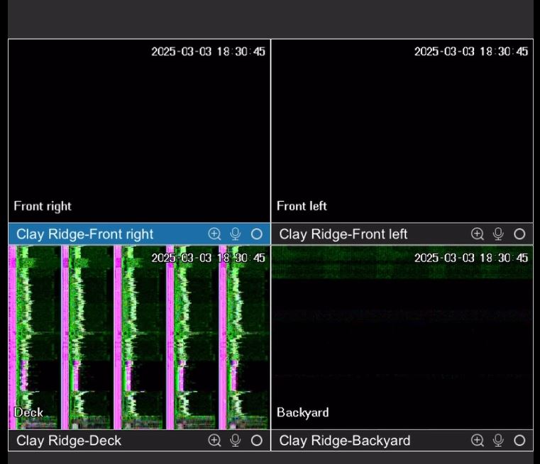

Tested your theory, I disconnected the hard drive and rebooted the system. I got the missing HDD alarm but it still would not support more than 2 cameras. It still did not make a difference which 2 cameras I connected or which coax port I used on the DVR. 2 cameras work fine, connect a third and it fails.
I am starting to think its a MB issue? I have tried to go through the posts and I don't see anything addressing this. I have added a screengrab of what I get with 4 cameras connected. each camera shows this colors randomly the whole time on both the app or the monitor.

Factory reset made no difference. I had even saved the congif in order to restore, but I ended up doing a complete new set up - I am still only left with 2 cameras.
I also looked back at daytime footage from today and there are periods this afternoon where the recording was glitching like the previous screenshot. I think maybe something happened to the motherboard or some other piece of hardware. I wonder where I can get a replacement for reasonable cost, I think this exact dvr model is discontinued.
