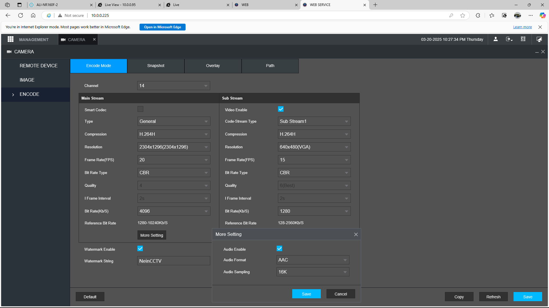

I login to the NVR 4108. I click on "Management" at the upper left, then I click on "Camera", then I click on "Encode". Audio Enable is checked. Audio format is "AAC". Both Mainstream and Sub Stream. BUT, no sound is being recorded.

IF POE connected camera, make sure you are using IE or IE mode in Edge, Click on the camera page, THen the e for the camera in question. If you do this in Chrome or Edge normal make sure you pick the wrong POE camera first because it will give you a connection error. Anyway log into the camera and double check that the camera is enabled for audio. Shouldn't have to be sounds like your camera might need to.. Then in the Cameras WebUI page for live view check that it works in the cameras own live view if there is on audio confirm that the camera has a MIC or one installed and has power to it if external Mic..
Screenshot (187).png (90.28 KiB) Viewed 4759 times
