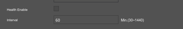

I have configured my NV4116-HS for email notifications and set the interval on the configuration page as 60 which indicates it should be only one notification every 60 minutes. However, this morning I received over 100 messages sent every 5-10 seconds for motion. I'm trying to limit the number of messages so that I'm not inundated while I'm testing my configuration. Am I using the correct setting for this?
Screenshot 2022-05-05 at 11-28-20 WEB SERVICE.png (6.51 KiB) Viewed 347 times

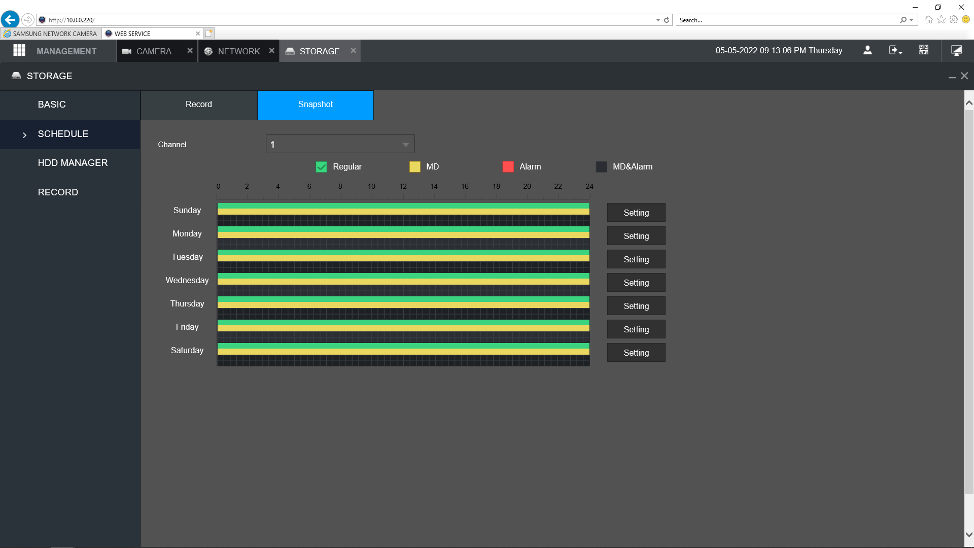

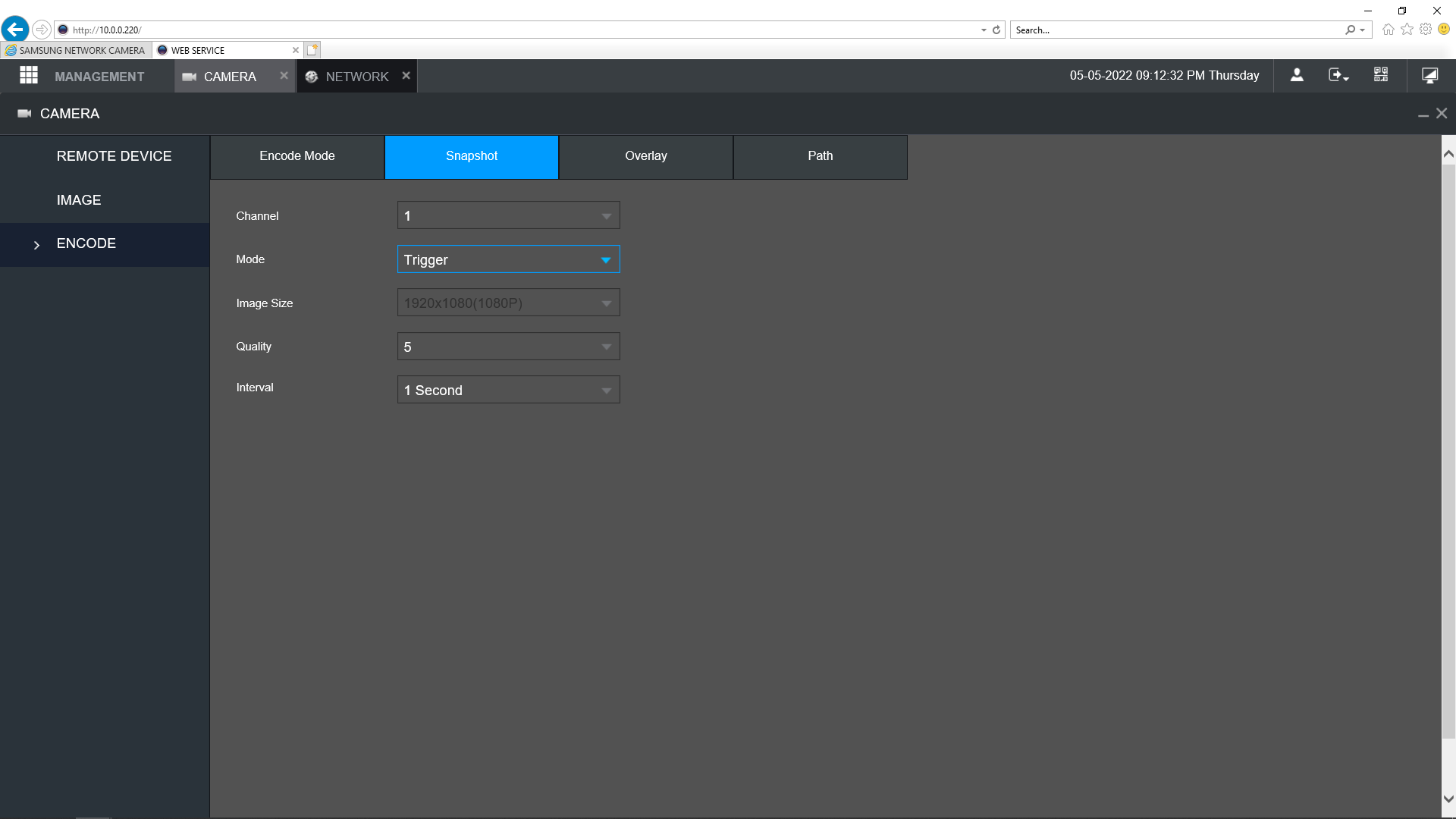

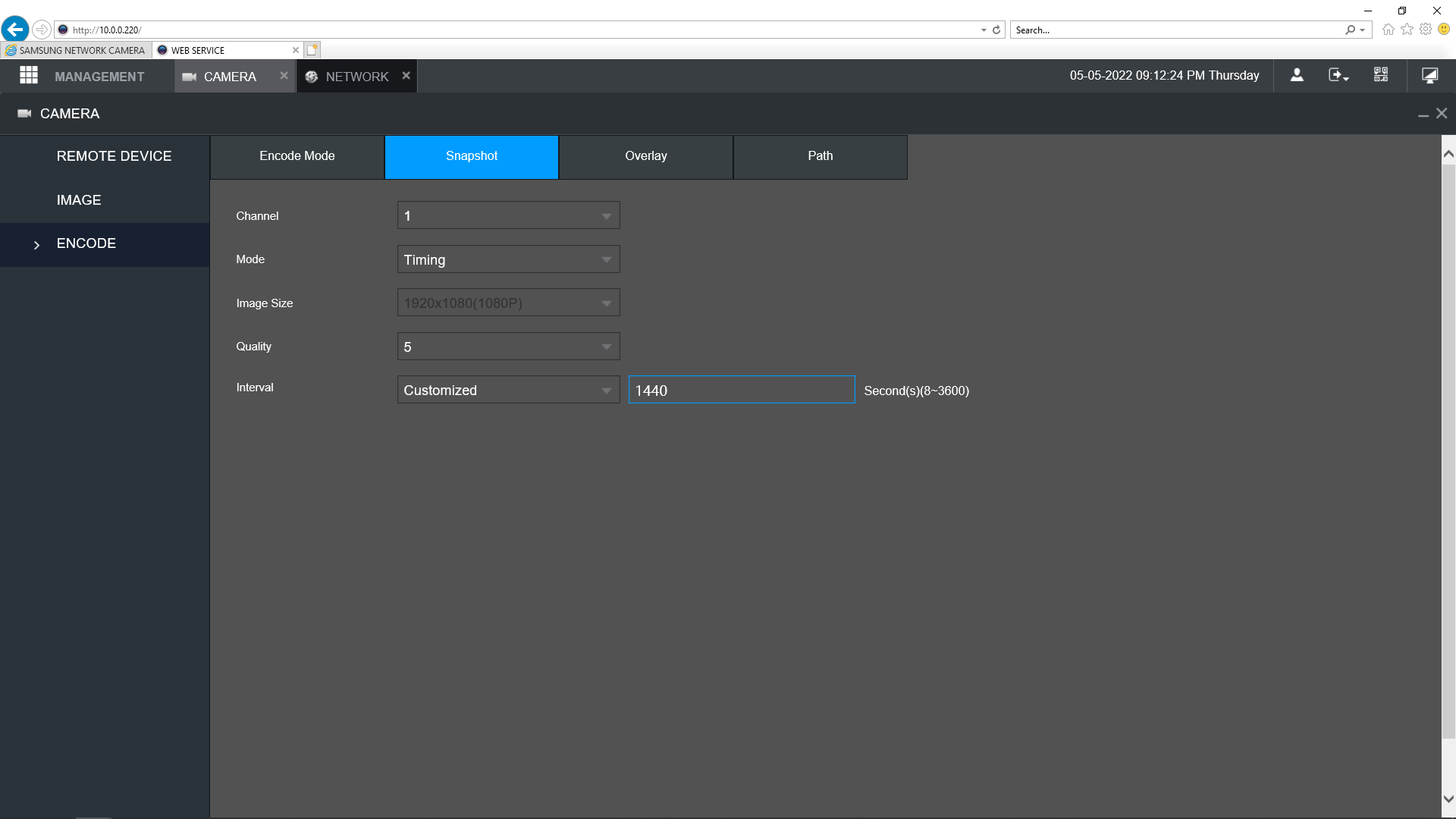

That part your pictures is showing is only for the Health Enable Interval. That will have no effect on the images that are being taken from your camera it is setup in the camera area of the NVR and the Storage area of the NVR..
in the Camera Area under Encode, under Snapshots you will want to make sure your on Trigger/Events and set your timing in there normally set to Every second. However if your trying to setup Full time Snapshots not just for Motion then you will want to use the Timing under the mode..
