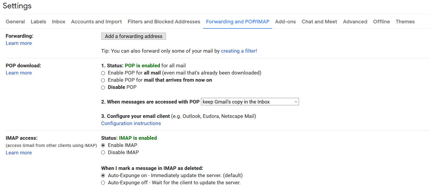

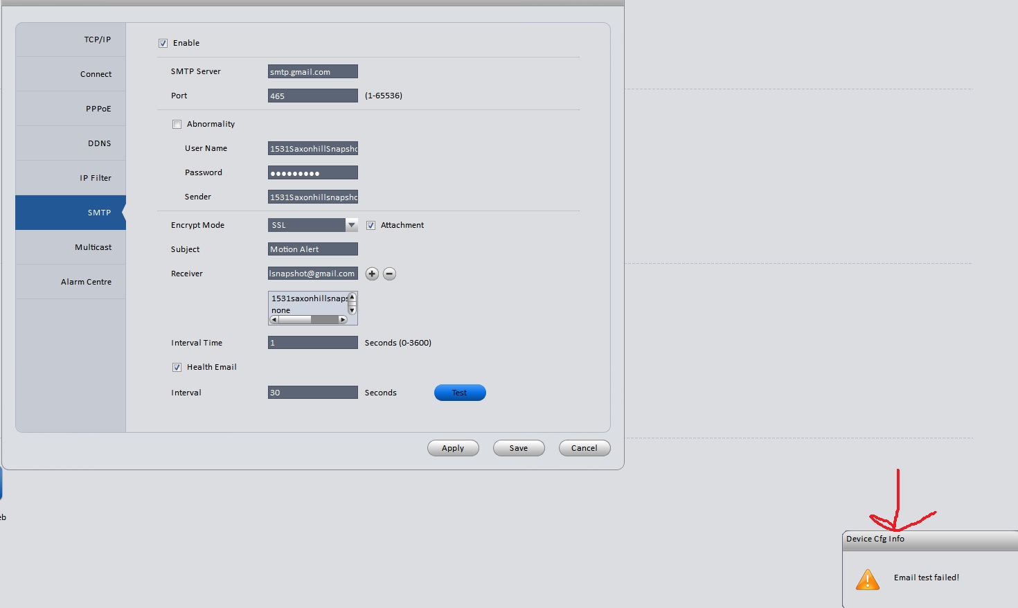

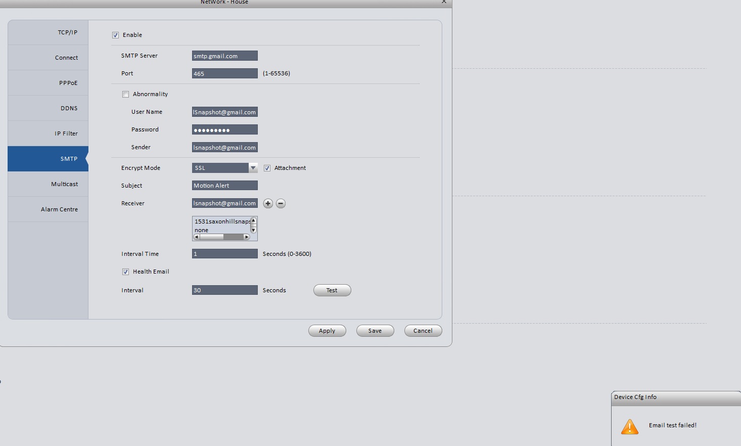

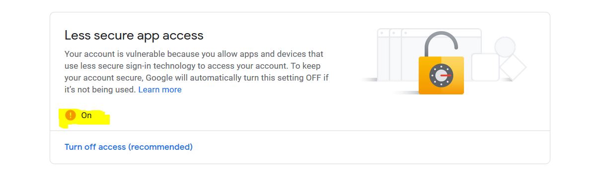

I have all the correct settings and i verified my email address was correct. I also logged into google to make sure to enable the settings but i continue to receive the Email failed error
My gmail settings
Email failed Error
Email failed Error

I finally got the Email Test to work on the NVR.
Yahoo (SBCGLOBAL.NET account) stopped working around July 20th of this year.
I played around with every sort of setting and finally switched to an old Gmail account. Still did not work until I realized I had to go to the security settings ofthe google account and set up an applictaion password. Never heard of this before, but it has to do with the two factor authentication. Once I set this up, I was able to have the NVR Test Email work.

Can you be more specific i have a screen shot of my email settings in google. Is there some other settings?
Re: Email failed Error
Select Manage Your Google Account - Select Security on the left side - Find the SIgning into Google section - select App passwords. Follow on-screen menu from there.
