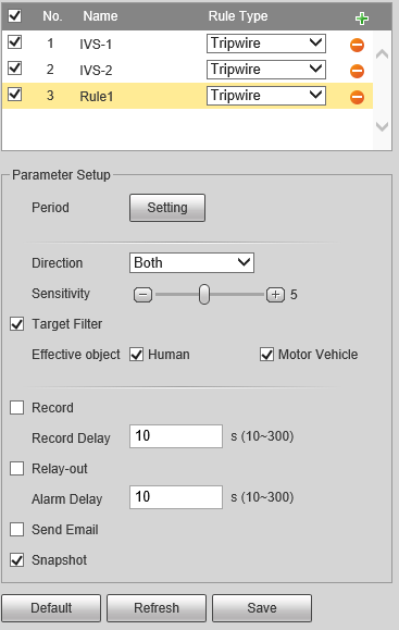

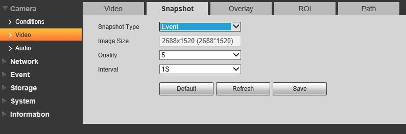

Re: Email Alerts
Well couple of things, In the Camera if it isn't setup for Snapshot even without having a Micro SD the camera won't send one. Kind of hard to understand but was something I had at one time when i wasn't getting any images sent. Come to find out not only the NVR but the camera has to be setup for image sending.. Don't mean in the camera sending to Email just that you want to have the camera take snapshots. Also important to look under your camera settings to make sure that they were not setup wrong. Leave them setup for 1s and personally I wouldn't try to get Best picture quality I would leave at 4 or 5 if issues with being on a Metered service I would take it down to 3 or 4 for quality personally.. While I am using IVS in my pictures below it is same idea of where the Snapshot info is and on the event page making sure that Snapshot is enabled..

Revo2Maxx wrote: ↑Fri Feb 16, 2024 1:36 pm Well couple of things, In the Camera if it isn't setup for Snapshot even without having a Micro SD the camera won't send one. Kind of hard to understand but was something I had at one time when i wasn't getting any images sent. Come to find out not only the NVR but the camera has to be setup for image sending.. Don't mean in the camera sending to Email just that you want to have the camera take snapshots. Also important to look under your camera settings to make sure that they were not setup wrong. Leave them setup for 1s and personally I wouldn't try to get Best picture quality I would leave at 4 or 5 if issues with being on a Metered service I would take it down to 3 or 4 for quality personally.. While I am using IVS in my pictures below it is same idea of where the Snapshot info is and on the event page making sure that Snapshot is enabled..
Ya know, I remember that screen, but don't recall seeing that tab on the display. I bet that's my issue. Will check and see if that works this evening.
