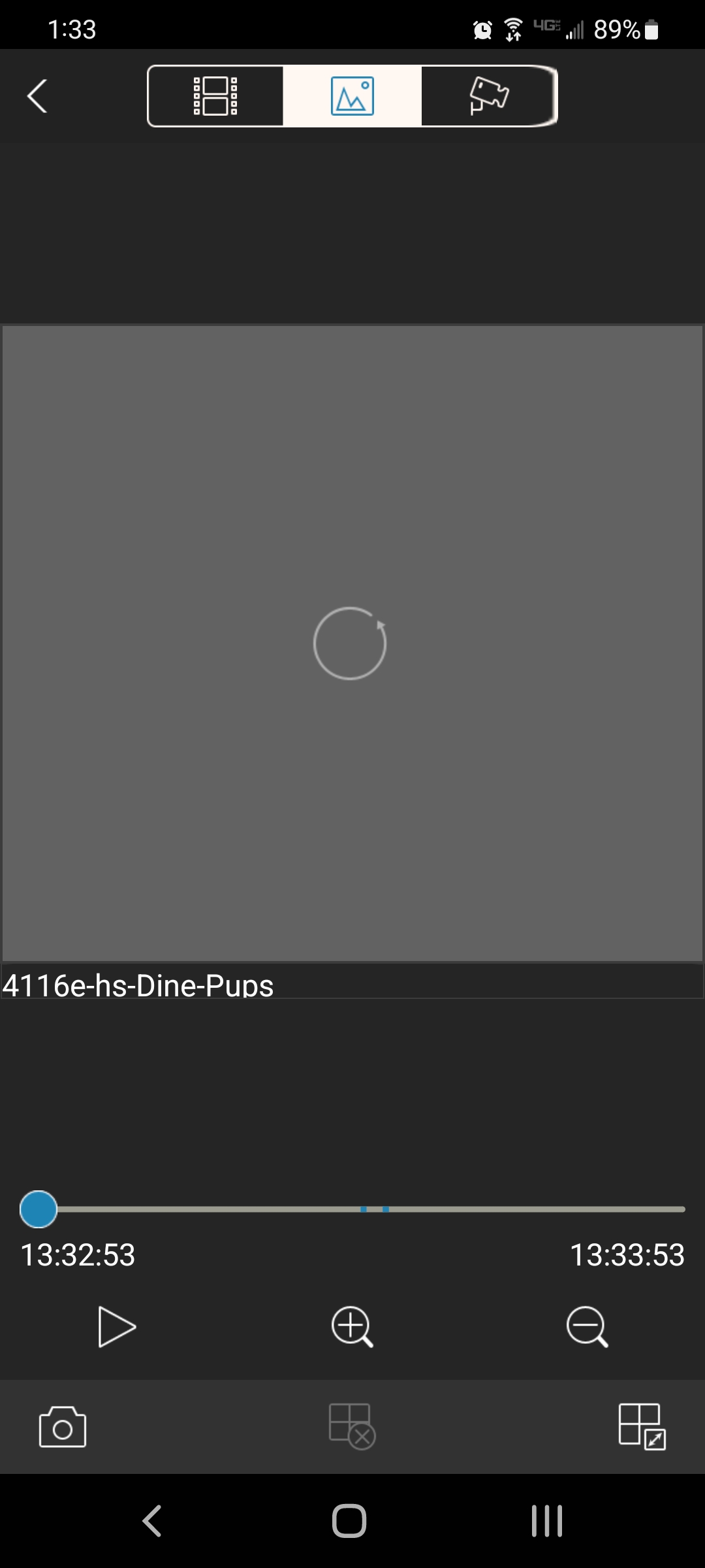

Well if I had to guess it sounds like your device was setup on your phone before your update to the Channels were done. I say this because when I just setup one of my NVR's to send a push it shows the name of the device and channel. See picture below.
So why do I think this. well I do loads of testing and have more devices that I care to admit. When I do resets and or other changes within my systems I found that there are times that I will get an alert that isn't from what I expected. Then after looking at my app I find that there is some changes made that didn't update in the app. Way to cure this is remove device from app and add back..
Like the other day. Got a message about the Pups from IVS off my 4216E-AI NVR however when I looked at the event playback I seen it was Neighbor weed eating his back fence on my side. Then realized the channel where that camera is now was where I had my Pups camera before. So removing that device from the app and adding it back now has all the correct channels names
The pups now are on the 4116E-HS NVR and no longer on the AI NVR..
