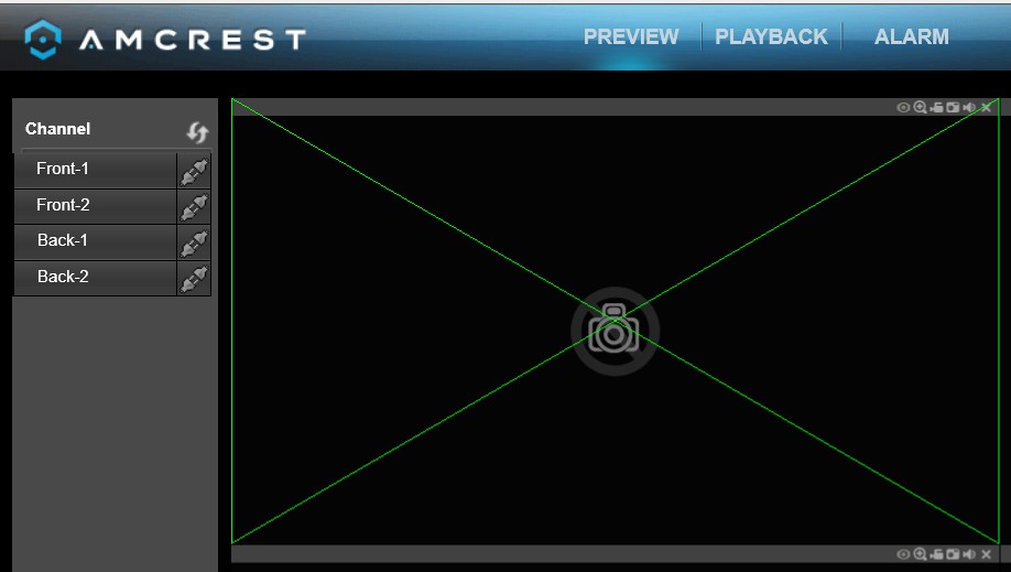

I have better luck with outdated & discontinued Internet Explorer to view and interact with the NVR5208E, than I do with the recommended Chrome Easy Viewer App. I can't believe, it's 2020 and these are my options to view my brand new NVR.
Maybe it's me, it has been in the past and I am sure it will in the future, but if not, can you please help advise me on the following.
1. There is a green X highlighter that appears over the video of the selected channel. It is pretty annoying and at times, gets all crazy out of shape.
Image:
