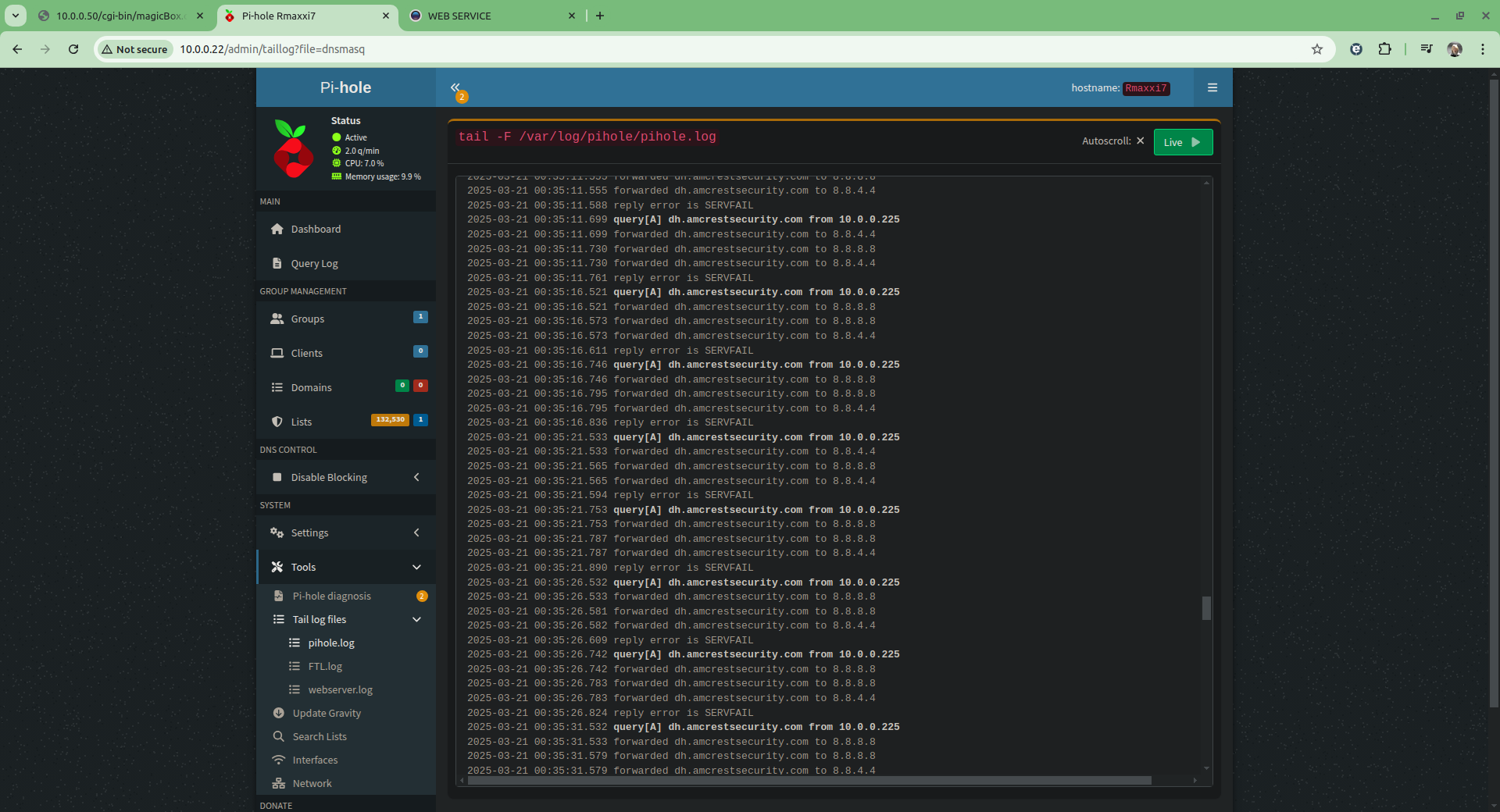

Even if I don't touch the e-mail page on my NV4216-EI it attempts to resolve "mailserver" every 6 seconds. Is there any way to NOT have thousands of queries to my PIHole every day?

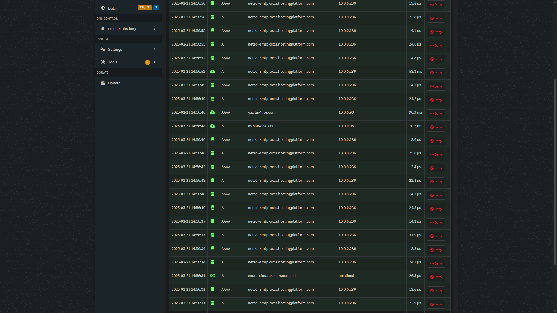

Not seeing it in my Pi-Hole can I see a snipit of the logs? I am not saying yours isn't doing that I am just saying I am not seeing it from my 4216-E1 that don't have a mail server setup in the network area of the NVR..
Re: e-mail server name query every 6 seconds
SO I even thought well maybe they had setup on accident an event to try and send email so I setup one for my ai camera with audio enabled seeing it is very windy and get audio alert often I thought maybe that will trigger a lookup or something for email.. That didn't do it either? What Firmware are you running on your NVR? Mine has the last one offered on Amcrest Firmware page?
So I thought I would add another NVR as I don't normally have them setup, Nothing happened like when I added the 4216-EI to the service. However when I rebooted the older model it did fail to setup P2P at the start up and did post to log a few times one right after the other until it moved over to googles secondary DNS server on the NVRs DNS setup. Maybe what you think is Email is infact P2P that is failing to setup because of the way it is running. It don't like my Pi-Hole. So if P2P is the issue and you don't use or want to use P2P then turn it off in the Network TCP/IP area of the NVR. Could Be Called Access Platform or P2P depending on FW version. One turned off it will take 2 hours before the pings stop or I should say could take up to 2 hours..
Screenshot from 2025-03-21 00-44-44.png (476.89 KiB) Viewed 5718 times

For consistency with your previous post here is the tail of pihole log

Just an update, I did a factory reset on my NV4216-EI. I did nothing but the HTTP setup and I still get requests to PIHole (DNS address provided by DHCP) for the default "Mailserver" every 6 seconds. And my config export/restore failed so I get to do all the setup again manually ...
