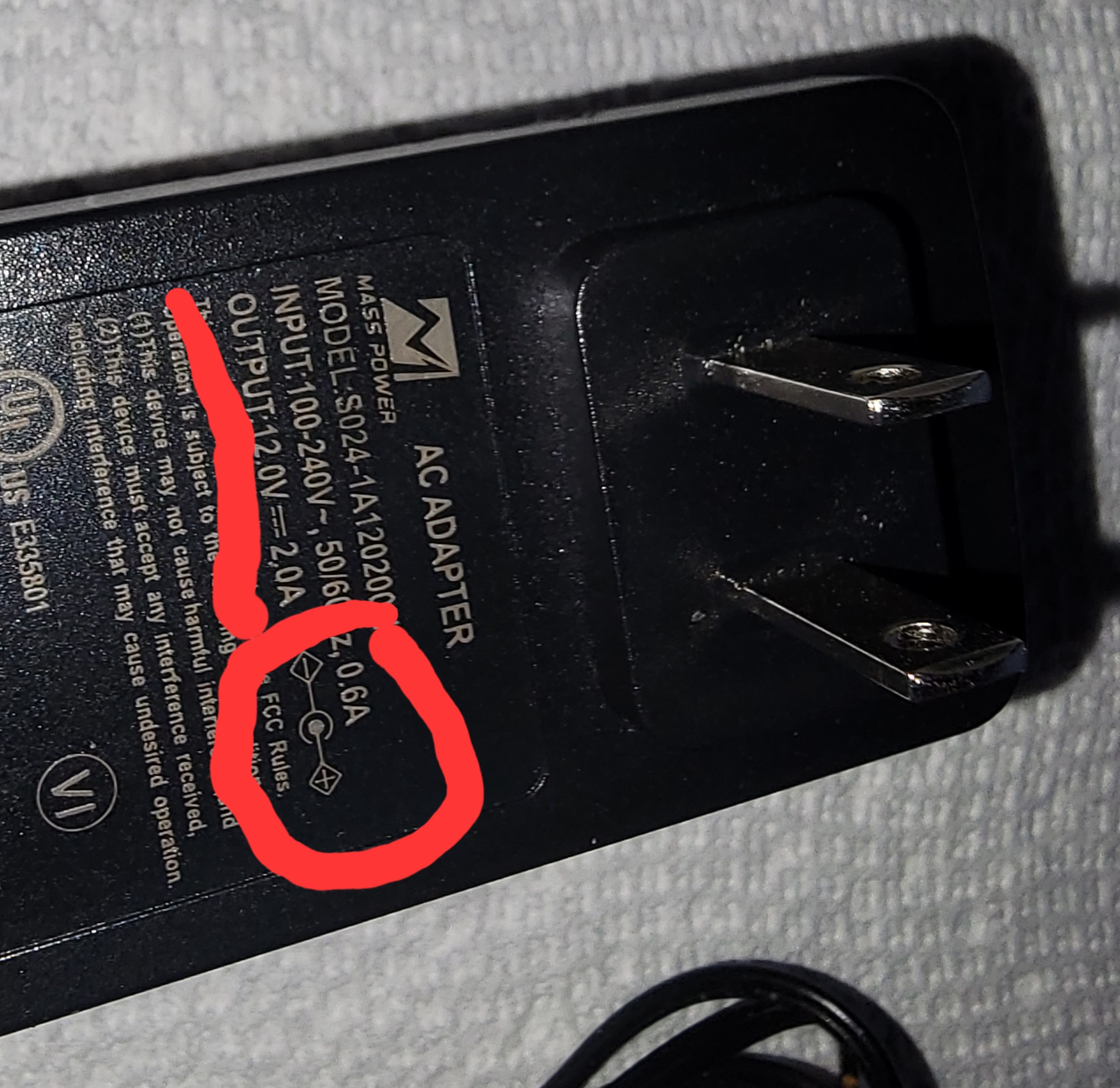

1 last thing to keep in mind, When you are looking at the PSU of any other device keep in mind that normally the Center is + but there are some people out there that like to be different and might have the power on the outside. So when looking at the AMPS also make sure that it says the Center is + and the outside is -..

Ok. Yes testing a new power supply would be best bet. Some systems for cameras come with a power adaptor with 4 or 8 pigtail.. However if your camera power supply is rated for same or more then the DVR I would unplug the cameras and use that one to test the DVR with HDD installed to make sure it is PSU related.. Most of my DVRs are 12v 2mp unless it is higher output units with 2 HDD then might come with a 12v 4amp, I have one that came with 12. 3.33amp as well. Just double check the bottom of the DVR. Should say 12v and something amps my guess is 2amps. Any 12v power supply that is 2amps or more could test the HDD being connected.. Just keep inmind that the cameras should be unplugged if it is 2amps so the voltage don't drop to much and cause damage to DVR or cameras..

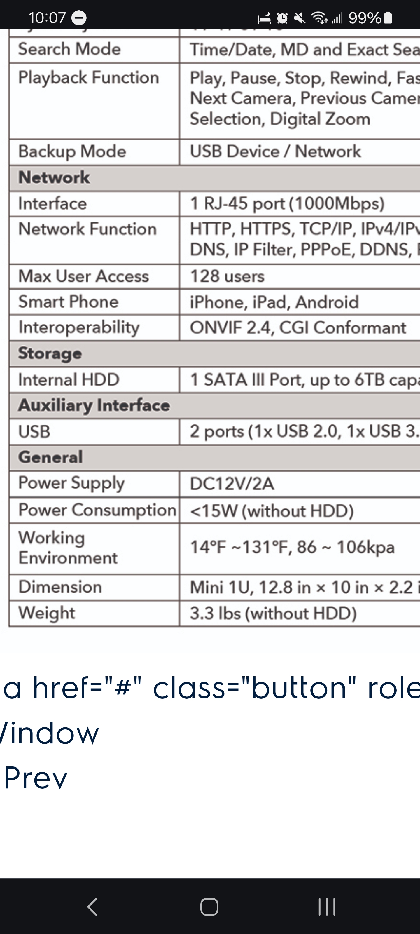

so i have this dvr https://amcrest.com/catalog/product/gal ... 49/id/389/
model is AMDV4M4.
this power supply will work for my dvd...
https://www.bhphotovideo.com/c/product/ ... upply.html
Re: DVR won't boot with SATA cable plugged in. AMDV10818
From what the image on specs page yes.
