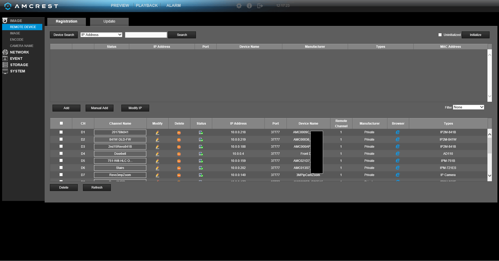

Why not just use the WebUI for one or both? To be honest you can have better control over the system.. Also if you ran a dual HDMI setup you would only have 1 access point at a time... Meaning someone sees something on camera 8 grabs the mouse but the person down on other level is trying to follow another person on ch4 now 2 people are fighting over the recorder...
However on system over Network maybe location 2 you don't want to have the ability to change camera configs or other things you can make a different account with admin or limited access admin and you can both do things as long as your both not trying to access the same PTZ cameras your alright.. Every once in a while I run into that here.. I will see something on one of my cameras, it is on a Ch that leads to one of my PTZ's so I will switch over to the camera and my son is already using it.. So i won't tell him but I just pop his network access for a moment so I can use the camera lol.. But you can on one of mine anyway even add cameras over the WebUI
Screenshot (2644).png (89.13 KiB) Viewed 488 times
