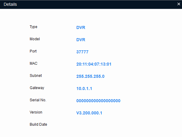

Have a AMDV10804-2B2D-W DVR system installed. Has worked great for the last couple of years. Had a power failure about two weeks ago and when the system came back up the p2p was messed up. Could not get it work on any mobile device. In the process of troubleshooting I noticed that the system does not recognize a serial number. Both in the direct DVR menu as well as the UI interface. The p2p QR code generated shows the serial number as lot of zeros. I've gone back and forth with customer support now for over a week. They have been good but somehow seem to be limiting themselves to one single email reply back per day. Half the stuff they suggest I've already tried.
I have tried resetting the system back to factory settings. I've downloaded and installed the firmware both on the DVR and on the UI and done factory resets each time. The system always shows the serial number as just a bunch of zeroes. Anyone experience this?
DVR will not recognize serial number?

First log in to your WebUI using the IP address for the Dvr and take a Picture like the one shown here... Second please post the first 6 numbers of the Mac Address for the DVR!

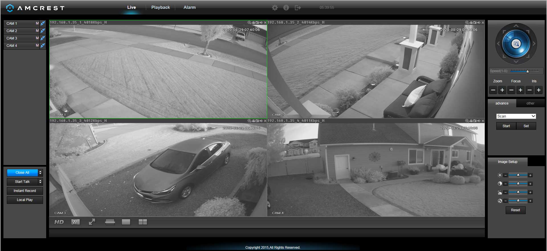

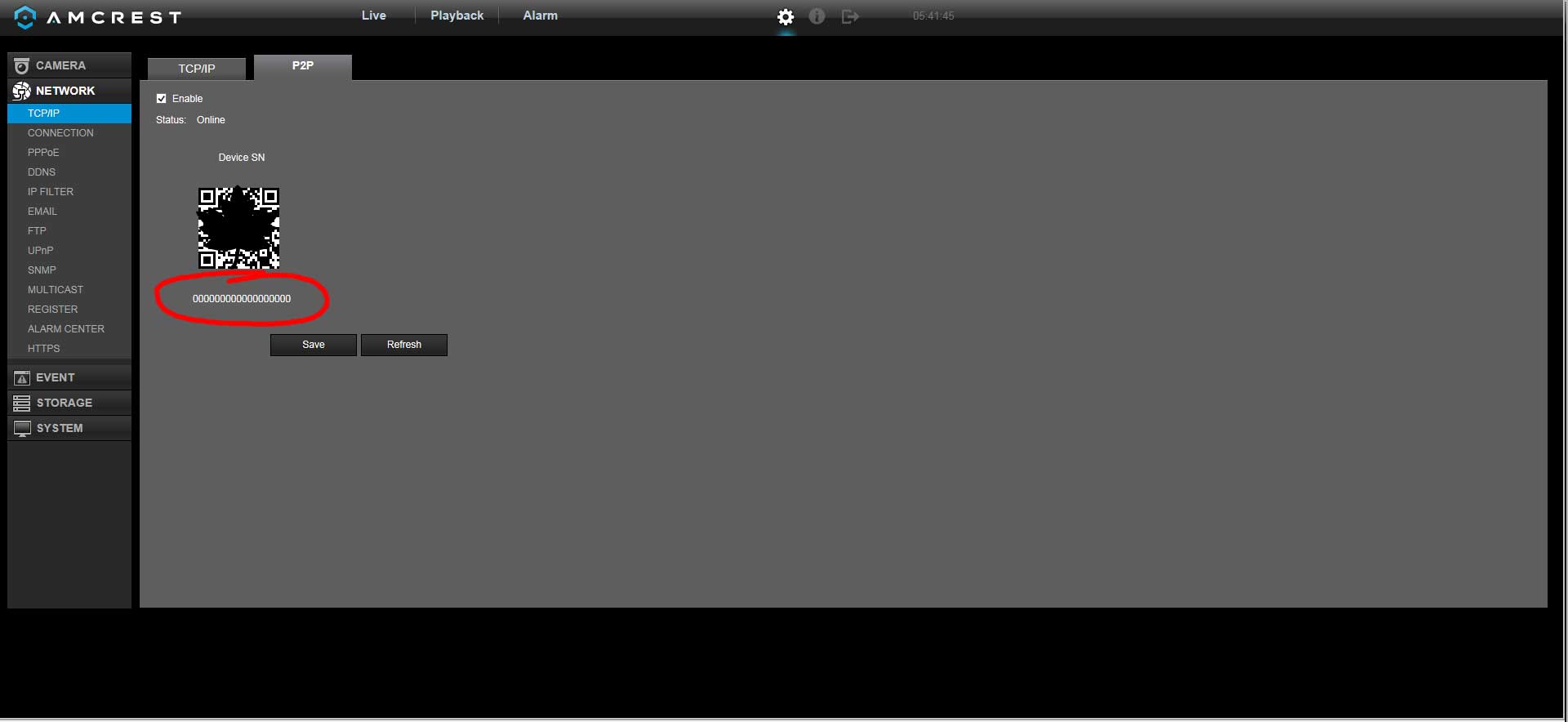

This was purchased direct from Amcrest via Amazon. Here is the pic of my UI interface as well as a pic of the serial number which shows as zero.
- Amcrestss2.jpg (43.51 KiB) Viewed 6065 times
- Amcrestss1.jpg (127.64 KiB) Viewed 6065 times

Also the first numbers on the MAC address 20:13:12
Re: DVR will not recognize serial number?

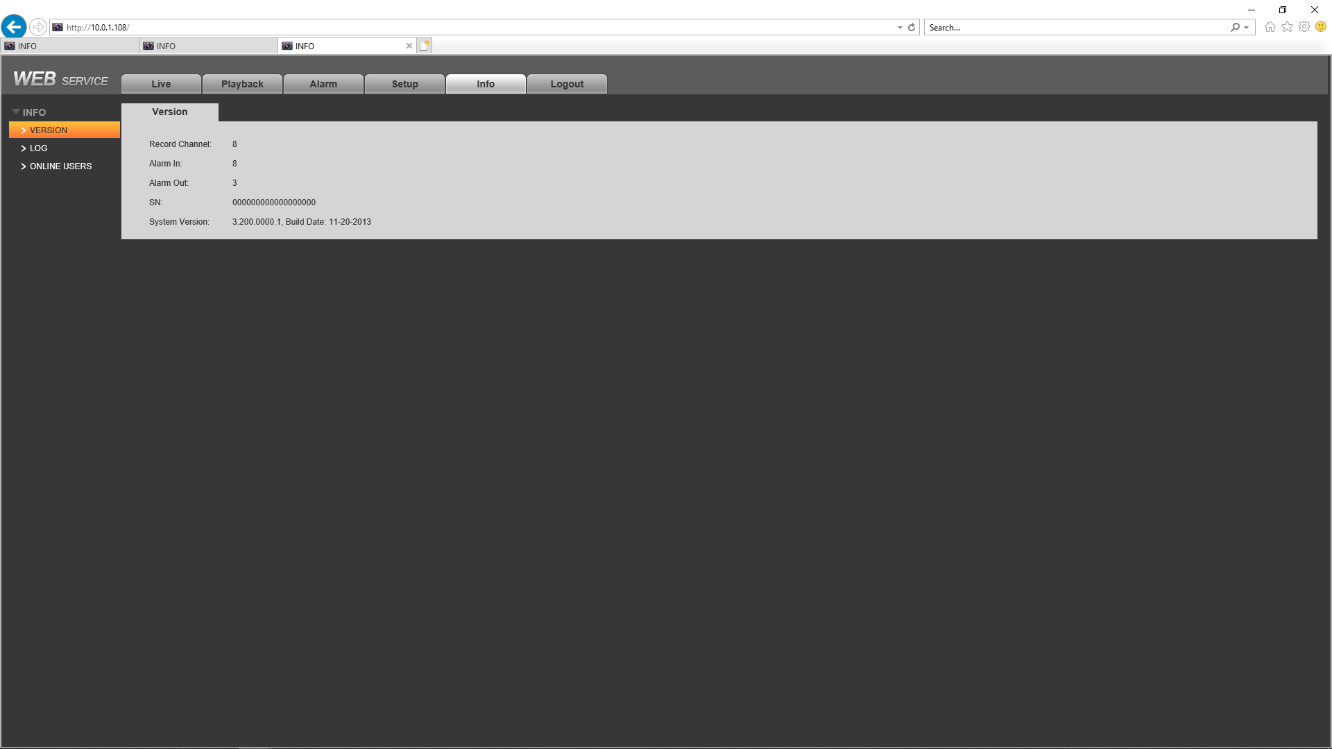

Very Odd.. Sorry to hear about the problems.. Looking into the Mac Address it is also kind of Odd that the Numbers come up Empty I looked at a good few sites to find out the owner of the mac Address and non list 20.. While Dahua does have a good listing of Mac Addresses 20 isn't in the list only ones I know and have seen on Amcrest systems are 3c, 4c and 9c starting numbers while I did ask for the first 6 that is because it can be that there are others that have some first pair and need the 6 for a good match.. Odd thing is that your machine looks newer then my CVI from Amcrest and mine starts with the 4c and do have a few cameras with that one as well my NVR's start with 9c and while are Dahua Mac are listed as Amcrest Products.. My DVR CVI is from 2015 and early release unit..

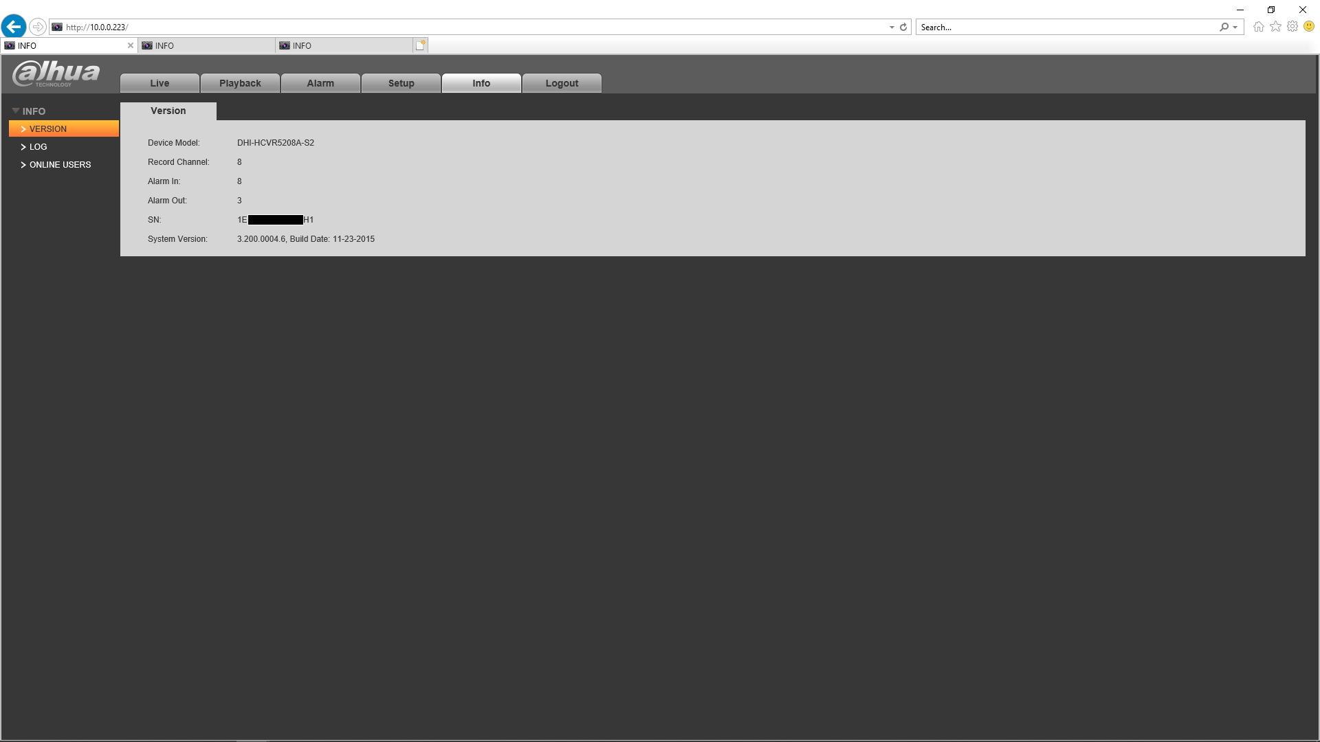

If you look at my other unit with the 000000 in the SN what is odd is that also reflected in the info page of the DVR as well.. I wonder if you looked in the Info page of your DVR if it will list the SN there? Also I am going to guess the 20: address is the pre release address for Mac addresses before programmed in my 00000 Number the mac also is a 20 start and makes me wonder if there was some code lost on power fail? Sadly with the age of the unit and where it is damaged it isn't something I am going to guess that the R&D at Amcrest could repair because I think all the Programming comes before they get it...

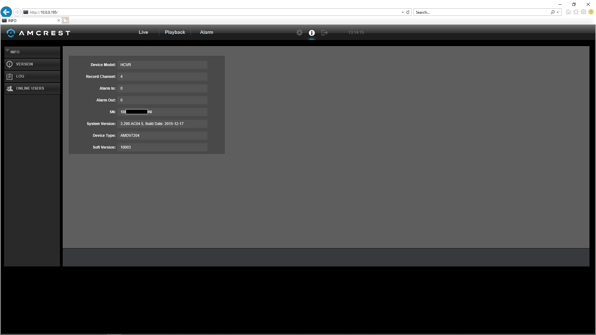

So like in my First one you will see it is with all 000000000 in the field then my Dahua has a good SN that I took out and my Amcrest also has a good SN I took out but you can see from the pictures in the info page they list.. It might be that the unit now has a damaged network area on the motherboard...
That's about what I'm thinking too, some sort of physical fault on the hardware that is goofing things up. Guess I'll have to scrap it and just get a new DVR. Got any recommendations? Want to be able to use the 2TB HD and the four analog cameras that I already have.
