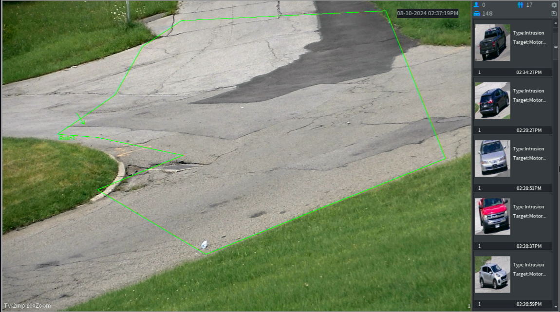

Picture of one of the features of the 5108-i3 5108-AI, 7108-AI and others of the like. This is IVS with AI mode where it will let you get a preview of the Events that are seen on the right. Great for looking at something that just happened and get to view without having to use playback. Also can do Face Detection and Recognition. I don't work for Amcrest and my goal was to try and help anyway I can. I offered advice reply 2 and 3 about how to trouble shoot power supply and that I didn't think your DVR was dead. My goal was to save you time and money and worse case needing an upgrade is to future proof a DVR that can help cut down on False alarms getting loads of emails or push for alerts of rain, snow and other things that are of no interest.
