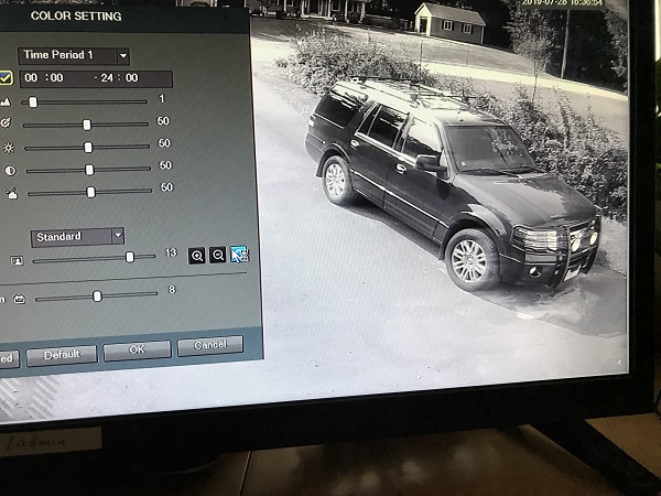

This image shows the video during the "EQ" Reset, but before it has been set. So it would appear the DVR is capable of rendering a reasonable image. Another channel (same model camera) with an "EQ" of 3, appears very reasonable.

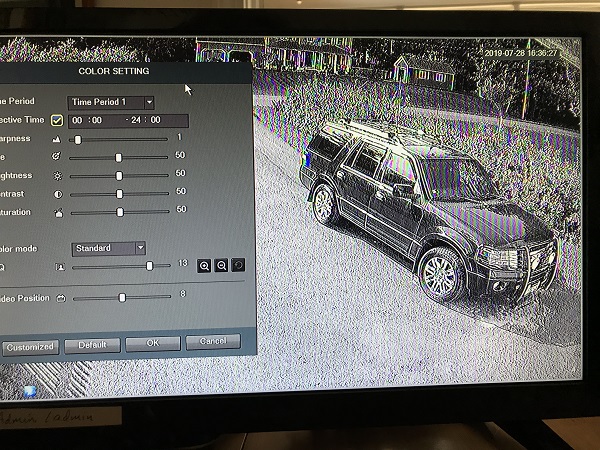

This image shows the video as seen on the monitor attached to the DVR. Note the "EQ" set to 13. Using the "+" and "-", it can be changed to 12 or 14. Repeated attempts to set any higher or lower are ignored.
So there are really two questions. First, why such a large range in "EQ" for cameras of the same model? Second, why is the "EQ" range limited?
Thanks in advance.
- Mark
