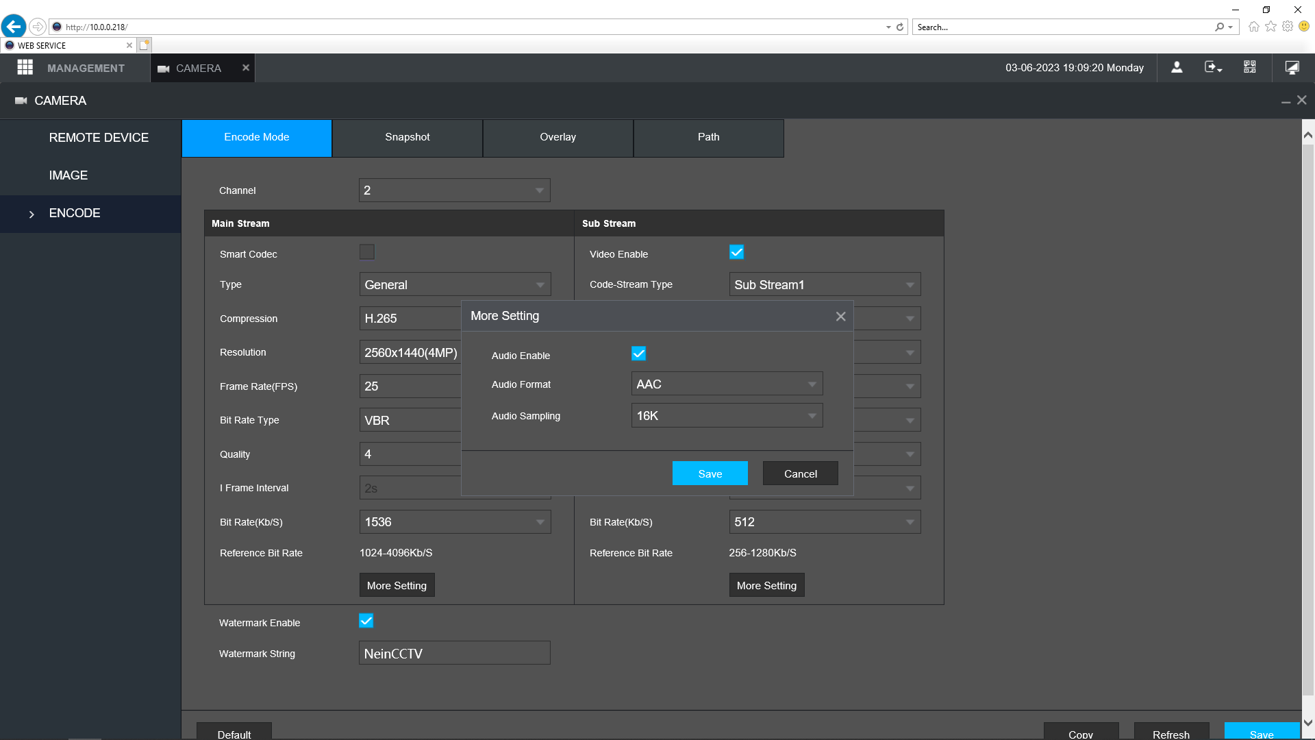

I have over 29 NVR's installed these NVR NV5232 with several IP5M-T1179EW-28MM cameras. I have looked all over the settings in the NVR to turn off audio recording and yet when I playback recordings it has audio in the files.

You have a little bit of work ahead of you then.
In your NVR's WebUI or in the NVR GUI you will need to go to Camera, Encoding, More Settings and turn of the Audio on each of the cameras that have Mic installed or Mic's built in. This will need to be done in both Main and Sub Channels and if you have cameras setup with a 2nd Sub Channel in that one as well. Most times only Main and Sub and in some systems it would turn off when you turn off the Main I can't say what it is on the NV5232 as I don't have that one in my lineup..

Re: Disabling Audio recording on NVR
@Pogo you're right it would be easier to do a copy and I guess if the Op or readers have same camera on the NVR's doing a copy would work. I personally don't copy anything outside of the HDD options of setting all my Channels record type. So because I don't know if it would change all Encoding type to the same as well I figure maybe not a good idea to give that option. I mean I have some cameras that are 22FPS and others that I leave at 30, I have some that are 4960 bps and others that are h.265 that I have at 2048. Then I have others that are h.264h and others that are h.264. So I didn't want to say to someone to just copy it from the first channel they made the changes in to the rest as it might copy more than just the Audio being turned off and I don't see any option for just Audio in the copy settings?
About them being turned off? I personally don't know. I know that some of mine after being reset I infact had to turn them on. However some of mine are because the Mic Isn't built in and the Mic and Speaker are connected to RCA.. Then again I have also had some with RCA that I didn't turn on and it was already on. Like my Amcrest 850E PTZ camera, It has a audio in put that is wire pigtail and I didn't enable it when new or after a reset and the Camera was already enabled oddly.. So I am not sure that it is odd really. I was thinking maybe it was because the camera was on older FW. So I thought ok lets see what happens when I reset my 853E PTZ. It also has bare wire Audio in and out and not built in Mic. So I wanted to see what happens with that. Kind of a Pain because it is connected to POE NVR but I logged in anyway and Reset the camera back to Factory Default. This camera has the Newer FW on it and sure enough after a Reset to Factory it loaded back with Audio Auto Enabled..
