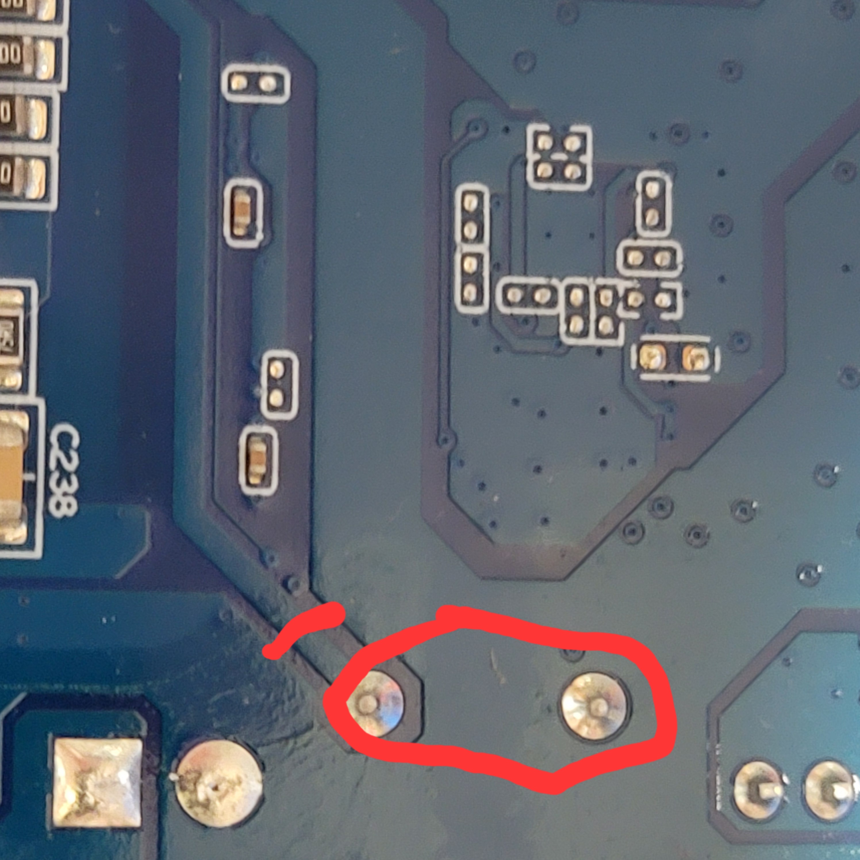

There is no way to turn off the Beep short of removing the Piezo. However if you are Electronics enabled you could add in a Resistor to reduce the volume of the sound. In a few of my systems that I have in my Security Closet I have removed them. This does require the removal of the PCB from the case to gain access to the soldered pins.
Then you have to ask. Does this NVR still have a Warranty? If it does then any Mods shouldn't be done. Also keep in mind that without adding in a circuit adding in a resistor would also reduce the volume for all other alarms you want the NVR to emit. With that said if you don't care about Warranty or all alarms then remove PCB, cut one of the traces on the bottom leading to piezo, remove the some of the solder mask on that trace at both ends, then solder on a 0603 sized resistor to fit your needs.. You will want to test a few values to get to the desired volume of sound it emits.

Here is a picture of a 4108-A2 this is a non poe so pcb layout will be little different. However this is the Peizo bottom side and line is where I would install a resistor.

I just got the NVR today, so I'm full on warranty but the sound will drive me nuts. I guess I could just desolder those leads and remove the piezo completely... Seems a bit excessive but so be it. I do have some resistors laying around so I suppose I can experiment with those before I go nuclear.
Re: Disable startup beep on NV4108E?
Yeah easiest way is just to remove it.. It will have non-Leaded solder so adding a little lead solder would be best to remove without damage to the Piezo. OR even some Chipquik if you had some laying around..
