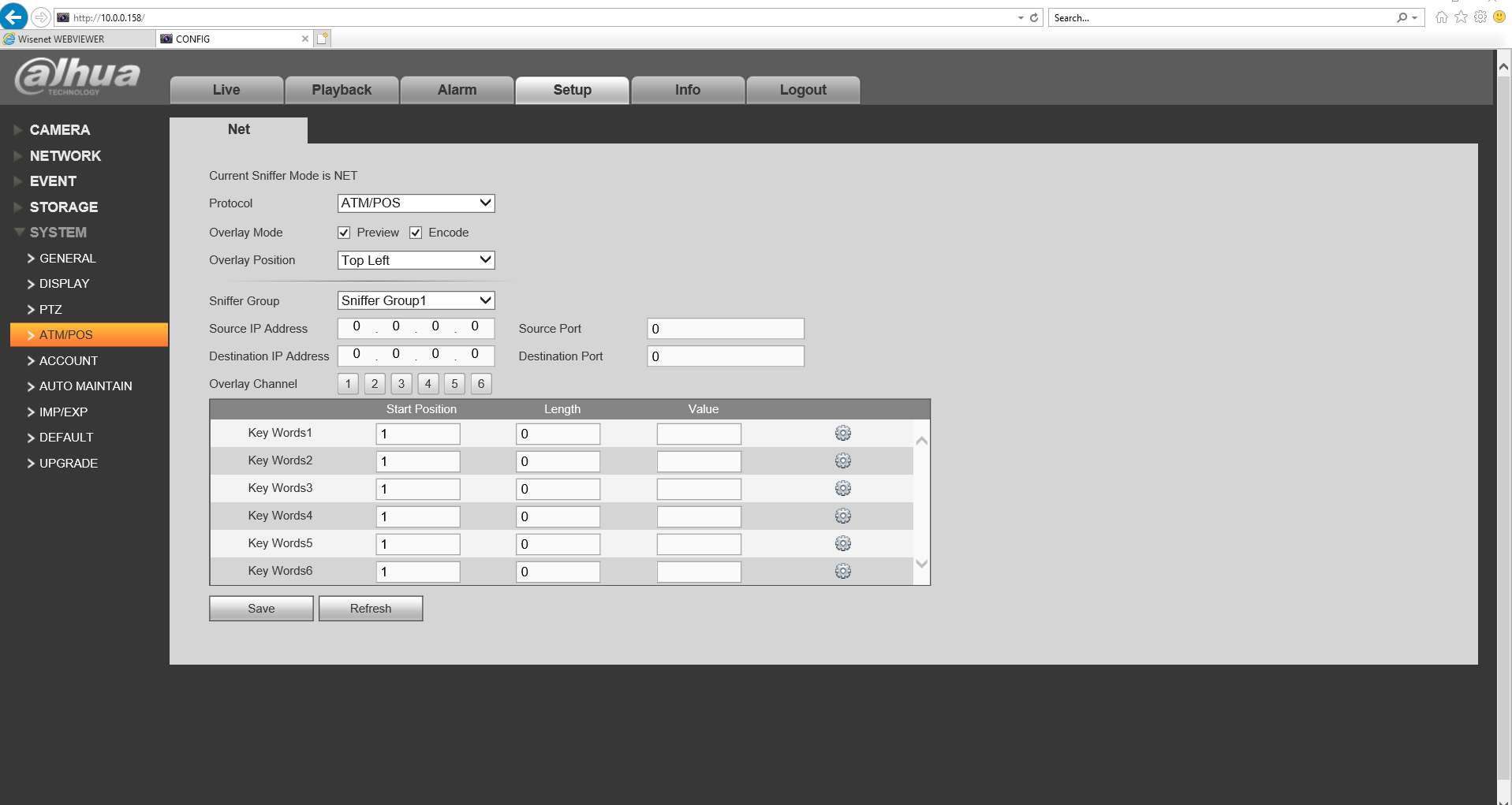

Sadly this isn't the case.. I have a load of Dahua Products that have the POS option and some others and they are way before the Smart devices.. I have a 8ch 4 port POE NVR from Dahua that also has it that is from 2013.. Even some of my Dahua Cameras offer it

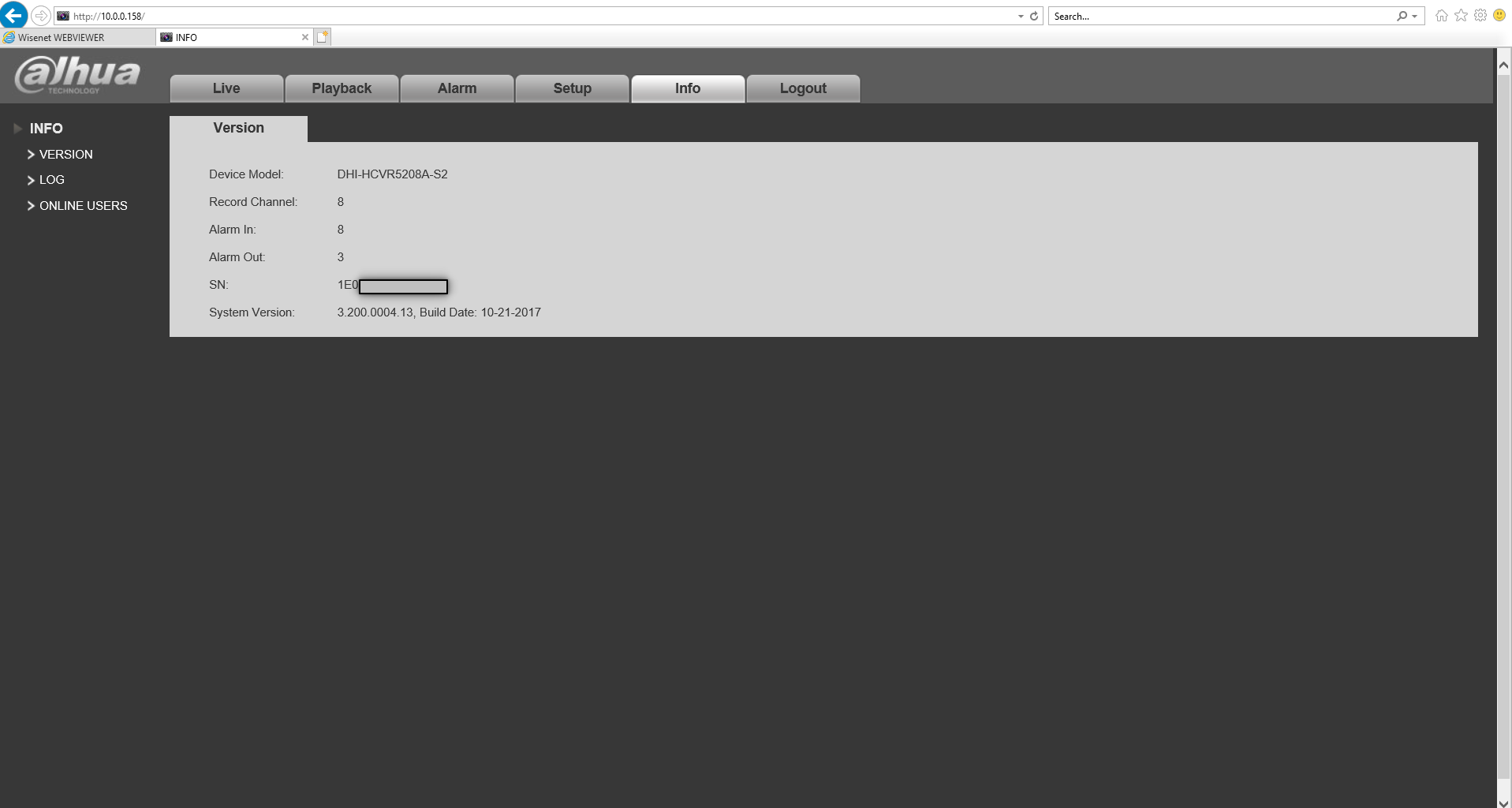

Re: Confusing NVR model numbering
So I thought I would seeing you mention this thread in a different question asking about what they should buy in there needs not really related to your thread with confusing numbering.. But I could show you more models I own if needed this was first I have accessed since you mention and this is the newest of the models I own.. (Not this is a NEW Dahua by any means) you can see in this model it has the POS feature isn't a AI and to be honest Amcrest I am going to guess because the need for Retail might not be their target I am going to guess is why they Elect to Remove the POS/ATM feature from their line up.. I will admit I think I did have one DVR from Amcrest back in 2015 that had the POS menu before a Update in FW removed it,, It has been long time so I am not 100% sure if that is FACT my old Brain isn't as sharp as it once was...
