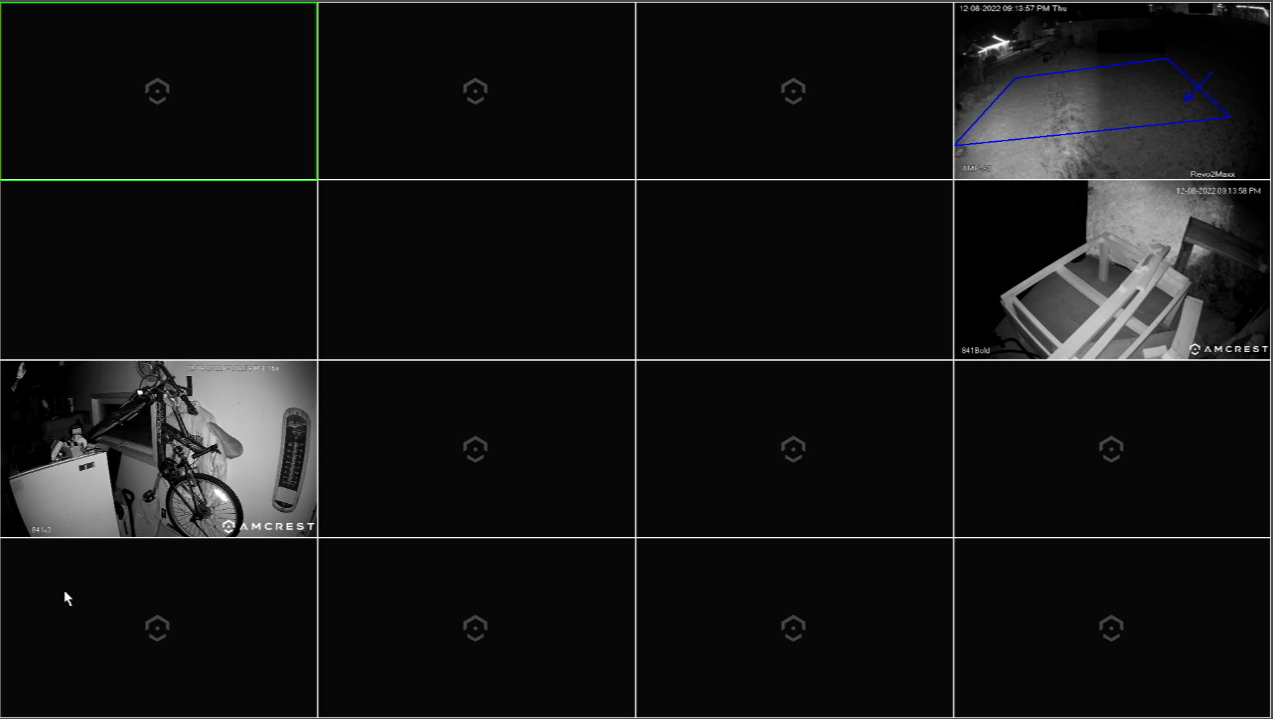

So to make it come back online just use the GUI lol. I mean I was on his WebUI, I reboot and enable I click Grid view to see his was still off I was not having any luck and so I was doing mine the same way. However after I was able to get it to do it the second time I went to my Zero Channel, I then thought ok lets see seeing I am at the NVR on Screen lets see what happens if I Disable and Re-Enable from the GUI and sure enough it came back to life with all installed cameras online.

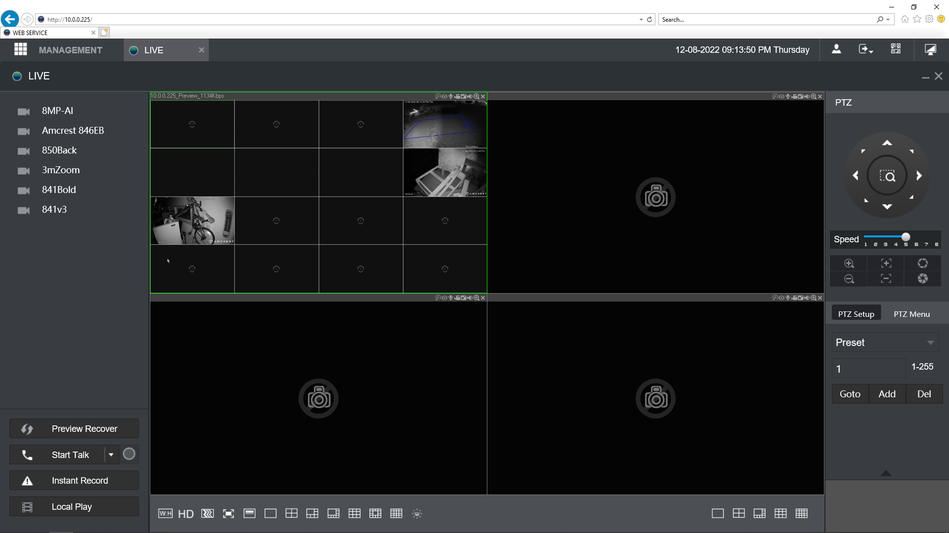

So here is the Combo where I can make this happen. I have not tried it on any of my other NVR's or even my other DVR's as I have spent to much time on this already and thought I would just share it and get it out there... I do know I can repeat it on my older 7204 CVI DVR as well.. SO I am guessing it isn't just 4.0 related. With channels setup and then changed in area of for your needs VIA Sequence. Then load 1-4 on screen, Then main menu, display and disable the screen. Your GUI will display Decode not Enabled. Then from the WebUI Log in, Reboot wait for system to come back online, Log back into the NVR's WebUI, Then re-enable the Screen. At this time you will notice the cameras come online however as you can see in the pictures 3 of them are black screens without the Amcrest Logo.. You can Reboot and disable and re-anable all you want from WebUI and it will not come back online only way to get it to come back up is using the GUI of the NVR. Or a System Reset

WebUI using Zero Channel for Grid view to show
Screenshot (3688).png (168.08 KiB) Viewed 1233 times
NVR's GUI View
Screenshot (3689).png (190.89 KiB) Viewed 1233 times
