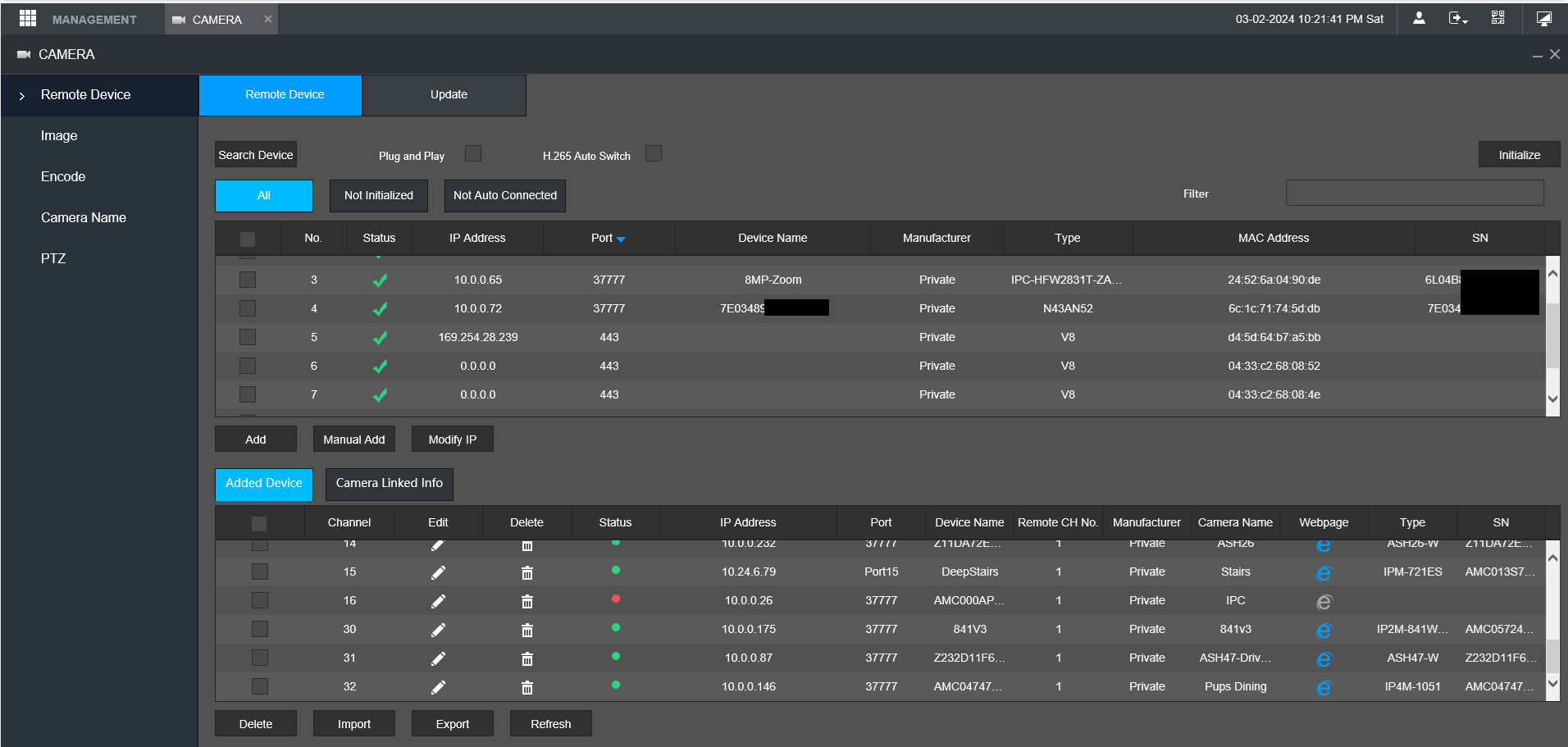

So looking at your NVR when you go to your Camera page are you saying that after removing the camera from the Bottom part *Connected camera area* that the camera never comes back into the top search area? Like looking at the picture below of my 32ch 5series POE NVR..
