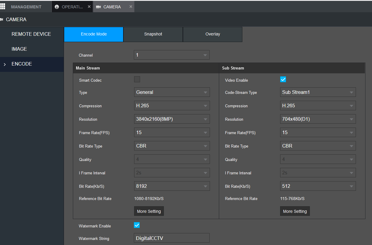

Sorry for the issues your having. Anyway you can upload a couple of pictures of the settings for 1 working camera and one that isn't under the NVR's Camera Encoding page.
So say 1-4 are working so log into the WebUI of the NVR. click on Management, Cameras, Encode and showing ch1 take a snapshot, Then 5-8 you said wasn't working right so do the same just choose one of the non working channels like say 6 and take a snapshot and upload the 2 images.

Hi,
See attached 2 screenshots from the management console you asked for - looks both the same configuration to me - for Camera1 and Camera5
