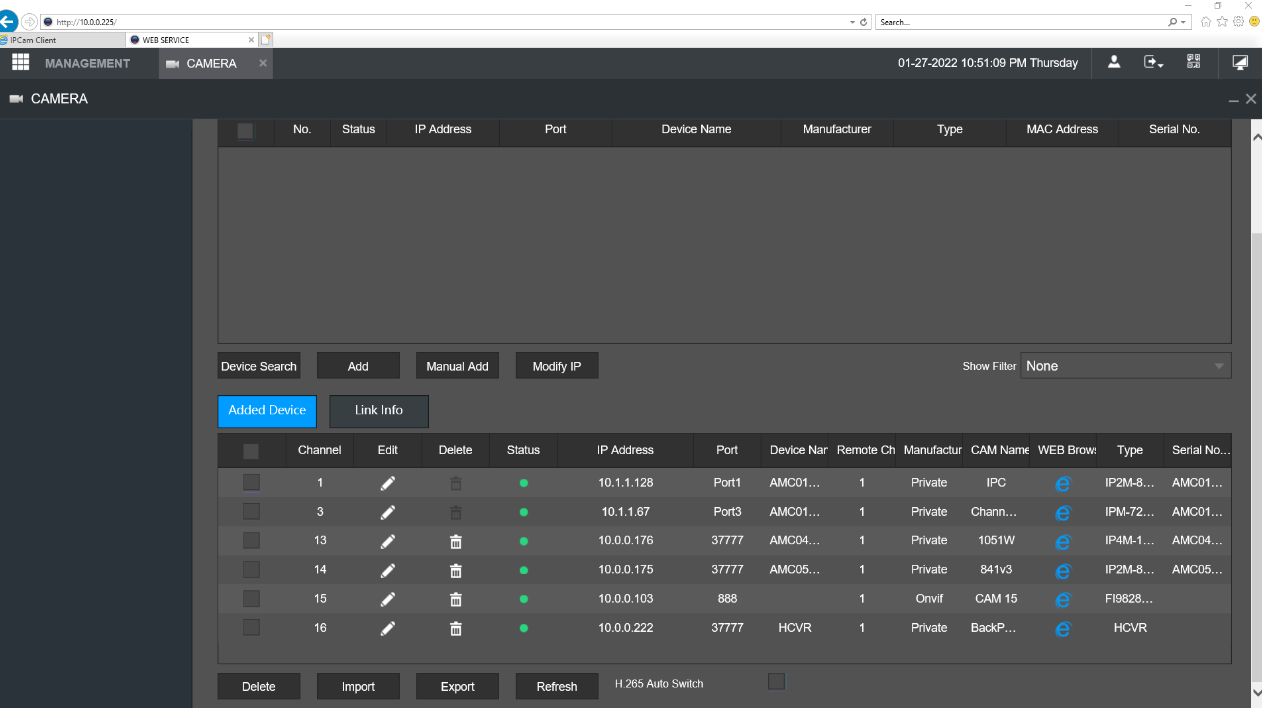

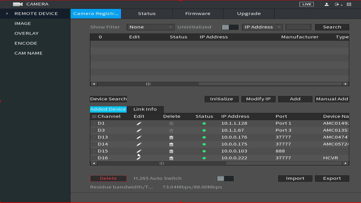

If you look at the 2 pictures below you will see my Network is 10.0.0.xxx and my NVR's Switch IP is as I said above 10.1.1.xxx and all my cameras when connected to PORTS on back of NVR will not load if it was not right camera to that port without changing the Password to the right one. However lets say I take camera from port 1 and put on port 4 it might keep same IP (doubt it) however because the password isn't normal admin I will have to click the Pencil and change to the right password for the camera.. (Changing password is important if you want to use cameras WebUI) and for Security reasons. To access the camera when it is connected to your NVR ( if you have your Virtual Host) turned on clicking the e when your connected via the NVR's WebUI. (See Picture below)
