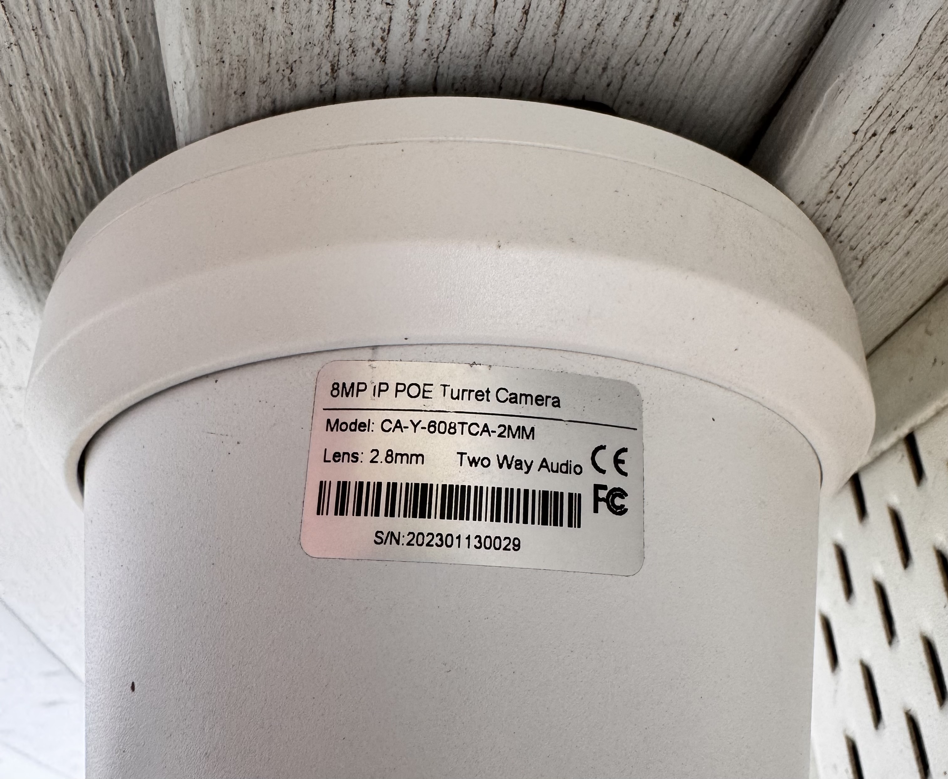

The camera doesn't seem to have a brand name on it but it has this model number and other information on it.
8MP IP POE Turret Camera
Model: CA-Y-608TCA-2MM
Lens 2.8mm Two Way Audio
S/N 202301130029

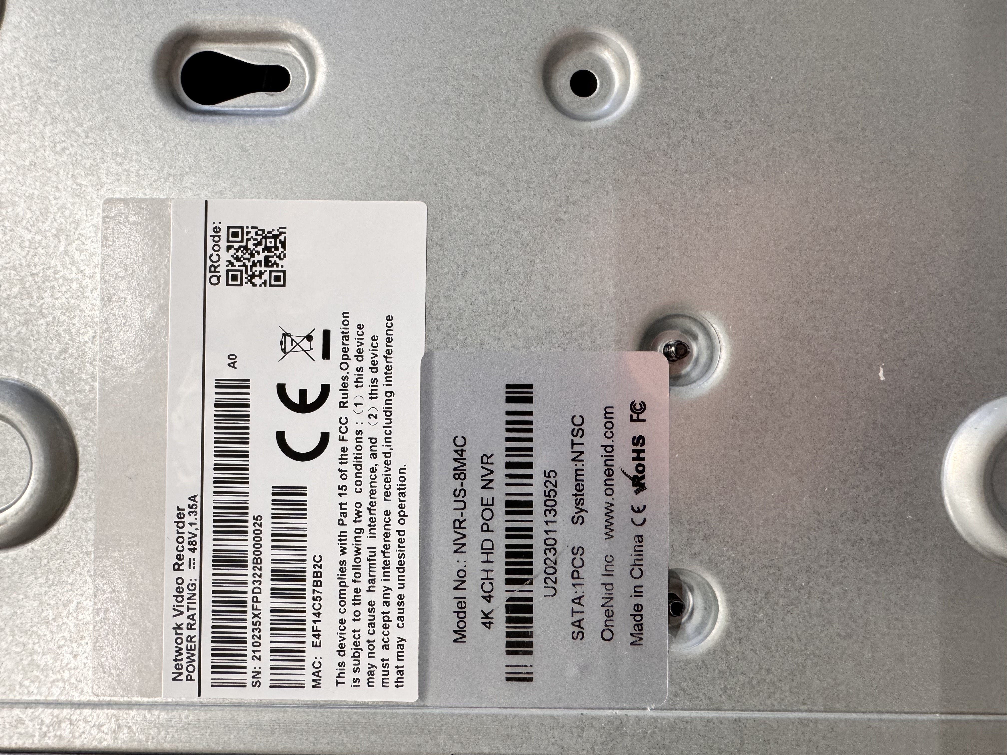

The old NVR had this information on it:
Model No. NVR-US-8M4C
4K 4CH HD POE NVR
U202301130525
SATA:1PCS System:NTSC
OneNid Inc
I hope this helps. Everything is on the same network and I believe they are ONVIF cameras.

Yeah not sure about the images that you posted. Should repost images in real image format. If you don't know how, Click the Full Editor button and then click the add in image. pick the image from your computer to upload image. PDF post of image was removed for quality control
Re: Cameras Not Found By NVR
How about this?
- IMG_0820.jpeg (3.09 MiB) Viewed 1790 times
- IMG_0819.jpeg (1.44 MiB) Viewed 1790 times
That is better.. Happy New Year..
So I don't know the Hardware and I can't say that the devices are open or a closed system.. Some devices even though they work with some 3rd party cameras the cameras for there own brand are brand only.. So a couple of things.. One if the cameras are open with WebUI.. I would go into the WebUI and see if the camera offers things like ONVIF support. Some you have to turn on. Some not only turn on but have to add a ONVIF user.. So it might be an issue like that..
