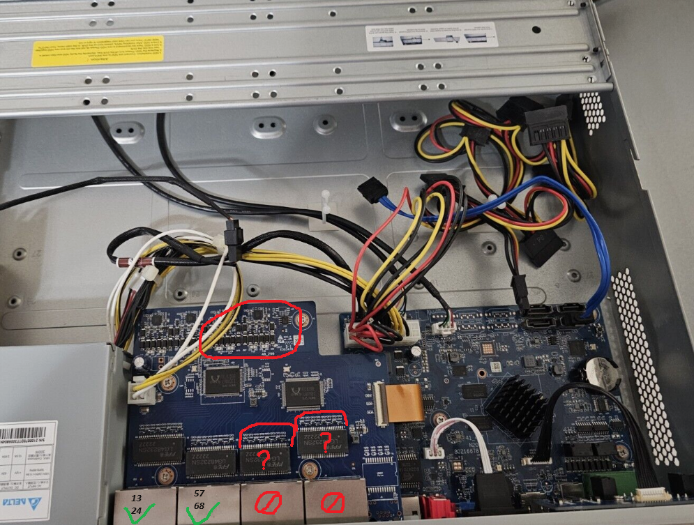

So now I am confused. So it is a 4416E-AI NVR then. With 16port POE on the back? If it is that then it could be an issue with the NVR and the NVR would need to be repaired. The offending part is most likely on the bottom of the PCB in side and won't show any signs of being damaged in most cases. If there is 8 ports that work like 1-8 and the back 8 like 9-16 then repair. Now that don't mean you couldn't still use the NVR with all 16ch. Just only 8 of them will be able to power a camera.
From what I gather from all your post. My guess is something like in the picture below. Keep in mind if it is any of the combo other then a whole block of issues. I say Black being 1-4, 5-8 and so on. Now if the Checks are not in right area but again in a whole block of the 4 the I would look at the Ethernet Transformers. however if it is different kind of issue with 1,3,4 working but 2 in that block isn't then issue might be at the front of the PCB area and not the Ethernet Transformers. To be honest it would be hard to know for sure where the issue is without testing the unit..
