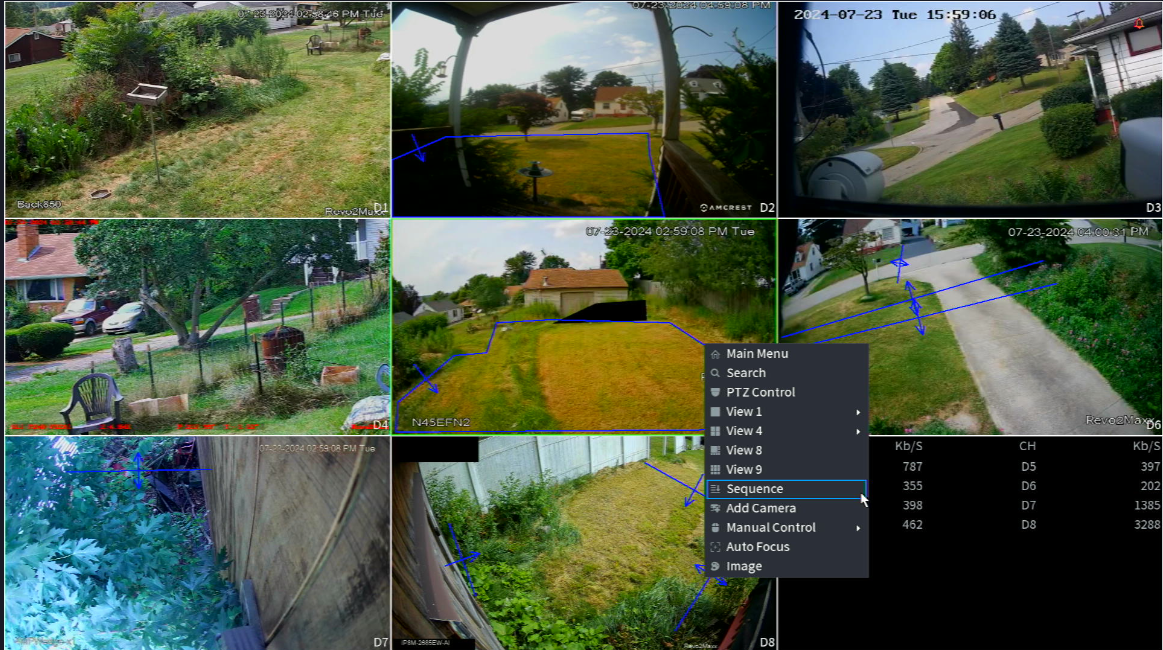

Hoping for some help. I have the AMDV5108-I3 and am unable to determine if my if the dvr has the ability to rearrange the camera positions on the monitor screen without manual moving the cables on the back of the unit. Every other dvr I've had you could just drag and drop
Re: camera layout on monitor
Hello, Welcome to the Forum
Right click your GUI, click Main Menu and log in if you haven't. Then go back to normal Grid View or single view how ever your setup.. Then again Right click and in the Menu there should be a Sequence button. From here it will open the 9 grid view, with your camera list on the right. Now drag lets say 8 to 1 and 2 to 4 then press apply. Now that is how the grid is setup in your DVRs GRID Layout.
Using the WebUI you can load in without pressing Fast Live View anyway you want.. Might even be a way in your menu to save that layout. IN some there are and others no.. It would be at the bottom left of the grid layout if there is a way to save your setup view..
Screenshot (2024).png (1.41 MiB) Viewed 3730 times

Your the greatest! I like to think I'm fairly intuitive but I would have never figured this out. Thanks again
