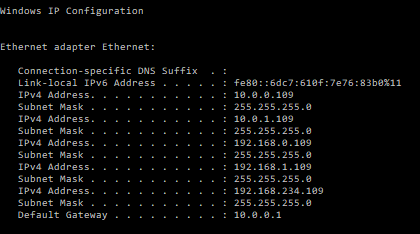

So here is a Picture of my current Computers IP setup... Please note that the Main IP and The Gateway are only 2 in the same range of IP's
SO when I take a Camera that I might have setup in another area outside of my home network, I can take that camera connect to my Switch either POE Port or standard port and with no other magic I can just type 192.168.1.108 is a common IP static for IP cameras I have had over the years.. SO if I get one and Reset it I don't have to go looking around for what IP it is set at I can just go to some Common IPs or Bring up IP config tool lol.. Most times I just use IP address in IE.. If the first few fail I will ARP in a CMD prompt window.. last resort I will bring up IP config..

PS for all the ones that are going to say wait your 10.1.1.109 isn't listed in your computer IPCONFIG listed above your right and that is because I use a different Computer on my network for that task just keep the 109 in list of my IPs I use so I know it was mine and that is why for the ones that might have seen it not in the picture above... That IP is on my Computer that I have as 10.0.0.139 in my normal Network range...
