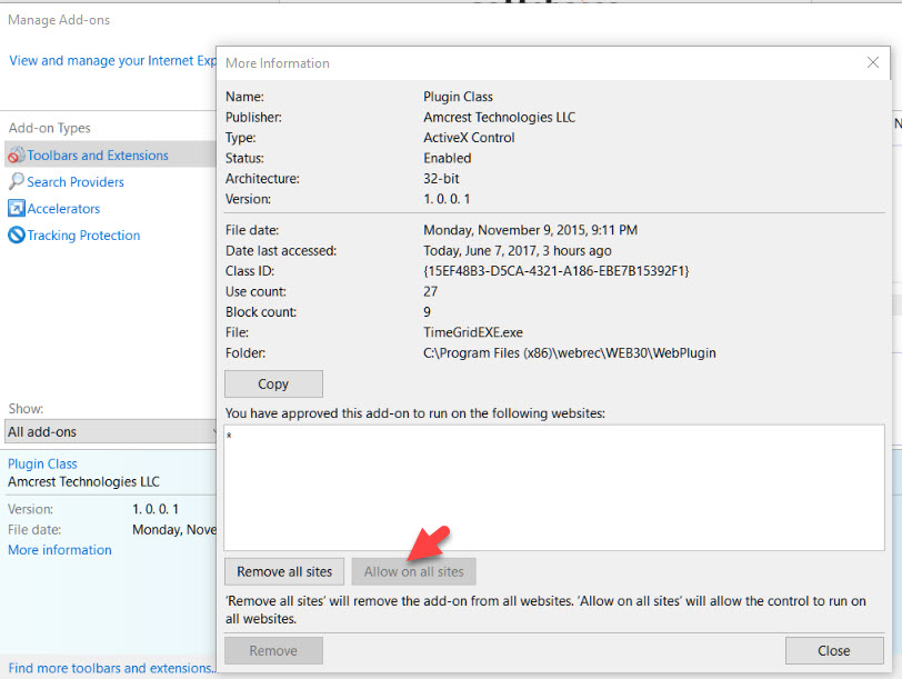

Does your login ip change?
like 192.168.1.108 then another day it is 192.168.1.112. If so you need to adjust the IE plugin to allow ALL IP's.

I was having the same issues in Chrome, Firefox and IE. I was able to get it working in IE by doing the following:
1. Open IE (I'm currently using 11) and navigate to Tools -> Compatibility View Settings
2. Add the LAN and WAN IP address of your Amcrest unit.
When you enter the IP of your unit in IE, it should now launch in compatibility mode. I had several Active X processes popup in the bottom of the browser and I clicked 'Allow'.
After all this I was successfully able to login.
Hope this helps!
Hope this helps!
