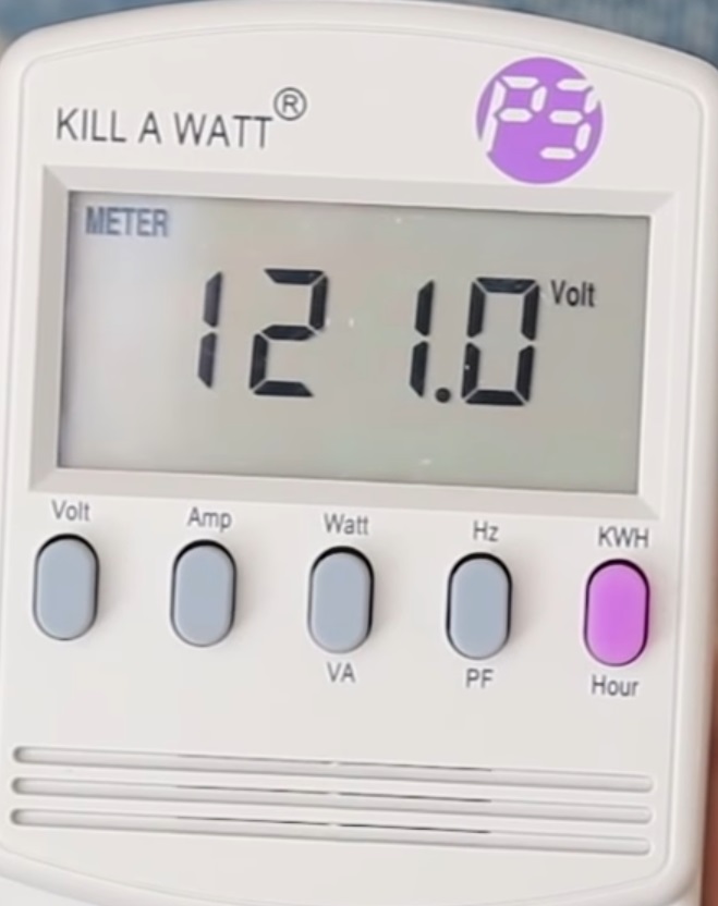

@jack7 Would love to see a Picture of your Kill-A-Watt meter or know a Model number.. Mine only shows 120v or what ever AC Voltage it is plugged into I have not seen one that works showing 12vDC.. For testing out my Voltage and Amps I have to use a made up Volt Amp Meter that I have that I can connect to my DC Power supply using normal 2.1 jacks. I would love to find a Kill-A-Watt meter that will show me your data without having to go into so much trouble connecting up different devices..

Revo2Maxx,
I have an IP4M-1026, full IR on, 6W max per tech specs, and
AC power supply adapter with Input:100-240V AC, .6A, and Output: 12V, 2A. AC adapter is plugged in a Kill A Watt model p4400 that displays the following:
V 122
A  .11
W 6
VA 12
HZ 60
You know way more than I do about electrical specs.  Would you please explain what what's wrong with the above Kill A Watt output values, or what the actual AC watt requirement may be in this example.  6W, 12-13W?
Re: Battery Backup Sizing
To be honest it is really hard to say here is why... Right now looking at what my KAW is powering and testing and while it does change little bit over time they are not with numbers like yours..
Your showing 122V this is your AC Voltage and then it says it is running .11 amps.. So should have come up with 13.42va give or take so it might have been that after pressing the button the draw was reduced from what it should have been showing of the 13.42va then W and VA is or should be close to the same.. So right now as I said where I have mine setup I am using 428watts of power on the meter and when I pressed the button it jumped up to 441va however after about a second it shows again 428va and that is because the Watts is the same as VA and is why it is at the same button spot..
SO P=V x I = W and for you normal 12v 2amp that would look like this, 12v x 2amps = 24watts however this is Max numbers and with your KAW meter there is nothing it can really tell you outside of what that power supply is using on the 122vac side..
Please note most of these power supplies that would power the cameras or the Recorder are going to be nothing from AC mains to the DC output and if you were to look at the bottom of a good Built power supply there will be or SHOULD be a good High to Low Isolation gap with a Class Y1 Capacitor between the primary and secondary windings of the Transformer and in some of the not so good built supplies they don't use them and not really safe for my standards anyway..
So I don't have the Manual for my KAW meter anymore and it has been a while since I seen it.. However I am going to guess that the manual might have that info in it as well to what W and VA is.. W=Watts and VA is Volt Amps and Watts is the real power and VA is the apparent power and 1W is = to 1VA..
And the 60hz is the American Duty Cycle that means it is on 60 % of the time and off 40% of the time
