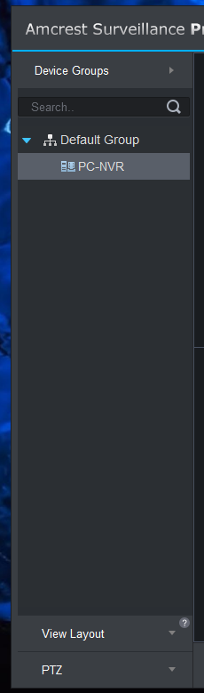

The older version of ASP worked fine for me. I performed a reinstall of windows 10 and installed the new version of ASP and cameras do not show up. These cameras are wired directly to the NVR. Please help. Thanks.
- Capture.PNG (33.75 KiB) Viewed 3127 times

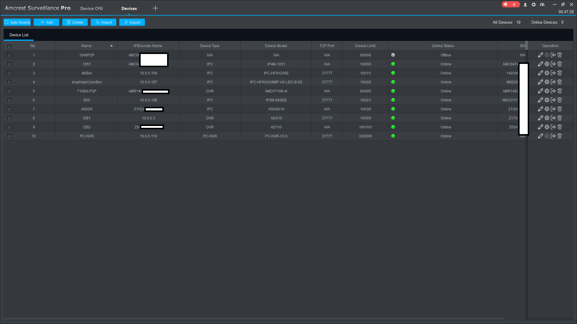

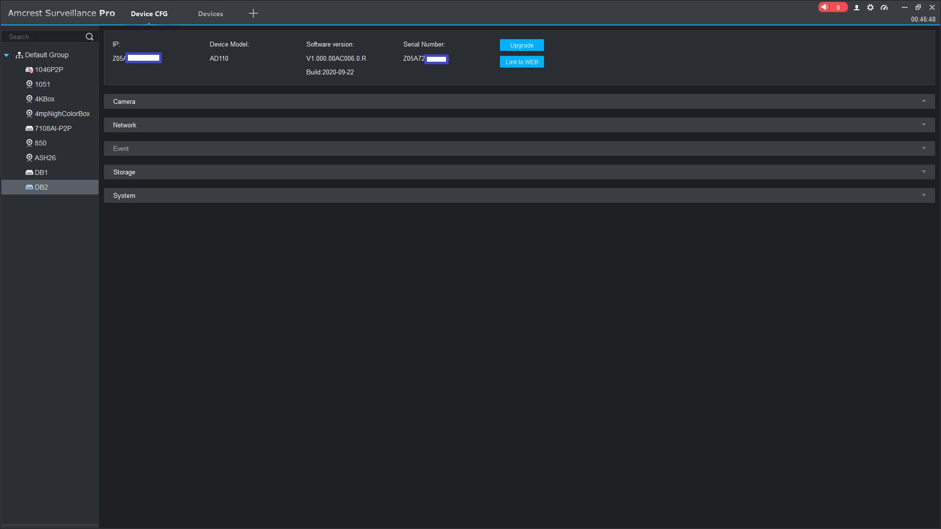

The area your in is Device Config and that is the Area after you find the Devices on the Device page. Here you can see my 2 captures of the current role of my ASP not all my systems but the one I have on this computer.. Other computers run other ASP and other systems.. But give you an idea of the 2 areas.. first one is like your and is where you would make Config changes to each device the second image is the one where you would find the devices on your computer.. By the way when I do a Search on my computer only one that comes up since the NEW ASP has come out is my ASH21 when doing a search so you might have same issue and doing so just means you will need to have the SN like looking at mine some are on IP and some are on Serial Numbers for P2P access... Either way they had to be Hard Entered..
Re: ASP does not show cameras
Yes, thank you for your help! I added a new device and used the P2P setup and worked first try! Thanks again!
