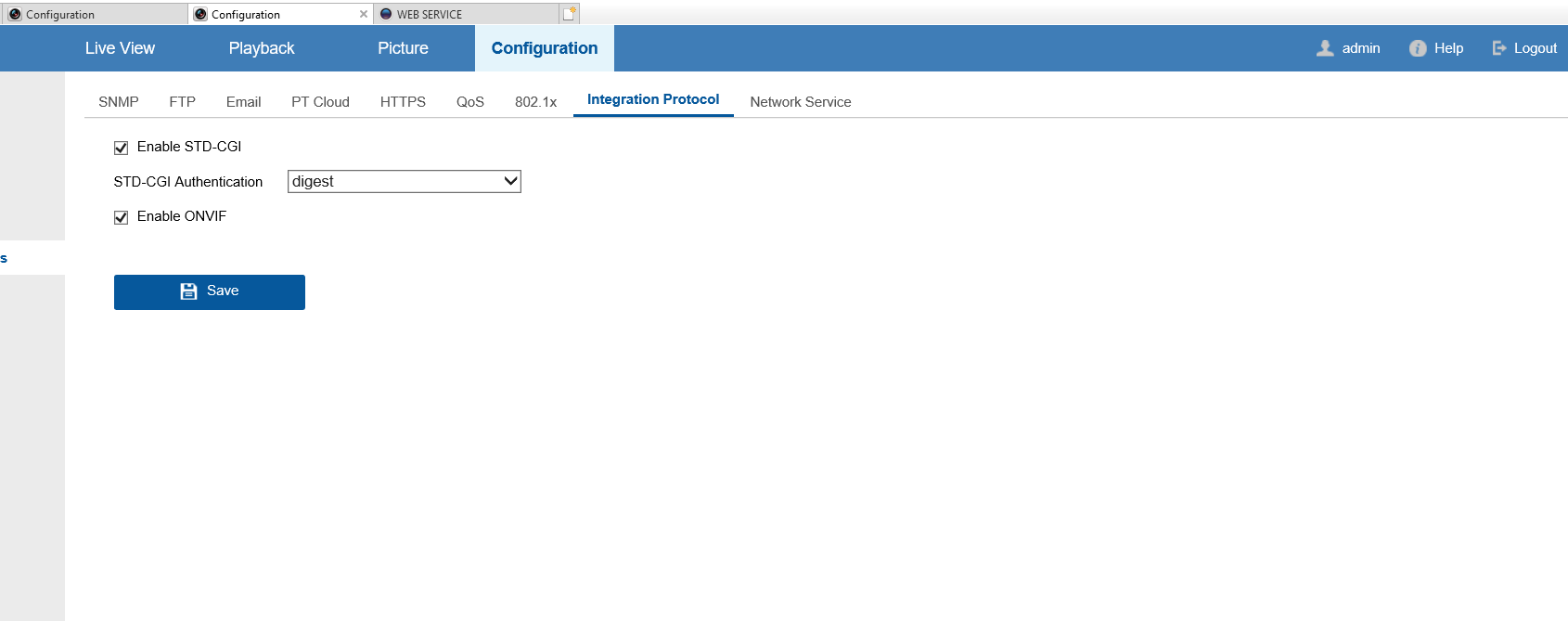

Re: ANNKE Cameras
IN your WebUI it would look something like this
Screenshot (844).png (27.48 KiB) Viewed 7101 times
