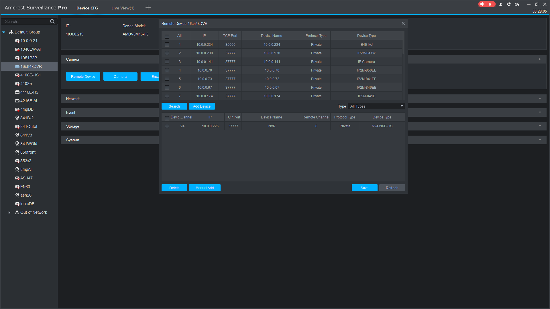

Also something that not all machines can do that the Amcrest can. In the picture below you can see from my ASP I have just removed all my channels on my DVR and pulled in my 16th channel from my 4216E-AI NVR that happens to be a Amcrest 853EW PTZ camera.. Some machines can only pick up IP from 1 channel of a recorder or IP camears.. I don't know how many IP yours unlocks but not only can the 16ch unlock to 24 ch AKA 8IP channels, You can also turn off other normal channels to make them a total IP only recorder. So I have other cameras normally on my DVR but turned them all off for this to show an IP channel even on ch5 if you look at the picture you will see it says in Ch5 and is from ch16 of my NVR.. This makes it so I can even access the PTZ controls of the camera. SO there are many reasons I like the Amcrest DVR's that I own over the others that I have. I mean I do have some 5mp DVR's that only give 2 ip channels but again they are AI and doing so you no longer have Ai function so why would you..

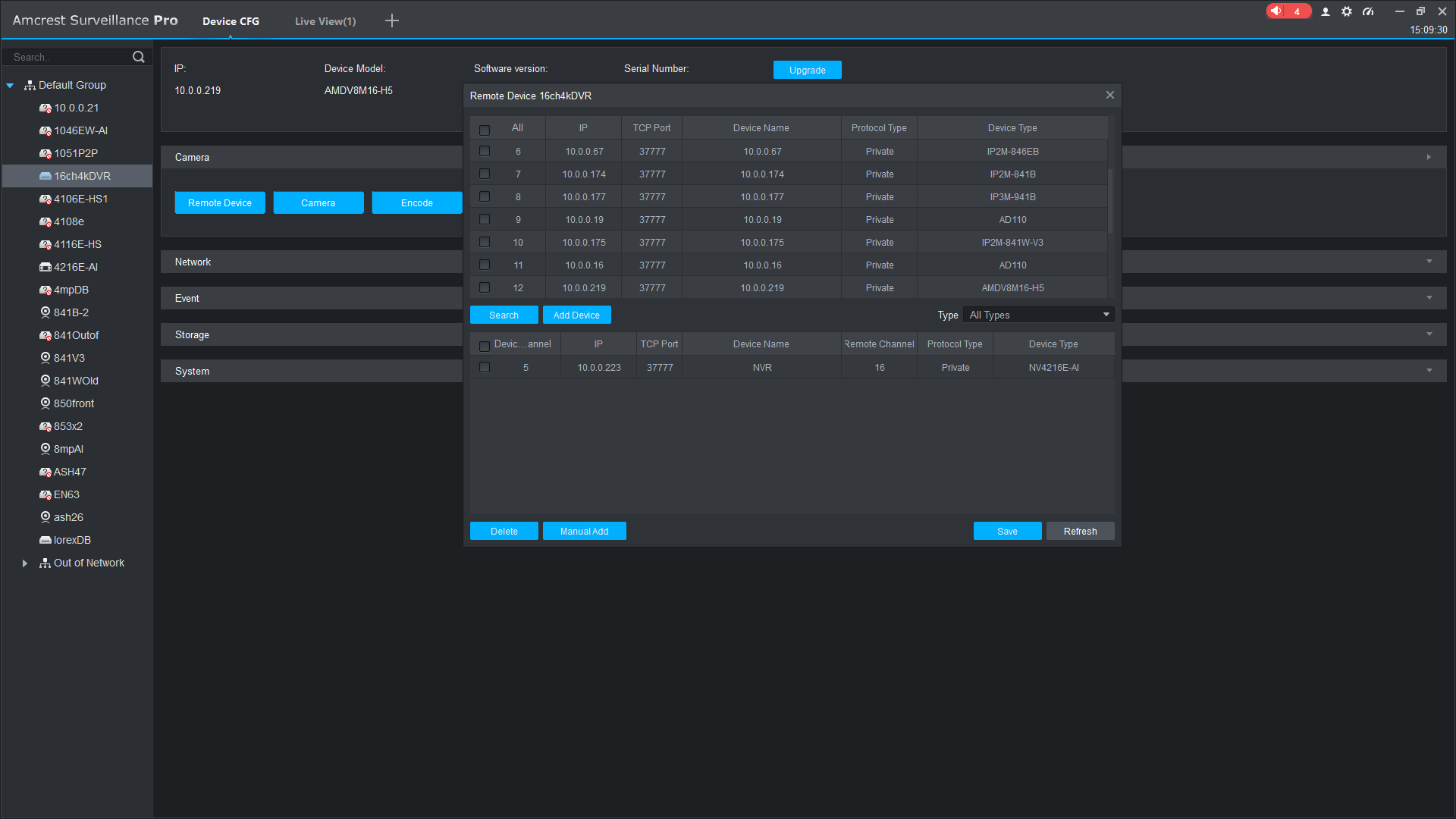

So on my 8m16-H5 and other DVR's that I have from Amcrest and or Dahua with IP camera channels anyway lol. To change on my system and I am going to guess it is going to be the same for yours as well. Looking at the GUI, Main Menu, Camera, Camera Type, when you enable 17-24 and I am going to guess maybe they offered 8ch 4 IP channels I am not sure I didn't' look up the model. So that would be as you said 12 channels. Anyway on mine, I disable CH16 and I can make it IP, Once I do that all other channels 15-1 will give the Check box to open the Channel type to IP when you do this the channel BNC in the back will no longer function for any mode. So if I only enable the 17-24 it will not open then options until I disable the 16th channel and enable it as an IP.. Then in that Camera type area it will let you change any of the Analogs your not using and make them IP channels.
So lets say you wanted to make your system 4 ch 5mp or other, I say 5mp because that is ones I have the most of on my Analog DVR channels. Then you could make the other 7ch into ip channels.. So for mine, I normally don't turn on the IP channels because I have NVR's. I did move my 853 onto my 4116E-HS 8th port and so I turned on my DVR's Ip channels from 17-24 and added the 853EW camera into my cameras 24th channel. From the GUI you can click the + button in the grid view and add your IP cameras starting at the last channel. If you do it from the Camera area in the DVR it will load it the next open IP channel.
Edit: Some of my older DVR's only have 2 channel IP if I give up 2ch BNC. Then I have some Hikvision DVR's that have 8ch DVR with 2 IP and a 16ch DVR with 2 IP without giving up. The 8ch is newer and I can do the Disable BNC on that one too for a total of 10IP channels if I wanted.
They are good for a Transition recorder if someone was looking to change the BNC over to IP they could use the DVR and one at a time change over to IP and by the time they have all the channels they wanted in IP buy a NVR
