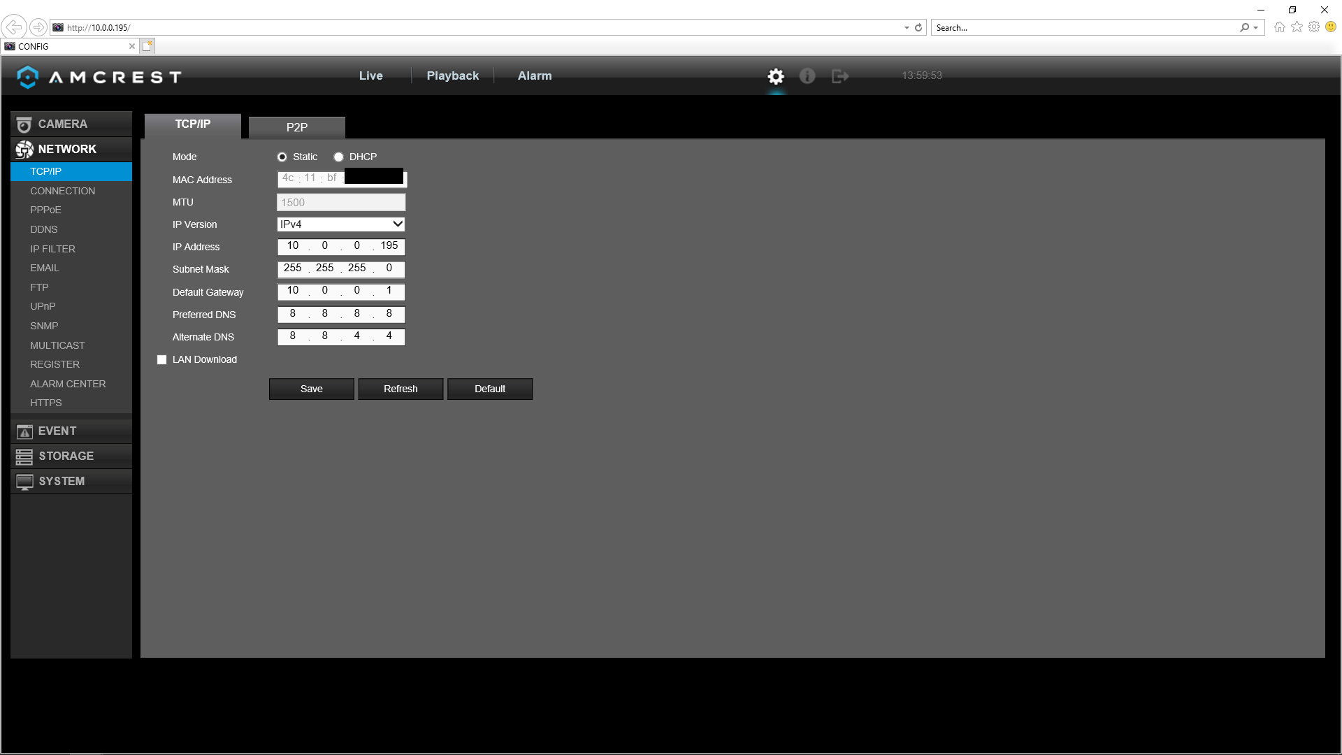

So to start with I would try this.. Change your DVR from Static to DHCP. Then Reboot the DVR. The DVR should be given a IP and gateway from your router. Then make sure if your in the USA to setup your DNS to be pointing to 8.8.8.8 and 8.8.4.4.
For an IDEA of what it should look like this is what my network looks like for my 7204.
10.0.0.221 DVR IP
255.255.255.0 Subnet Mask
10.0.0.1 Default Gateway
8.8.8.8 DNS
8.8.4.4 DNS2
So make sure that what ever your IP for your Device is that your gateway is your routers IP and that you have good DNS.
10.0.0.221 DVR IP
8.8.8.8 DNS
8.8.4.4 DNS2

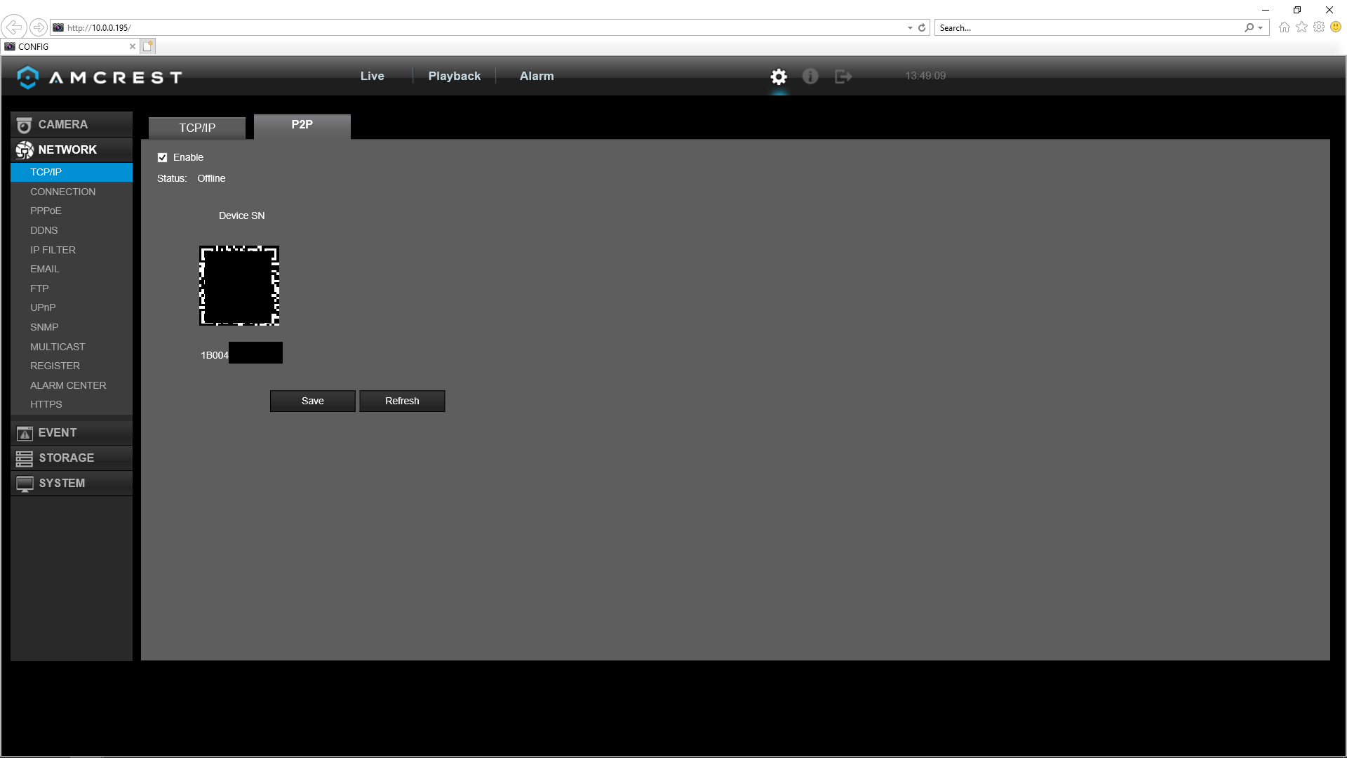

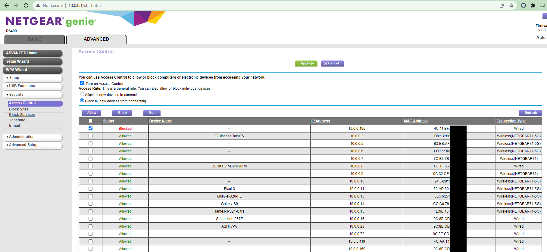

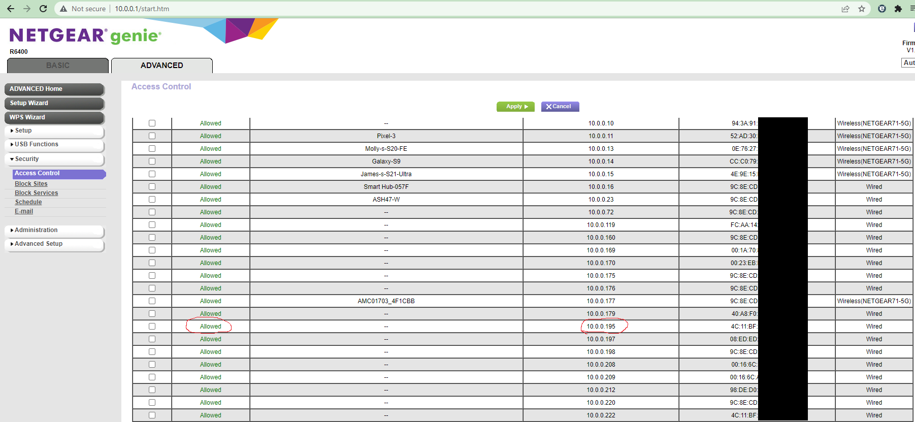

It is Really easy. So I wanted to show you how easy it is to go from offline to on line if your access is an issue with your Router. In the pictures below I have one that shows my 7204 P2P with offline message and show my router with that IP being blocked. Then I grant it access and show that the P2P is now online and the pictures follows with that IP moved into area with access.. 5 screenshots the 5th what I have my network setup as. Please note this is just so you can see what I was saying with IP and Gateway are in the same range as I stated above IP was wrong the one I first listed was one of my NVR's
Also it might be an issue with iOS right now. I am not 100% sure that iOS is working 100% looking at the pictures below if you look in your DVR's menu where I show the P2P is under Network, and it says it is online and your not able to access then there is an issue with the phone not the DVR...
