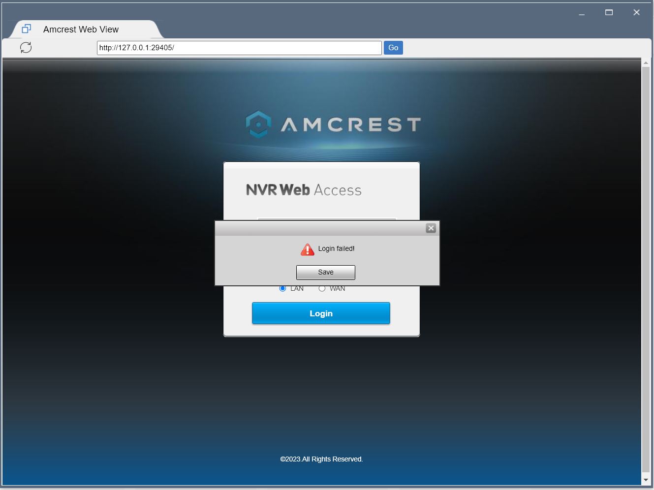

I'm getting closer but I have never used these Chrome extensions.
This one is with Amcrest Web View.
amcrest web view login failed.JPG (85.54 KiB) Viewed 3062 times

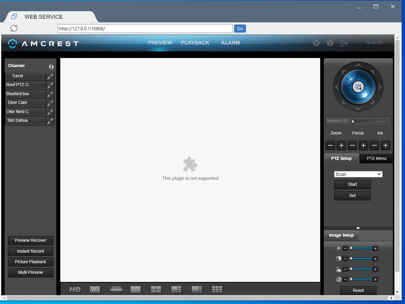

This one is with I think Easy View (WEB SERVICE). The error message doesn't sound good.
nvr web ui chrome.JPG (110.57 KiB) Viewed 3062 times

To be honest, my 4108E-HS that is new old stock with the older FW on it. It works best in IE or Edge in IE Mode. In edge I have to add the IP address to the Edge area and I will have to play around with one from Local IP with a port to see if it can work over the IE Mode I have not tried. I rarely access the WebUI of my Remote DVR/NVR's as I don't normally think about using that option while in ASP.. If truth be told I think you are the one that told me about WebUI from with in ASP..
Your my Guide to ASP :)
Re: Amcrest NVR P2P remote access with NVR Web UI
Yeah doing little more looking with my 4108E-HS with older FW like yours above it seems like there is some issue that you were talking about when I try to access the NVR over Edge with Port and IP of local host added. I can get to log in screen and put in the known good password and it says it is wrong..
So I tried my 4216E-AI NVR that has the 2020 FW from when it was released and first time I tried to load it in IE I was able to log in however it just shown a blank screen. I hit the Refresh and it came back to log in I logged in again and I was able to get access this time. IF I had to guess there might be some extra port settings that are needed in the older FW to gain access that isn't tossing out. LIke my 4216 shows this for the output when I click on the tab in ASP.. http://127.0.0.1:27371/?rtspport=27375&tcpport=27367 Where my older FW NVR only comes up with the IP and Port number like I am accessing one of my Remote Cameras. They do work on older Remote cameras that I use that function for at times..
My guess is it's a Limit on older FW NVR's..
Edit: Also looks like the access it limited to the NVR anyway. I can't seem to access the cameras when I get to live view, I click on a camera it says to Log in First. So Really not much of an option for Remote access. Maybe good for making some changes to the NVR setup outside of that not very helpful.
