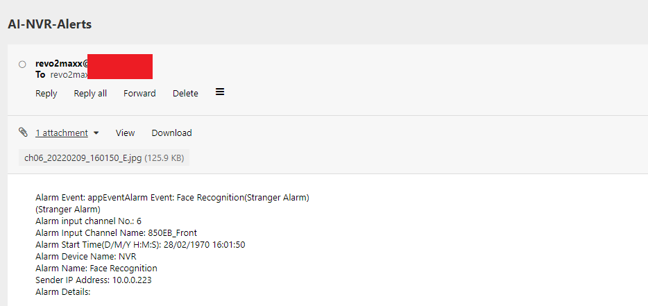

Hello all, So I am trying to find out if it is just me or if this is common within the 42xx - AI line of NVR's I am not sure that it i will be an issue for the 41xx-A2 lines of NVR's My AI DVR dont' have the issue..
So here is the issue. Setting up your email to send on alerts. When you get an alert does the date show something way crazy from 1970?
Please note, Just adding the email info and sending the test will give a email with the right date. It has to be an email sent from an event. See I thought it was maybe an issue between my AD410 and my AI NVR however it sends it on all alerts large and small. Motion, Alarm in, IVS, Face Detection and all I have tested and all end up with a 1970 year..
Yes I have reset the device and setup the device by scratch each time
Looking at the attachments the dates are right only date on the email it self is wrong.
I have other NVR's and DVR's this is only one that is doing this all others send emails with right time and date.. Here is one of the emails you can see the attachments time is right only date in email is wrong.
Screenshot (1881).png (25.55 KiB) Viewed 553 times

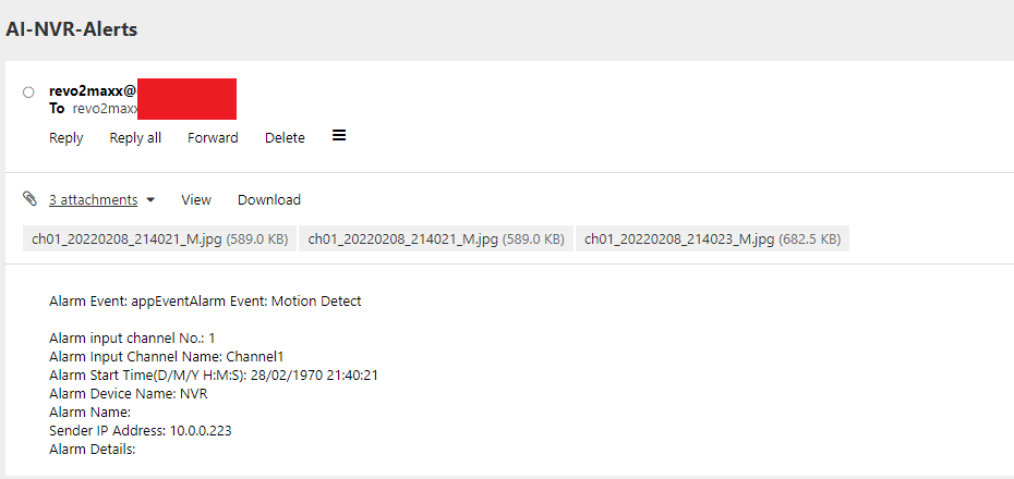

Also I thought maybe I should say there is no date change either Here is a Picture from yesterdays email with also showing attachments that show the right date.
Screenshot (1885).png (25.72 KiB) Viewed 552 times
