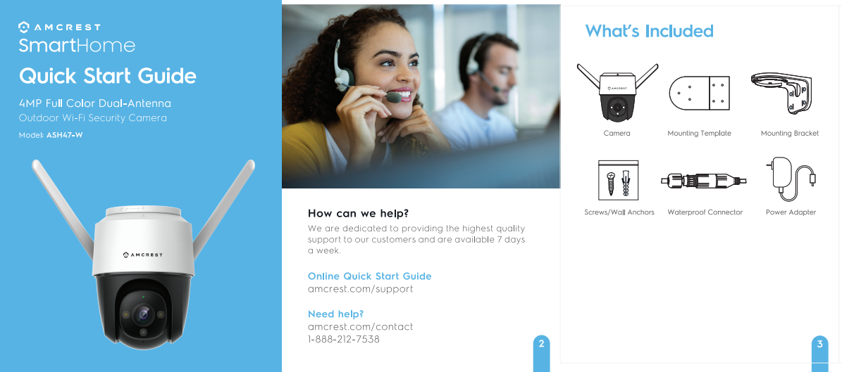

BTW, the specs on the ASH47-W indicate I need a power source, but that does not seem to be included in the package. Is that accurate? I mean, I have plenty of such power supply adapters lying around, but odd if the BoM does not include a power supply...

4108-HS is 4k, 4108h is 4mp. 4208 is AI enabled or like 42xx again xx is channel number. Then there is also a 41xx-a2 that is Semi AI with SMD. Personally I have not heard of anyone that owns one yet only pages for FW and manuals.
About the 47 it has power supply here is picture of QSG showing what it comes with..
