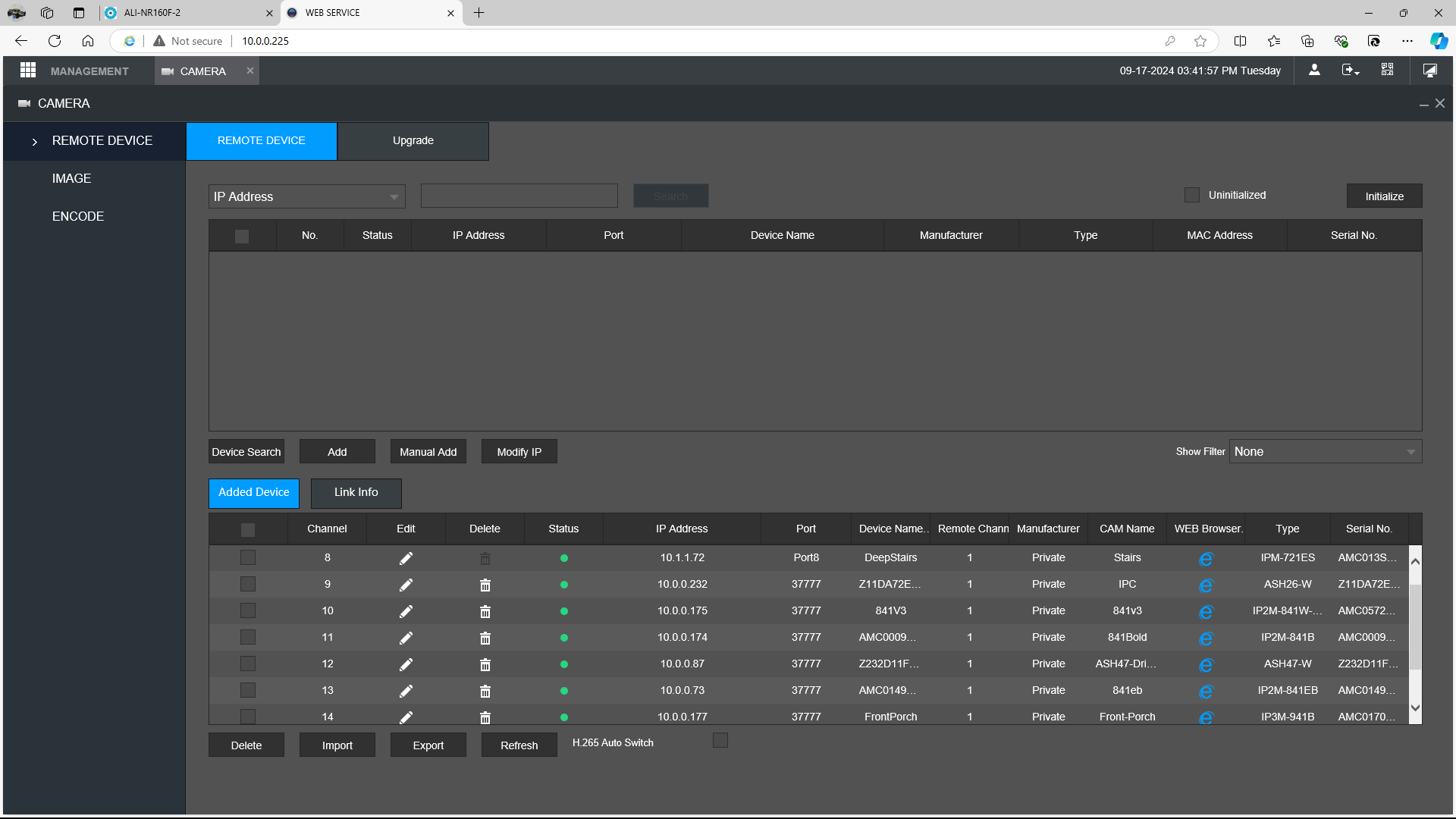

Yes Ethernet port of NVR connects to Switch/Router/Hub and the other 16 cameras connect to same area. Then the router gives out IP addresses to your NVR and the cameras on the same range So as you can see in the picture below on my 4116E-HS NVR that has 8 ports POE and total 16ch. Ch8 is connected as POE in the picture and the rest are connected over my local network. Some are mix of Wifi and POE cameras alike. I do have a couple of POE Switches and normal switch along with multi router setup in my network. On port 8 the camera has 10.1.1.72 and in the 9 up is 10.0.0.xx on. Your system should be setup like that as well.
if you go to the NVRs network page and look under TCP/IP area it should show what IP address it is using. If it is not working correctly can you connect to the IP address and bring up the WebUI of the NVR? If you can not and it has a IP on the same range then it could be that the NVR is damaged. I have a 2108E-HS that was working and one day all my network side cameras went offline and only my POE cameras were still connected. When trying to access WebUI it failed to access the NVR. I have since repaired the NVR but it can fail. In my case it was the Ethernet Voltage Regulator.
You can right click image and open in new tab to see full size
