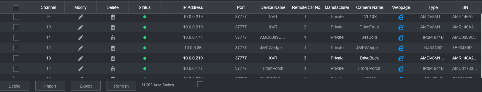

So a couple of things. The NV4116E-HS is a 8 Port POE NVR, So if you have 5 connected right now to the POE ports then you are going to be limited to only being able to connect 3 more to the NVR on the Port system. With that said keep in mind also that the ports work in a group of 4 so if you lets say happen to have 5 cameras on your NVR right now and only 3 are POE if you were to connect your new setup to port 4 then you would be limited to 1ch. This also means that if you were to connect to your NVR on port 5 because it was easy to get to setting up on port 4 of the NVR wouldn't work either. Meaning making a connection to port 5 and adding in your cameras starting on port 4 it won't load into that port.
Now to make this all the more complex there is some POE NVR's that I found this wasn't the case. Connecting any port could make all connections however this was on like first release of the 4116E-HS model. The one I own now I can't access anything outside of groups of 4, 1-4 and 5-8.
Also keep in mind that you will want to setup your cameras on a different lan range and keep your normal network of items off that setup. Because when you have your NVR connected to your main network like using it as a pass around for access to the cameras connected. The Switch will try to hand out IP to other cameras if you have them and or other things that might be connected with DHCP enabled
Now to be honest what would be the best thing to do in this case? Buy another NVR and connect the cameras to the NVR in the Garage, Then connect your cameras from your NVR to the 4116E-HS over your normal network. When you make this connection you would be adding your cameras on channels using your Garage NVR's IP address with channel number. So on your 4116E-HS it would have multi cameras connected with same IP. Like if you were using a DVR
Like in my case I have cameras connected to one of my NVRs on a IP connected at 10.0.0.220 so in my NVR I have 4 channels showing this IP however there are different cameras in view. In my 4116E-HS NVR you can see 3 of 4 cameras connected to that with my XVR on 10.0.0.219 IP with channel number being different. Normally on your NVR it will show Ch1 as the connected channels for your cameras out of this because of the size of window offered you can see 3 of the 4 connected and you can see the line shows IP same and SN is same only different is connected channel and that is how you really should connect a off site camera. This way if your 1 link to your NVR gets damaged or has network issues your cameras were being recorded on your Garage NVR as a back up source.
Screenshot (658).png (42.27 KiB) Viewed 5149 times
