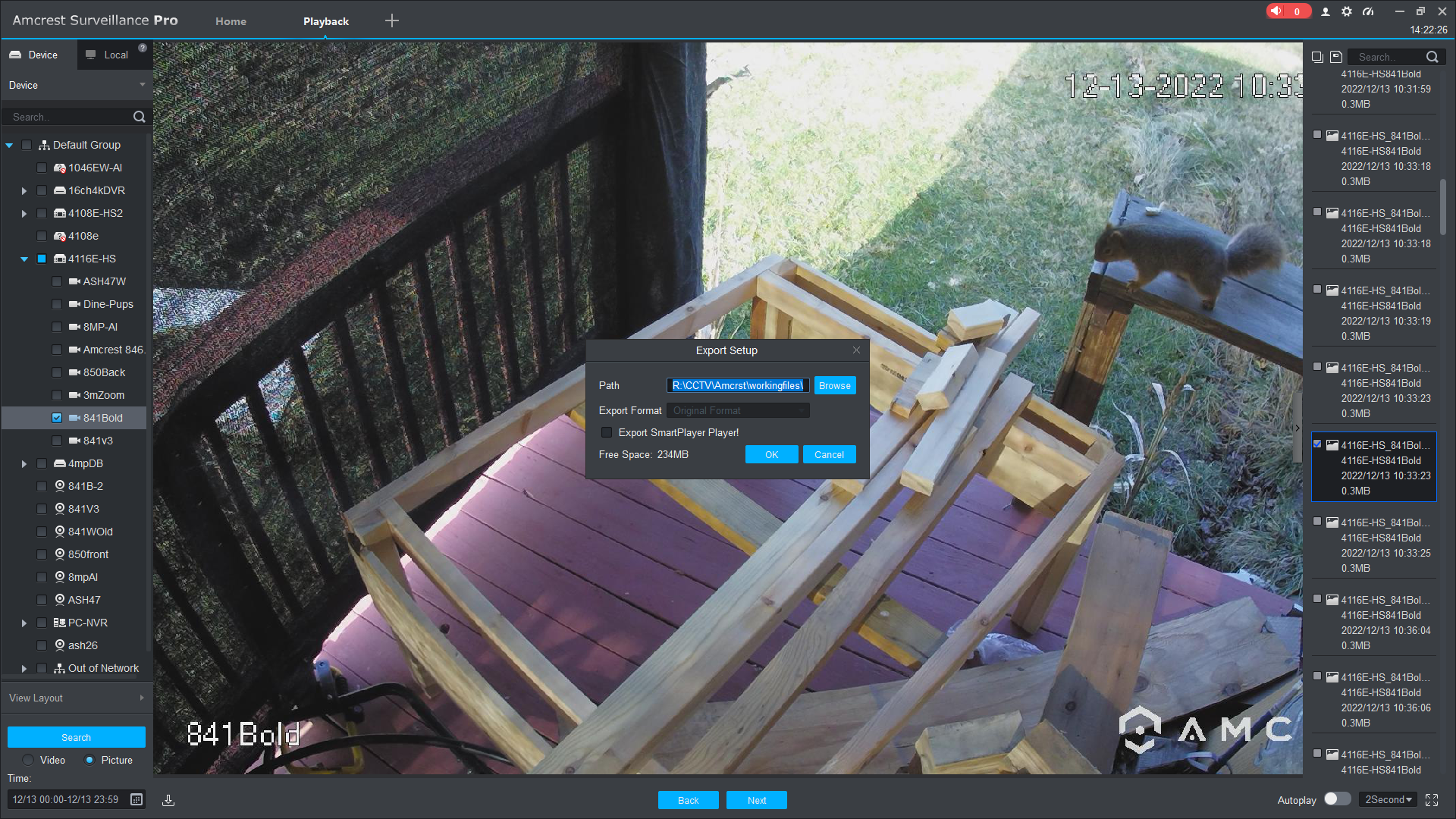

However with AVP bring up Playback, Then choose the Picture under the Search button, Then choose what you want to search pictures from. Then you can put in the date or if today is fine it will search the whole day after pressing search. You can then access on the right to find the right time for the event or if you didn't know the time you can just hit the next at the center bottom to scroll though the list. If you don't see a list on the right it might be hidden behind a drop back arrow just click the arrow to bring out the list. It would look like picture. Just click the Diskette looking icon at the top and choose the location you want it saved in

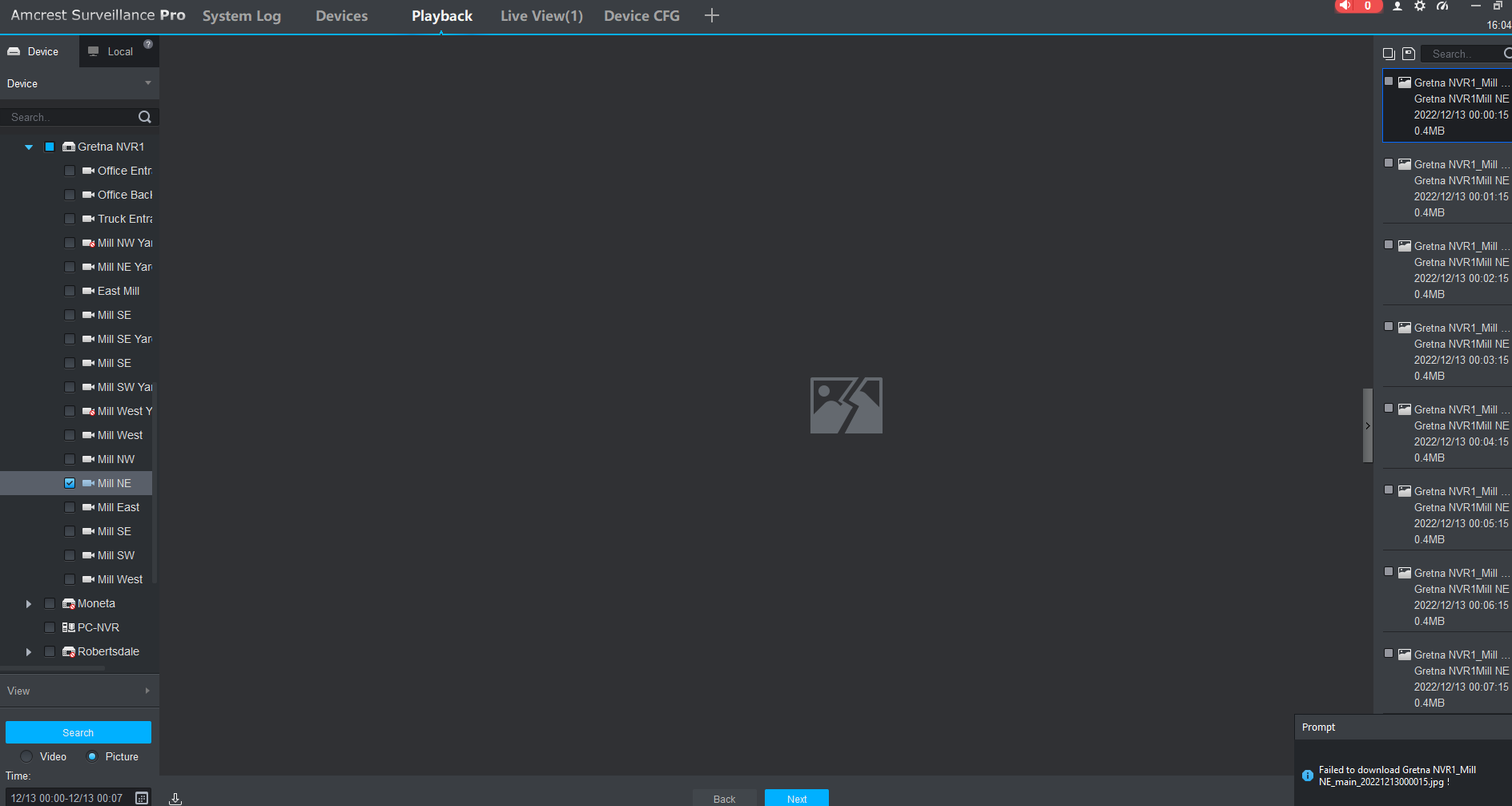

The issue is I'm not getting those options, it's crashing at the initial data pull. Ran firmware again, no go, going to try another one support just sent me. Will update.
- snapshot error.PNG (80.28 KiB) Viewed 1419 times

Yeah I don't know. If it won't even display. You might have a Network connection issue. I have done a good amount of testing on many different devices from DVR/NVR's to cameras and even thought maybe it was an issue being over P2P however I am able to DL footage form remote devices on ASP over p2P so I am not sure what.
Not being able to even display it wonder if you checked it on ASP, and hit the Disk looking icon up next to the Search box if it would put on local HDD and you could view it that way.
However seeing it shows broke image not sure maybe the NVR isn't able to make a good image?
