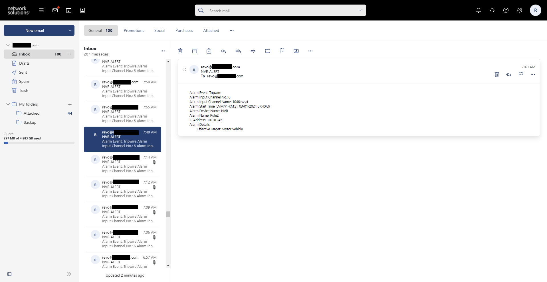

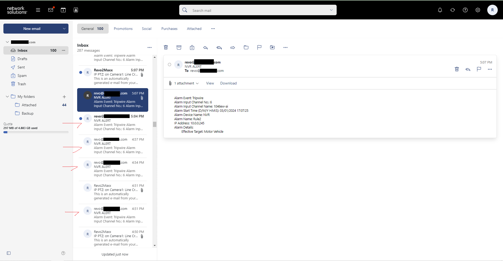

Ok I don't know what is going on. My new to me 4108-A2 seems to only Email at a set of hours that I didn't define. Anyone else have this issue? I have looked at every setting I can think of to why at 714am was my last Email I get with an image after that all my Emails came without a Jpg attached. Anyone else having this issue? I only am guessing that there is some type of schedule that I don't have control off where the Email will give a snap shot and that is because It picked back up sending images in the email at 507 the emails I got until then didn't have any images after 714am and that isn't any type of schedule that I can find in app, in NVR and I can get other images in alerts from cameras that I have setup in that time so it isn't some type of Rejection that my Email server is down by removing the images before giving me that email.
I have reset the NVR back to Factory and same results. Anyway anyone else having that same type issue with their A2 NVR??
Thank you
James

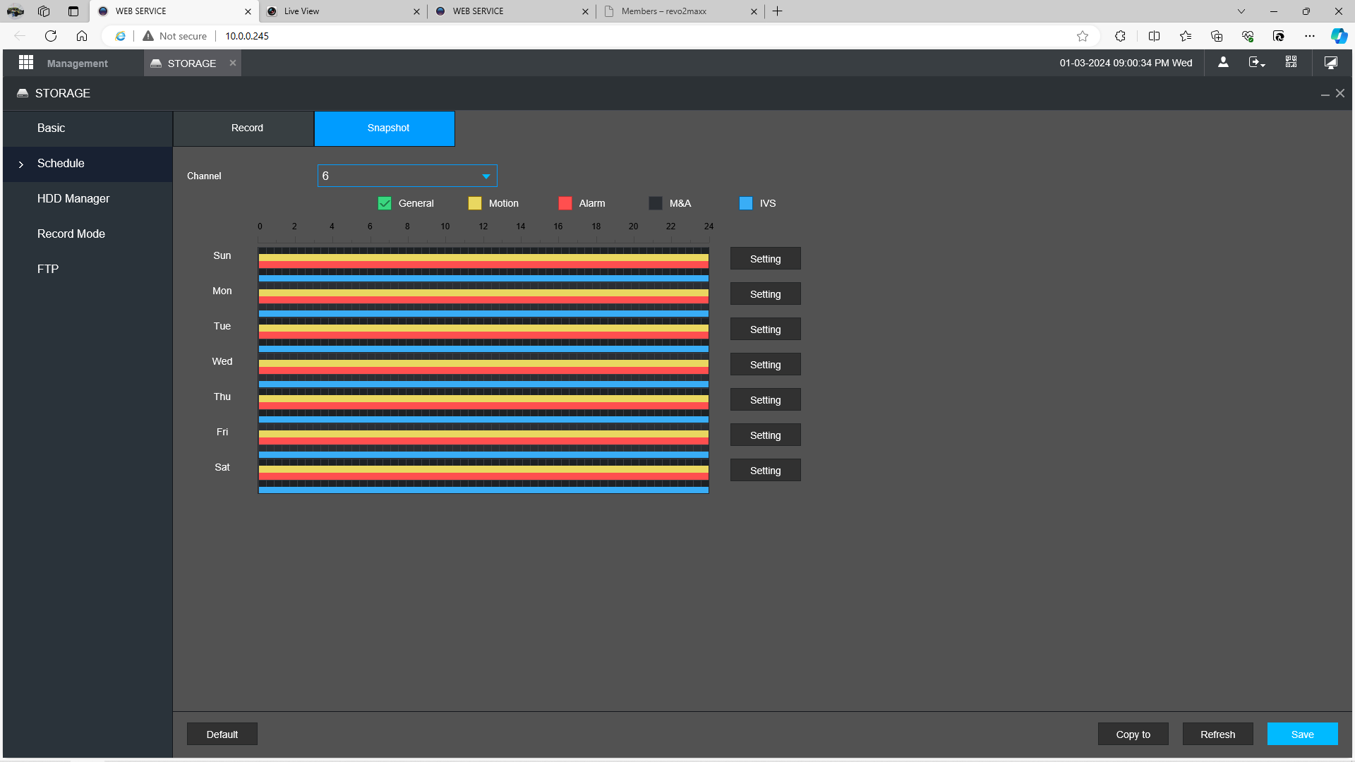

As I have said I have looked everywhere I could think to look on the Snapshots and here is the Schedule that I setup from ch1 and copied to all other at first setup as well..
