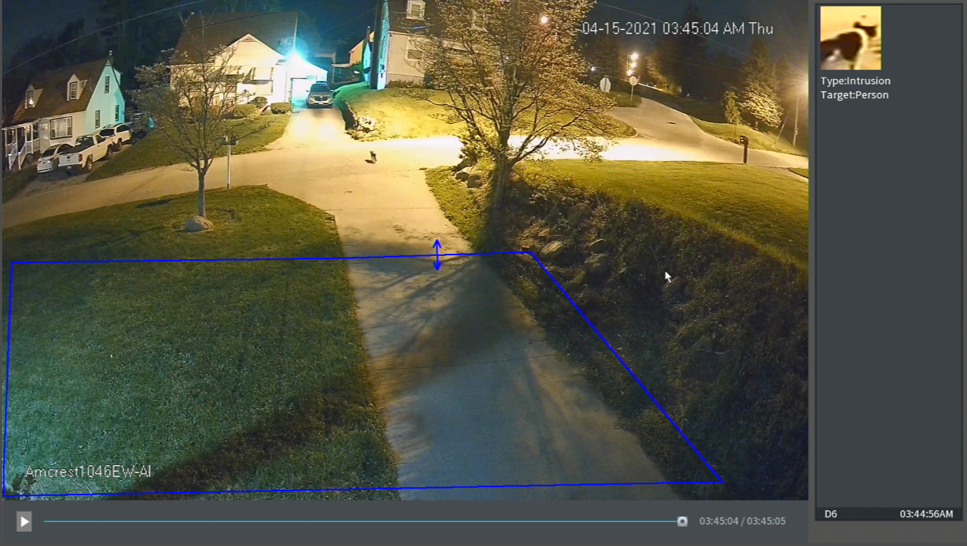

So I thought ok. Lets see what happens if I put it back where Default is on the NVR and while the Vehicle and person detection has been working perfectly even on the very edge of my Rule after putting the settings back to default last night I did get a Cat that is said to be a Person...Oddly enough I am not sure how or why lol.. I will leave the Default settings for the rest of the day and see if any other false readings happen.. Good news is that a bag blowing by didn't get detected even though it was better size of a persons face..

The picture of the cat in the road is not where it triggered just where the image ended in playback it trigged at the center of the image..
