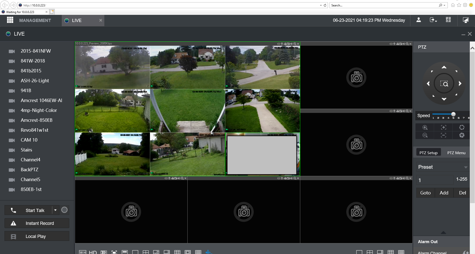

When working in the 4216E-AI and my 7108-AI Recorders there is kind of a cool option when working inside a large Recorder and want to see more channels when working in the WebUI of the Recorder.. When you log in to the Recorders WebUI and then click on the Live View you can bring up say for this a 6ch camera view as a main window. Now lets say I want to View my Recorders 9ch View like I have on my NVR or NVR's GUI, on the right bottom area is some more window options I click on the 9ch view and it now loads that view in my WebUI (Picture Below)
Why this matters? Well now that I have clicked this 9ch view (Lets say I gave access to Visiting friend) that was a Bad person in mind. While in this view the person can see my screen and everything that I do on my Recorders GUI over the computer WebUI connection.. This means if your looking at a channel maybe not intended for them to view or adding a camera or just inputting the password for a camera not loaded yet or intended for them to use your mouse action is able to be seen as if it was you running the mouse yourself.. The thing is once you make this connection all actions on the Recorders GUI is in that window you have setup on your view on the WebUI..
This picture below is a 6ch view on my 4216e-AI, the 9ch in the Main ch area is from clicking the 9ch on the bottom right of the WebUI once done all actions can be viewed Even if you were going to change the password to the admin account you have them on so they can't access it anymore they will be seeing the change as you make it...
