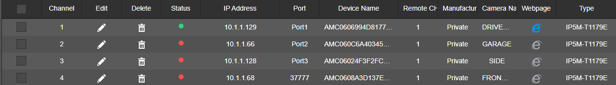

During the past week 3 of 4 cameras have just go offline. One is working normally.
Things I have tried:
- Rebooting NVR
- Resetting each camera
- Accessing camera directly through browser
- Removing cameras (NVR immediately finds them again and adds them back)
- Tested Network connection which is wired through COAX and gets about 90/90 MB up and down.
Looking for troubleshooting suggestions at this point. All cameras are wired POE into the NVR. Bought in a kit with the NVR and 4 cameras. Been installed for about 60 days with no issues until now.

Just a guess, in the screen your picture is from click the pencil of the first camera that isn't working and change password to the current password of the camera. It could be that the Nvr is locked out so reboot NVR after change. If the second one comes on line reset passwords for other 2 and reboot nvr again to clear them being blocked
Re: 3 out 4 Cameras Not Working
Also looking at your picture if your 4th camera is connected to port 4 might want to remove and reboot and connect again as that should be port4 not 37777

Revo2Maxx wrote: ↑Sun Oct 30, 2022 7:42 pm Also looking at your picture if your 4th camera is connected to port 4 might want to remove and reboot and connect again as that should be port4 not 37777
When you click edit on any of these cameras the port shows as 37777, not sure why the listing is showing Port# instead in the list.

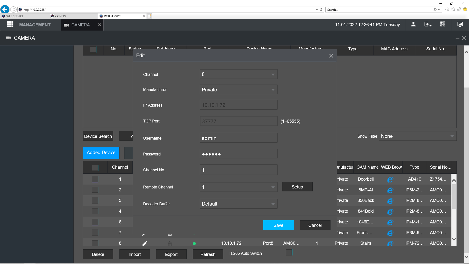

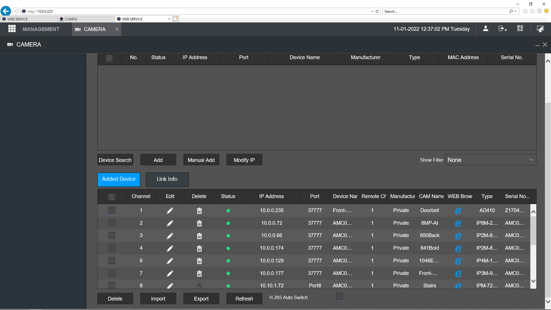

So I was going to post this earlier however had a call and got me off track and just submitted what I had.. Anyway looking at the 2 pictures below you can see in the first one that it is showing my Port8 camera and that one in the Pencil area there as you said 37777 and in the second picture you can see that all of the ones listed with the Port 37777 is on a different IP range where my POE camera connected to POE port8 is on a 10.10.1.xxx range..
So if your trying to connect your 10.1.1.xxx range camera from the front side of your NVR then they will not get pulled though, You will need to make sure that the Range of your normal network and IP for your NVR like in my case is 10.0.0.xxx. The only NVR that I own that can do a back IP pull from the front is my 4216E-AI NVR. Even then they don't stay on that IP range for a long time. However I can pull 10.1.1.xxx and 10.0.0.xxx from my normal network side of the NVR..
Also if your trying a pass around and trying to pull in cameras from front side using a cable to the back from your normal network not all NVR like to work in that mode and if that is what your trying to do cable to camera to POE of the NVR is best method.

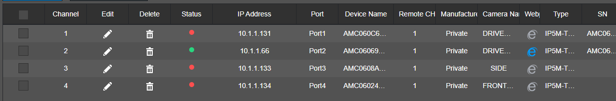

I tried changing all the ports, swapped 1 and 2 & 3 and 4 so they were all on new channels.
Now all the cameras show Port# but you can see only one is working. I suppose this is some progress as it rules out the channels being bad.
Other than unplugging and plugging back in how are the POE (IP5M-T1179E) cameras reset?
I am not 100 % sure about that camera but I think it has a hatch you can open where a slot is for Micro SD card and in that hatch will be a small reset button. To reset that camera you will need to hold button upto 45 seconds
