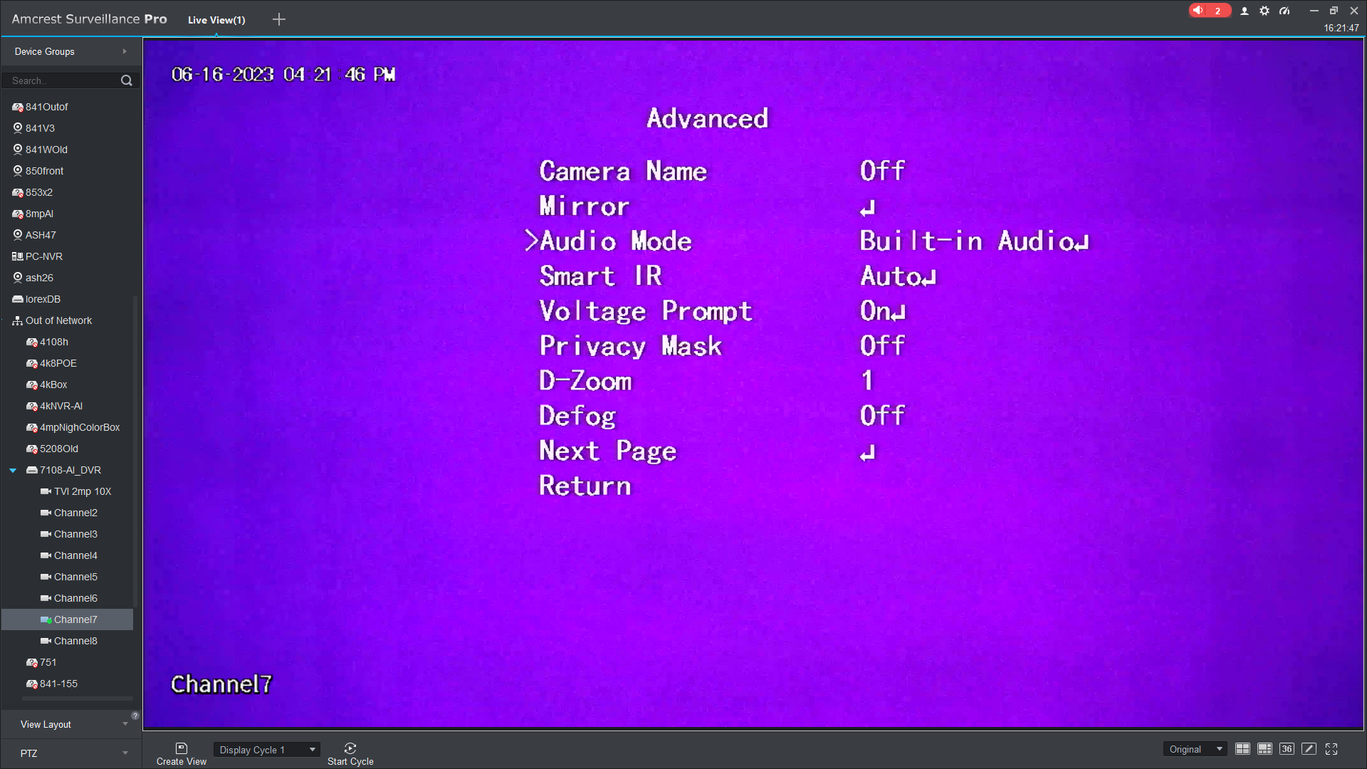

Also the camera has a OSD so keep in mind 2 things. First CVI is only format that the camera will work in audio. That isn't something that is stated anywhere I can find. However that is something I found in my testing. If I setup for CVI I can get Audio. However if I setup in TVI, AHD or CVBS audio over coax don't work.. Second part is that the camera has under Advanced an area where you can choose AUdio input or Mic so that might be the issue..

Thanks for your help. I tried the CVI setting on the software and changed the switch on the camera to match and the audio works with no issues.

As a possible point of interest if you haven't already discovered it, the on screen menu of the camera as displayed above should be accessible through the general PTZ settings of the DVR by right clicking on the camera image while in live view mode.
